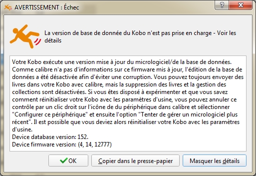

I try to modified books on my device via Calibre, but I've got a failure message (see the image in attached).
Here is the translation of the message (much easier) :
Your Kobo is running an updated version of the firmware/database. As template has no information about this updated firmware, the database edition has been disabled to avoid corruption. You can still send books in your Kobo with template, but book deletion and collection management are disabled. If you are willing to experiment and you know how to reset your Kobo with the factory settings, you can cancel this control by right-clicking on the device icon in the template and selecting "Configure this device" and then the option "Try managing a newer firmware". You may then need to reset your Kobo to factory settings.
Device database version: 152.
Device firmware version: (4, 14, 12777)
Translated with www.DeepL.com/Translator
I do not understand what it means.
Is it Calibre who don't manage the new firmware ? Or do I need to perform some actions on my device ?
I appreciate your help and support.
Thank you,
Haplo65

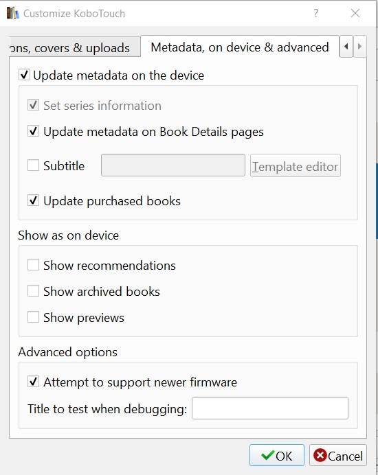

In calibre, open Preferences => change calibre behaviour => Plugins and type kobotouch in the search box. Select KoboTouch (or KoboTouchExtended if you are using it). Click on Customize plugin and on the 3rd tab, click the Attempt to support newer firmware checkbox.
Davidfor has already posted in the Kobo forum to the effect that there should no bad side effects by enabling this option.
The support for the new firmware version will be in the next calibre update.
