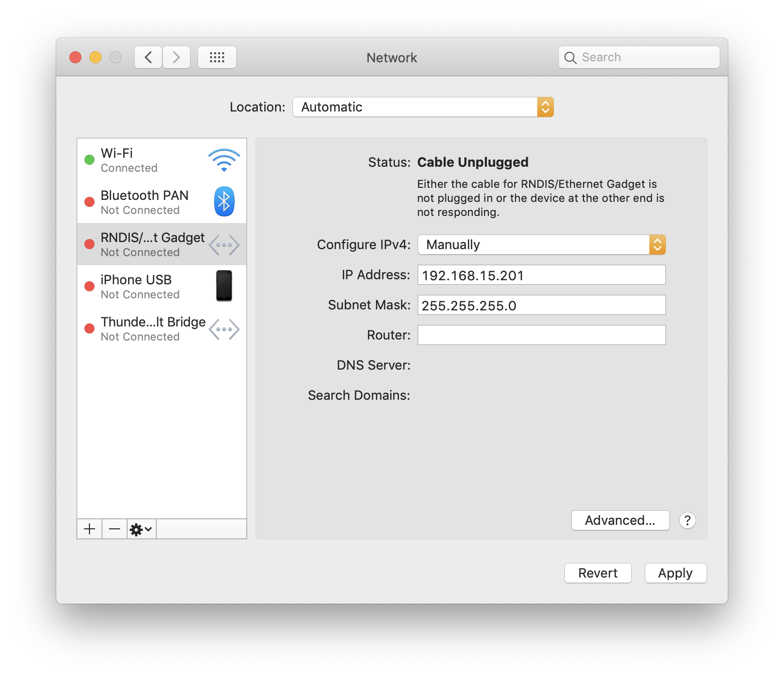

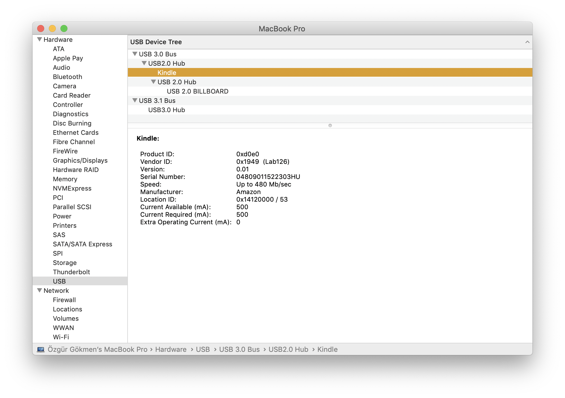

@Galunid and @NiLuJe, thank you both. That is how I set up the USBNetwork hack years ago. I began using SSH over WiFi, and don't remember using Ethernet over USB ever since. Humans are prone to forget, and I feel like an ignoramus.
I have just read once more the README files of RescuePack, CowardsRescuePack, and the README_FIRST file of the USBNetwork. According to the README file of the RescuePack, IP Address and Subnet Mask of the host are 192.168.15.201 and 255.255.255.0, and Kindle's IP Address is 192.168.15.244.
However, Ethernet over USB doesn't work with these settings. I have checked the System Information to confirm that the device is available under USB Device Tree.
AD: /usbnet/etc/config file has an SSHD ONLY option that prevents switching to Ethernet over USB.
# Don't switch to Ethernet over USB, and only launch SSHD
# NOTE: Make sure you're able to properly login over SSH before enabling this...
# It's obviously only useful with WiFi devices, so leave to false on non-WiFi devices
K3_WIFI_SSHD_ONLY="false"
If it is set to "true", will that disable Ethernet over USB in diags mode? (No clue whether I did that change.)

The main USBNet config has no impact on diags, no.
You *do* need to switch to USBNet the proper way by navigating the diags menu, though (What's described as N-U-Z-X in the RP README, although the exact menu IDs may have changed on recent devices, but the idea is still the same).

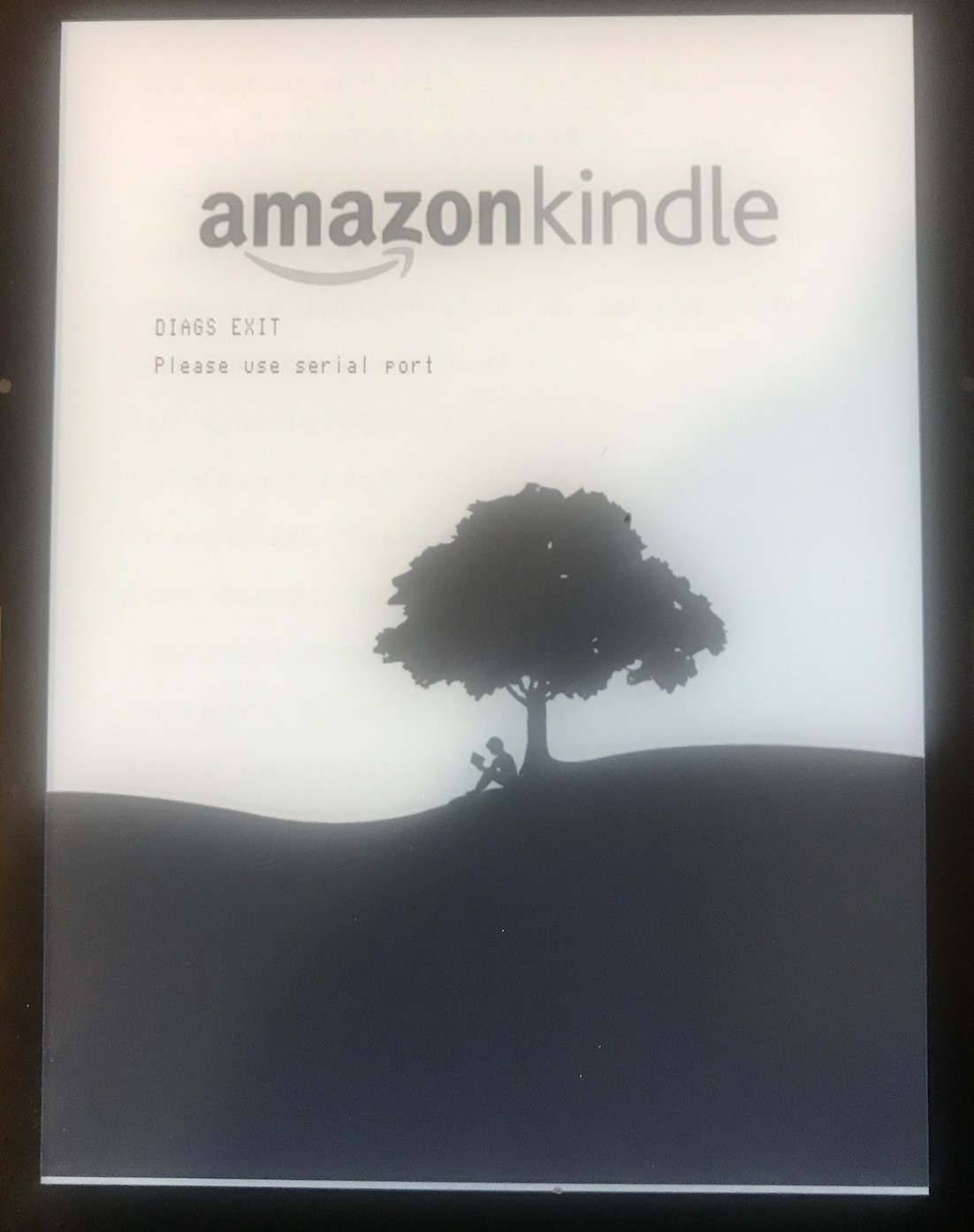

If it is in Diags Mode, then it will be showing a menu on the screen.
Please take a picture of what is on the screen (menu or something else) and attach to one of your posts.
Why?
Because the "Diags" firmware varies depending on the price of tea in China.
It does not seem to have anything to do with what "Main" firmware version is installed.
Note:
Some (all?) Diags firmware that includes the message you see ONLY puts the menu on the serial port, not the screen.
Some versions put it on both the screen and the serial port.
It was. Now it is not as I have tried to explain above.
Attached.
Why?
If I can read the shadow underneath the screen correctly, the top two lines of the diags menu read as follows:
ICE - WARIO - WFO - 512 - Utilities
-------1.16.613.255799------
Note:
I have used the diags menu on the screen a couple of times before.
Note2:
You may have to just follow the directions (that is: use the serial port).
I hope we can be able to produce an easier solution.

The FL seems to be on on that picture, is it, actually?
What happens when you try to hard reboot it?
Yes, it is.
It is in a loop. That is why I suspected that the device is in fastboot mode. Hard reboot makes the amber light blink five times. FL turns off and turns on again. The screen remains as is.

Diags Mode does not overlay the menu on top of the Boy Under a Tree image.
So use the serial port.
Follow the directions for using pins (no hot solder solution) since you will only need the serial port long enough to type a couple of commands.
