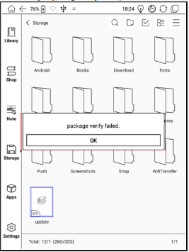

Question BOOX Nova : How to downgrade firmware from "2.1" to original "2.0.1" ?
Hello my friends ! I have a small question for you.
How to downgrade the Firmware V2.1 to V2.0.1?
* BOOX Onyx Nova Pro.
- I tested (out of curiosity, yes i know, it's stupid) the Chinese version (upgrade 2.1), but I do not like the new interface for the reader of NEO@3 books, many small settings are missing in the new version.
*In addition, it is full of bugs
- I was trying to download and install with the update.upx from the Onyx official page, it does not work. (with failed message : "package verify failed")
Start from "rooot" and "firmware-update" I get error :
- I'm sure it's possible to downgrade, back to 'original' version 2.0.1, but I need your help.
*Thank you in advance for any help.

Hello, i successfuly did same thing on a Nova, but i guess it's the same thing on your device as the boox website report it as "Nova Series".
I can't test this right now because i don't have anymore the upx file in my file system, but your screenshots suggest me that you double tap that from the storage file manager.
That's not the way.
Once you loaded the file on the reader
You should go to settings --> firmware update
(it should put a dot indicating an update)
and then it was detected the local file, maybe tap on check update.
If i try to uncompress that very same upx file on my macbook i got errors.
We are not supposed to uncompress them manually, i guess the ebook reader, on the firmware, got the key to open it

ah, sorry, i just noticed your last screenshot.
the file that worked for me, got this checksum
MD5 (update.upx) = d1dc022557a9fbd696905f79481e8529
and came from here
https://drive.google.com/file/d/1L9Y...ew?usp=sharing
i will try to simulate tomorrow evening

First, thank you for your time !
I downloaded your link, and i got the same error (from system -> Firmware Update").
I greatly appreciate your help;

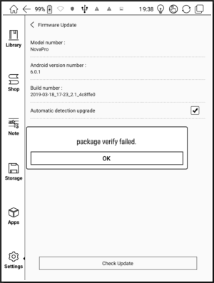

I am having the exact same issue as you, Michal. Nova Pro, as well.
I am also experiencing this issue.
Although I was happy with the way the 2.1 FW was working on my Nova Pro, I thought I would see if I could downgrade it. But I kept getting the package failed to verify message.
Then I thought that a factory reset might restore the original FW. It didn't. My Nova Pro is still on the 2.1 FW, and now I am currently in the process of reinstalling all my apps and settings... Ugh.
Luckily, I didn't have anything important stored on the device so all I am losing is a bit of time. Good thing also that I was liking the new FW. I only hope that I will be able to install the international version of the FW when it eventually comes out over top of this version.

I think the problem with my device is that the update from the Onyx page and with the one underscore linked to is that they are for the Nova... NOT the Nova Pro.
Using that update would likely work to roll a Nova device back to the previous firmware, but not so for a Nova Pro which has some different hardware related to the stylus.
So it is probably a very good thing that the package failed to verify, otherwise it might have caused some significant issues. Will have to be more careful about installing or attempting to install new updates in the future.

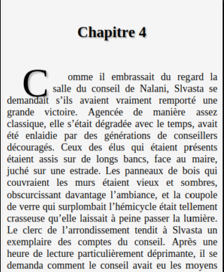

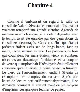

- My main problem is the new version of NEO V3.0 player
With version NEO V2.0 :
*Everything was well displayed
And now with version NEO V3.0 everything works weirdly::
- CSS3, or styles not working properly as :"properly styles", "shading", "initials" (letrine) etc.
- The previous version [V2.0] worked very well,, but the new version [V3.0] is horrible..
*You think, that the return to NEO [V2.0] from [V3.0] as well is not possible either?
PS: I think you're quite right. Nova and Nova Pro will have a different OTA update and therefore update.upx does not work.
.. But still thank you for your effort

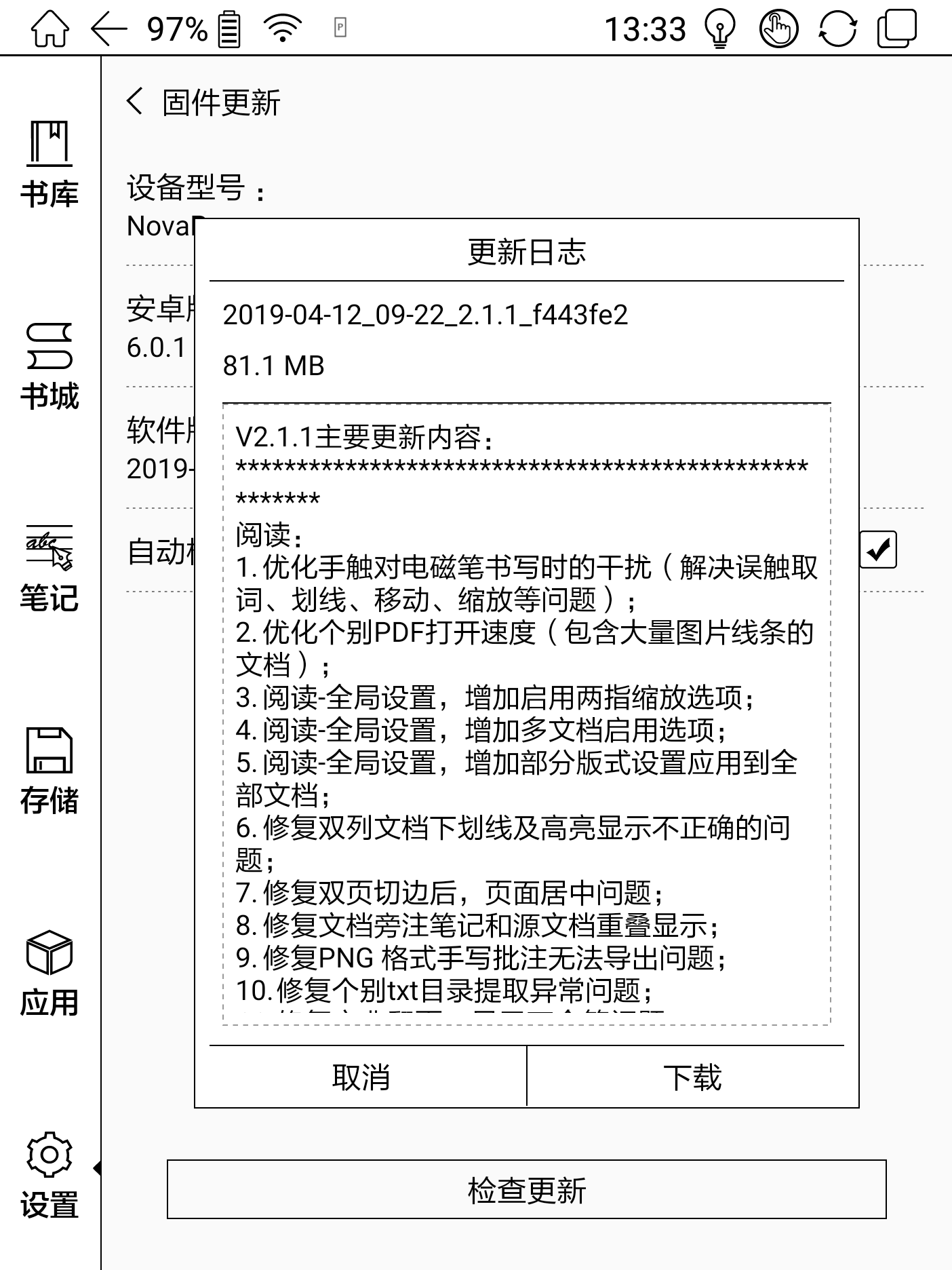

Question New Update Nova Pro 2.1.1
- You have already installed this update 2.1.1 on your device?
- This morning, I received a message "update available" (2.1.1.f44 ), file size : 81Mb
* It is updated should repair problems with "PDF" : close PDF, zoom PDF, TTS in sleep screen,
reading margins etc.
" Install or not?"
- I hesitate because I want to return everything to 2.0.1
*Thank you for your possible return
" Install or not?"
