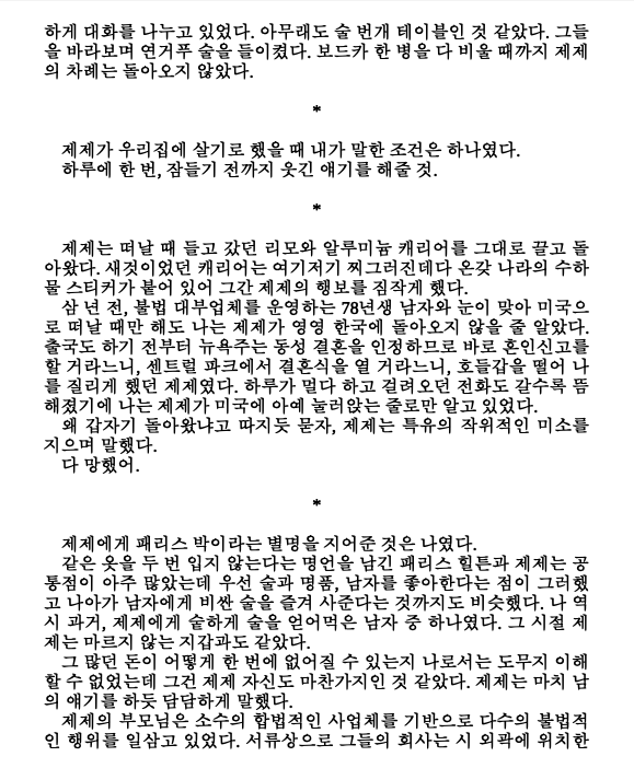

Hi, everyone.
When I convert from epub to mobi, line spacing decreases so much. The last time I converted was about a couple of years ago and it worked fine at that time.
I'm using the latest version of calibre. Tried increasing minimum line height and line height, didn't work at all. Tried on other epub files, same result. If I convert epub to azw3, it works fine.
I've attached screenshots of calibre viewer showing the original epub file and the converted mobi file respectively. You can clearly see the difference. What could possibly fix this problem?

The MOBI format has no support for line height, convert to azw3.
Well, yeah converting to azw3 works fine as I mentioned in my original post.
But my question is, why would line spacing decrease when converting to mobi?
In my previous experiences on converting epub to mobi, the output files maintained the same line height from the input files. Now, I convert with the same default setting as before (minimum line height set to 120%), the result is different with much more condensed lines. I thought it's not supposed to happen?
