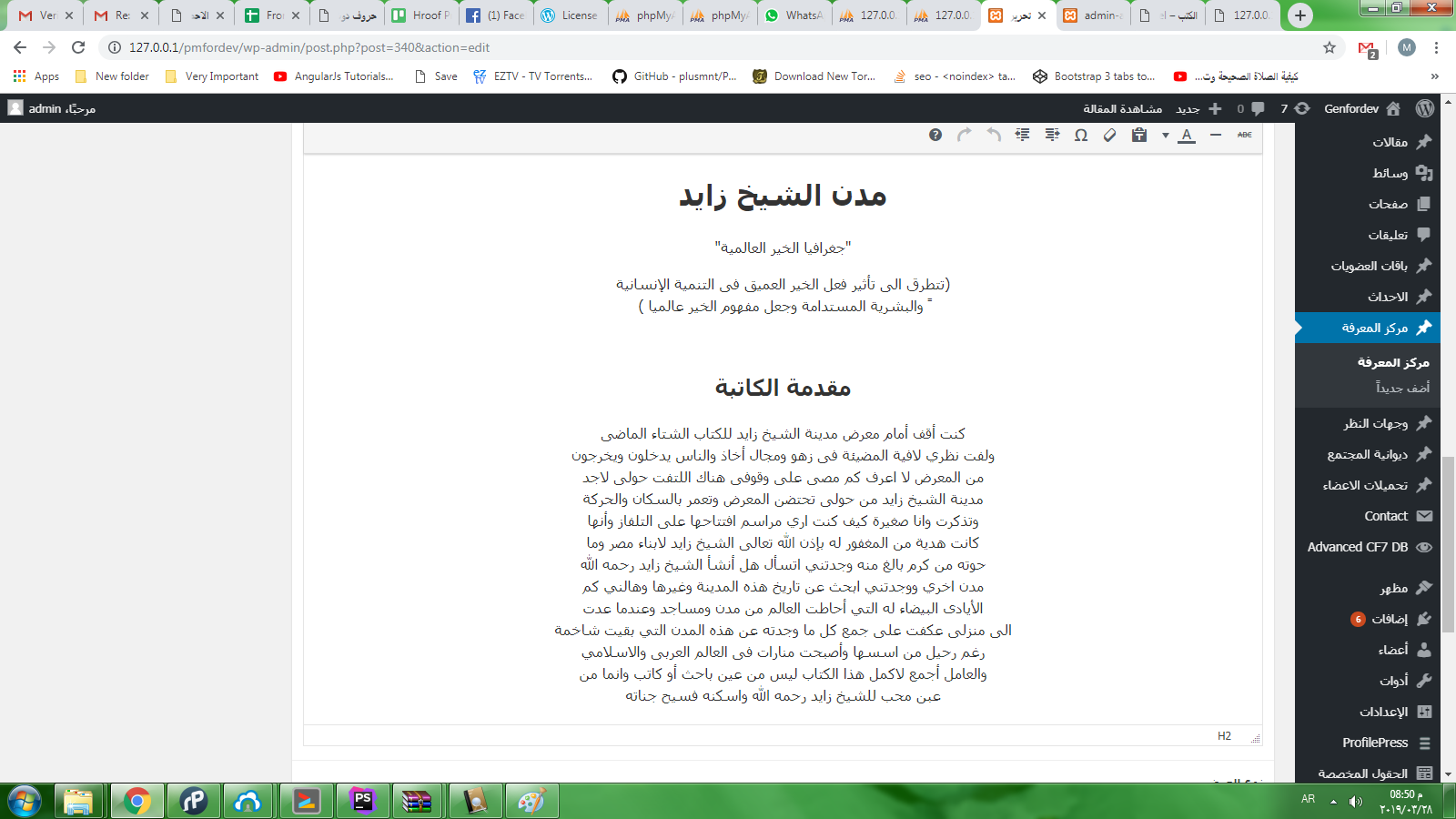

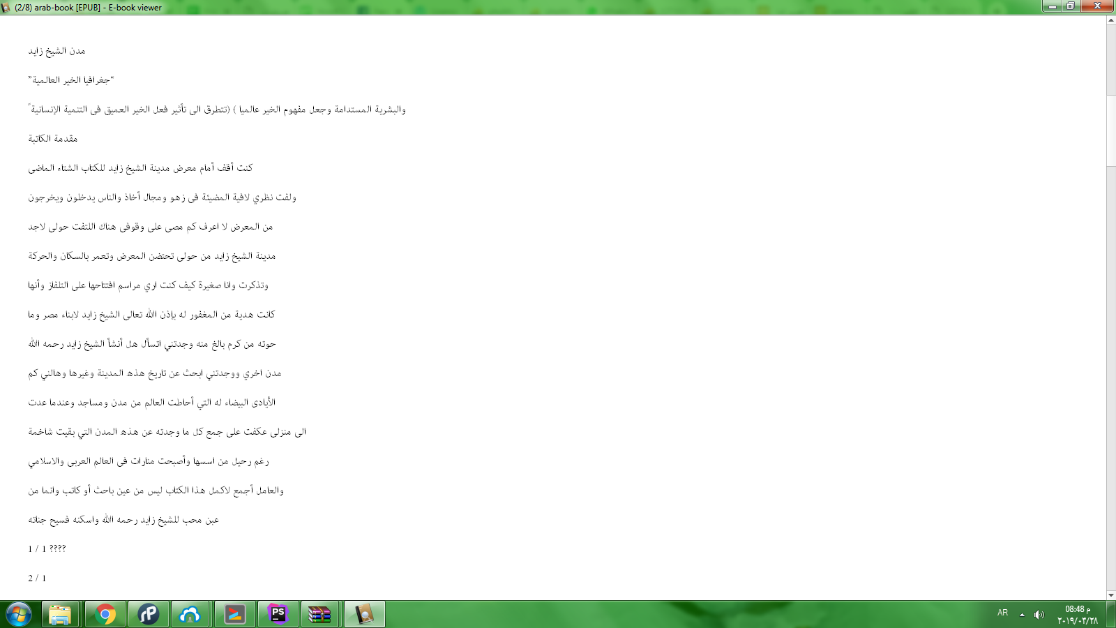

But i should tell you that my idea was true and finally i got perfect example after changing the font .
Basically . in PHP there was a library called "TCPDF" it support creating PDF from html
https://tcpdf.org/examples/example_018/
in this link this library make ability to create PDF from Arabic and Persian text
I Used this library in previous wordpress project to create pdf from arabic text in wordpress editor
please check attached images and pdf
used font like in tcpdf example was "aefurat" font
That was Cool

Sure if your PDF uses a unicode font, then text extraction from it will succeed. The point is, it wil not succeed for arbitrary PDF files.
