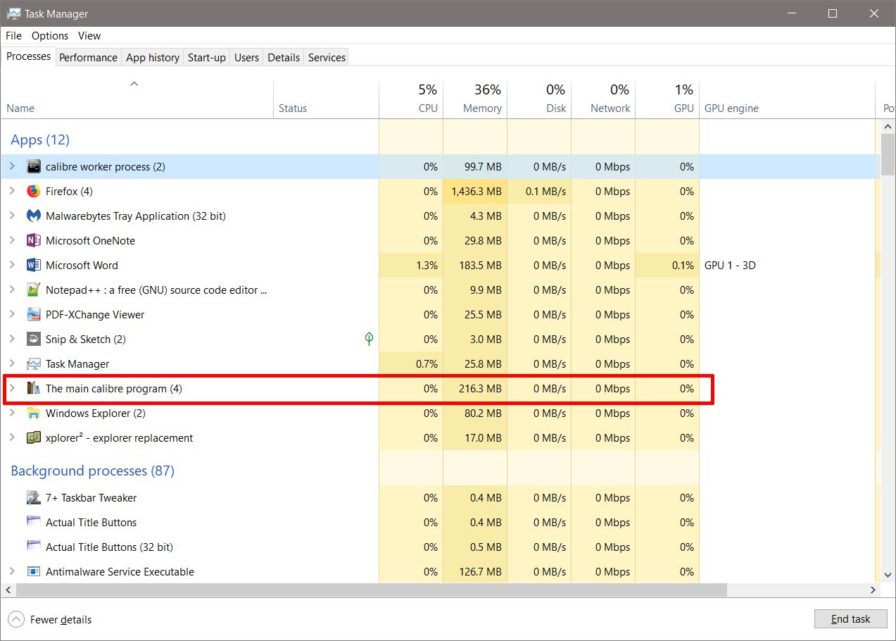

miakay - start task manager (Ctrl+Shift+Esc), your looking for "The main calibre program"
Or anything else with named "calibre ..."
Also look in the notify tray (the ^ over near the clock (probably))
Do you have or have you had multiple monitors?
Attachment 170099
BR, thanks for your help so far but I am still unable to open/find Calibre. I have started in safemode. I have checked task manager .Nothing. The problem is obviously with my Windows 10 upgrade. The new error message is saying "Failed to create Calibre Library, you will be asked to create a new library location".
