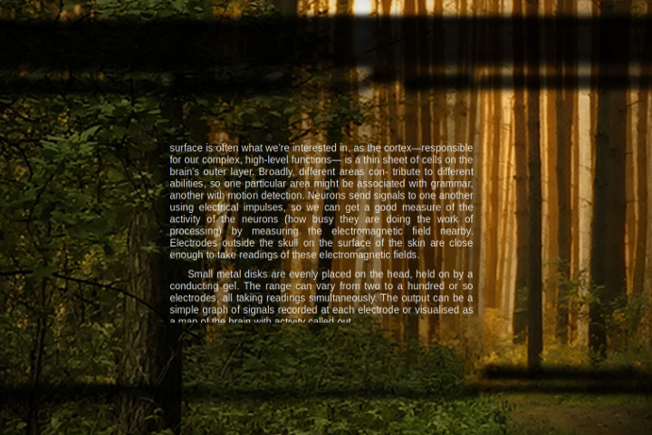

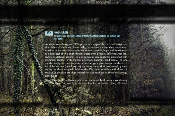

Here are (imprecise and suffering from space constraints) reconstructions of the effect.
Beware that the zoom in the browser may blur the images. Load the attached in case.
ID:	170048   Click image for larger version

Originally Posted by bango View Post
Mdp's reconstruction pics are extremely accurate when using an inverted colour scheme
But I compromised in making a few details precise, I wanted to give a fair idea without spending the effort needed to make it a fully faithful reconstruction.
Do you also have the display contents alternating focus and out-of-focus?
As in "Do you also have the display contents"
where with black I meant "in focus" and with grey "out of focus".
And the areas out of focus become in focus (while others lose it) if you move the glasses farther or closer or if you pan them to the left or right.
