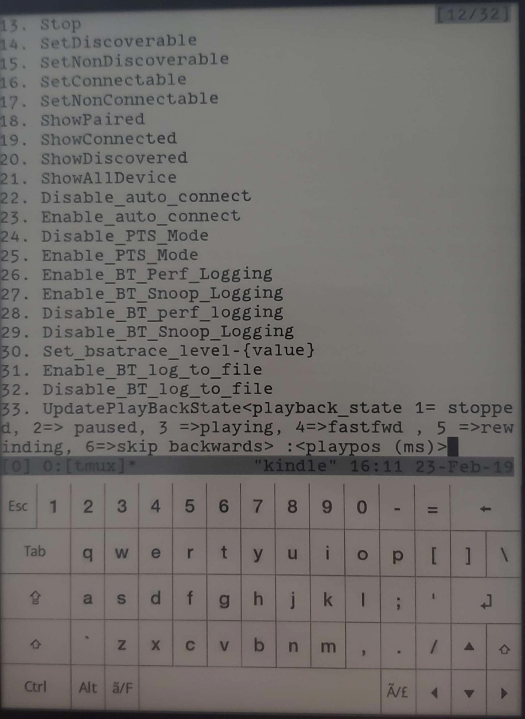

Hi,
I've just got a Kindle Paperwhite 4. This model has a bluetooth on board but natively it doesn't allow to connect a bluetooth keyboard (only audio devices).
The first thing I did after buying it - jailbreak. It's allowed me to install kterm. Via kterm I found a utility on the kindle called "btui" (see attachments).
I've scanned for devices using command #3 and it found my "Logitech" keyboard. Unfortunately, I was not able to understand the command #6 (Pair) - it did nothing.
So, is it possible to connect a bluetooth keyboard to kindle paperwhite 4? Any ideas on how to do it? May be we can install a custom bluetooth drivers, etc?

1) Build the missing kernel modules for the BT interfaces.
2) Build and install a general purpose BT stack (Bluez is such a stack).
Note 1: On newer(est) kernels, 1 & 2 may already be combined in the kernel source.
3) Add and test out any up-start scripts needed.
4) Add and/or modify u-dev rules as required.
Note 2: Don't expect anyone except yourself to be interested in generalizing the Amazon/Lab126 Blue Tooth implementation.
I have not been able to stir up any interest since BT first appeared on the Kindles.
