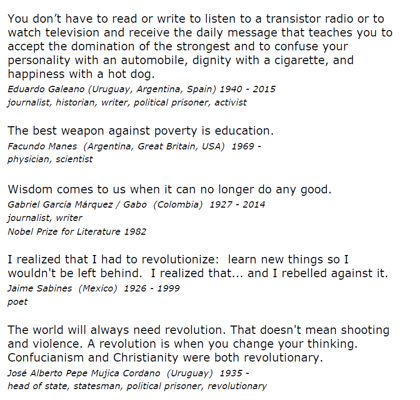

Please forgive this newby question, which I'm sure has been discussed before.
My goal is to transfer my manuscript of quotes for distribution via Kindle.
I first formatted the text and created a pdf that can be used for viewing on the computer.
Following suggestions read on this forum, I then used CALIBRE to convert the rft manuscript to AZW3. The problem is line spacing. Attached you can see:
a. sample from the pdf, with proper line spacing
b. sample from the reformatted rtf, still respecting the line spacing design
c. photo of Kindle screen that shows wrong line spacing.
I do read in the forums that I need to play with the CSS codes for text height and line height to create the design I desire. My questions at this point are:
1. where are these codes in the rtf file? how can I view them? I can see the pilcrows but nothing more than that.
2. what program should I use to try to edit those?
thank you.

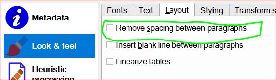

Line spacing ( applies to many lines within a paragraph block) is controlled by line-height: 1.2 (is normal)
Make sure your conversion settings do not have remove blank lines.
(also, your device may need to use Publishers Stylesheet unless you hard encode blank lines )
FWIW I gave up trying to get a 'perfect' conversion between formats. I hand edit my EPUB/AZW3 to add the FINAL polish

The red and blue underlines in your 2nd image suggest it's an image of Word, or maybe Writer (can't recall if it underlines 'errors' in red and blue) - if so save the file as DOCX and try converting that.
And as previous responders have suggested if you use Styles in Word/Writer you'll get much a better result.

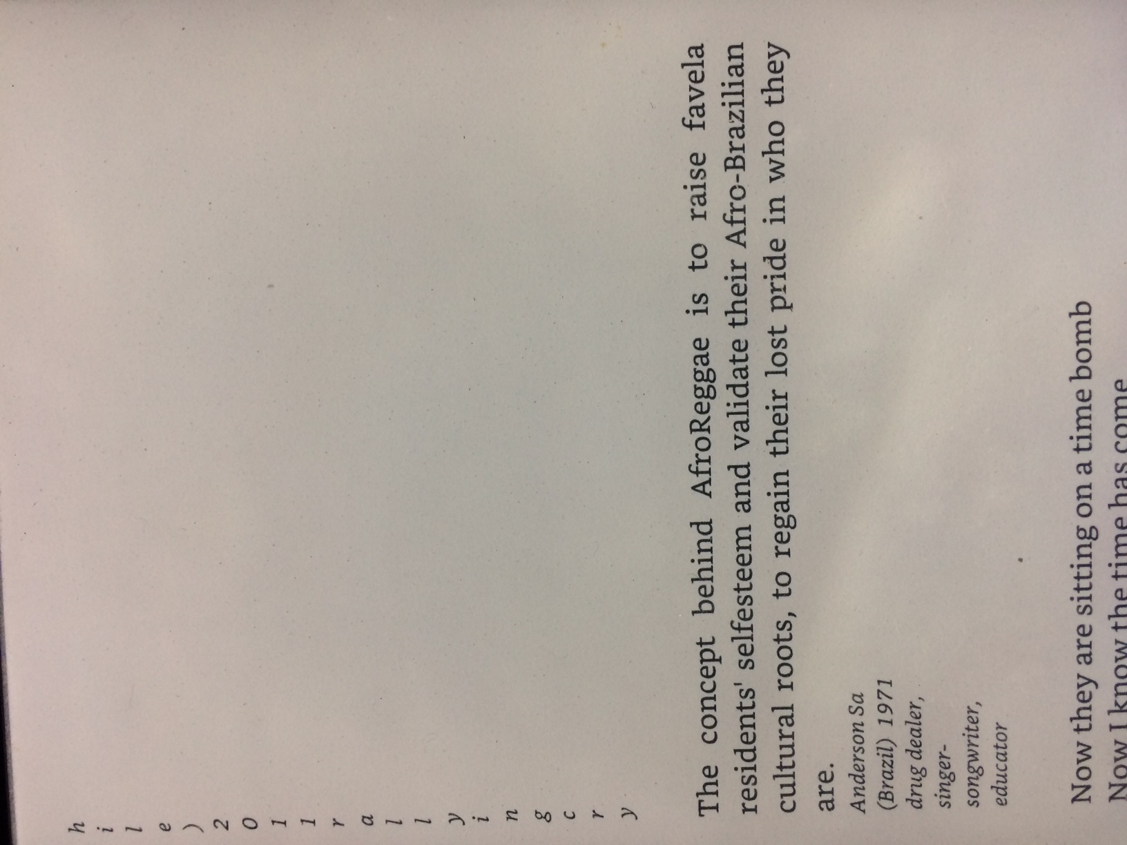

Hi BR. I was hopeful about your suggestion to use the Word program to create a 'docx' document that could be converted on Calibre for viewing on Kindle.
The result is very interesting and I've attached three samples, along with the original pdf (which shows the correct design for text). When I use the path you suggested, prose text is generally (not always) properly produced.
But poetry and the two or three lines after each quote are frequently messed up - as you can see in the attached photos of my Kindle
Thank you!.
