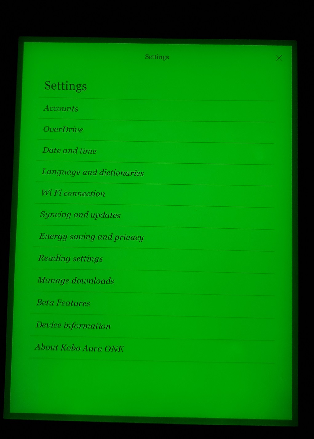

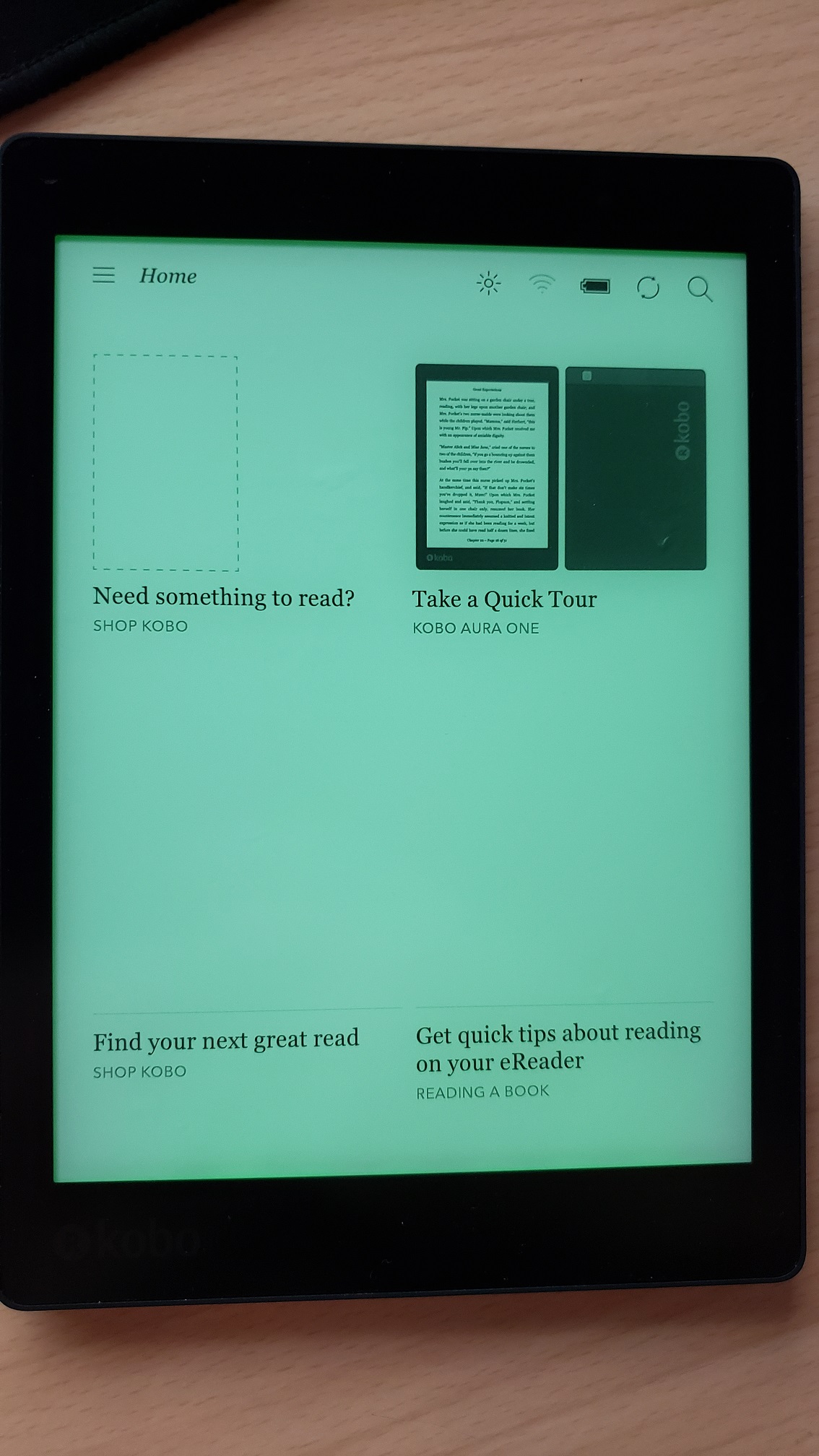

Hey all,
Long time lurker on the forums, lots of good details helping me decide on what readers to get. After using various Kindles for several years, I decided to give Kobo a try, and purchased a Aura One Special edition in December of 2017. I have enjoyed using it over the post year, although there were some small issues with screen uniformity, I was resigned that nothing was perfect. However, over the past few days the screen has been flickering, and now it has turned a solid green. Kobo support seems to think this is a software issue and advised me to do a factory reset and make sure it was updated, which I did, but obviously that was not going to solve the problem. It looks like whatever LEDs that were being used have had some sort of temperature crisis. Any ideas on a fix since it looks like Kobo will not be fixing this? A bit bummed that a $300 device lasted barely a year before blowing up.
ID:	168851   Click image for larger version

@Hisoka: You can test the LEDs if you want. There is function in the developer options to do this. The steps are:
  1. Turn on developer mode by opening the search and typing "devmodeon". Nothing obvious will happen.
  2. Close search.
  3. Go to the "Device information" page of the settings.
  4. Tap "View" next to the last option, "Developer options".
  5. Tap "Setting" for "Set frontlight LED Manually". (For other playing along, this will be there for the Aura ONE only)
  6. Use the sliders to adjust the LEDS.
You can adjust each LED to see which has failed. Or if something else is going on. I'm guessing as the photos show green and blue, that the red LED has failed.
