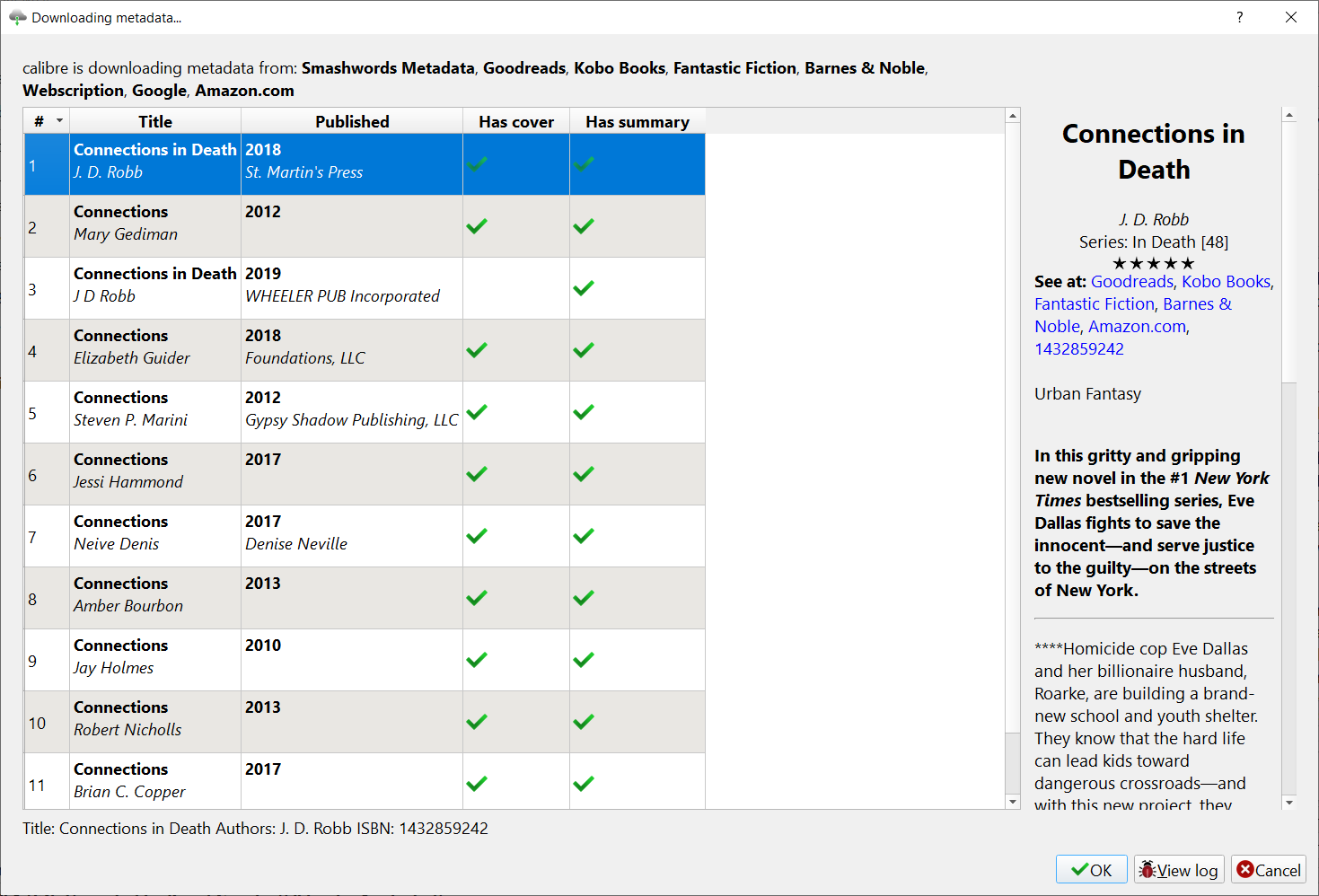

For me, the major issue with this plug-in is that it is very enthused about returning books with no matching on the author. For instance, I picked up Connections in Death by J. D. Robb, added it to calibre and did a metadata update. There were 11 items returned. Two of them were for Connections in Death, the other 9 were books with Connections as the title by 9 different authors. Testing on various other books gives the same over-enthused results.
Name:	Sample metadata search.png

Just posted another beta that should fix that. I wasn't checking the author at a good point, so it was getting far to many results if there wasn't a good match.
