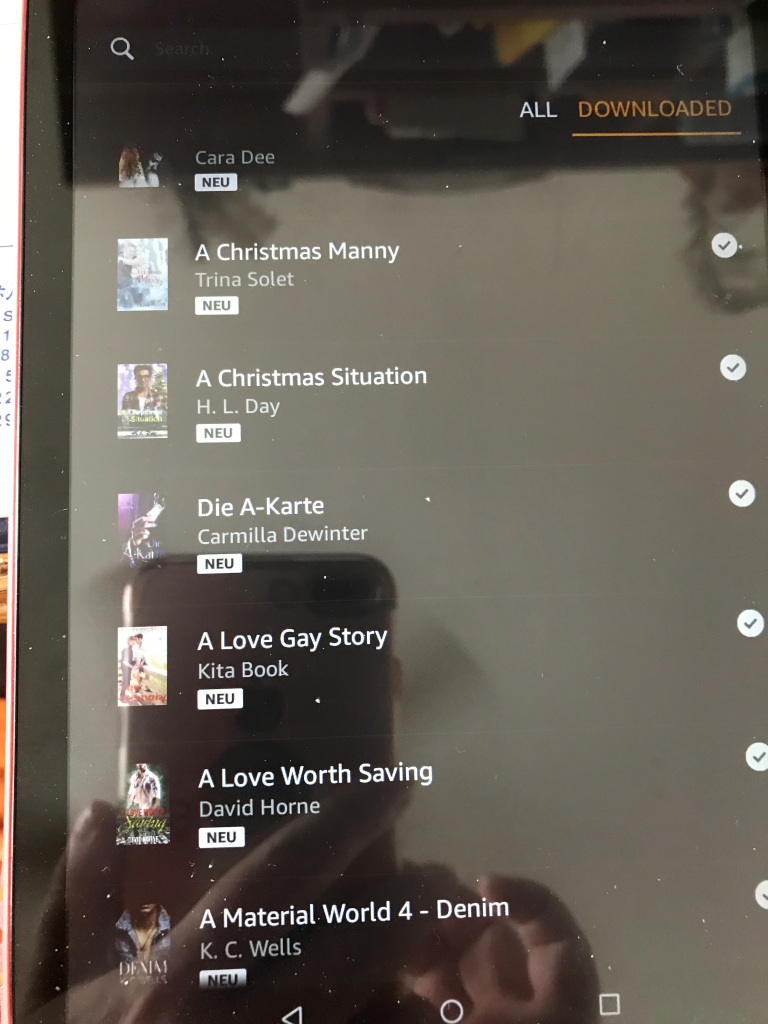

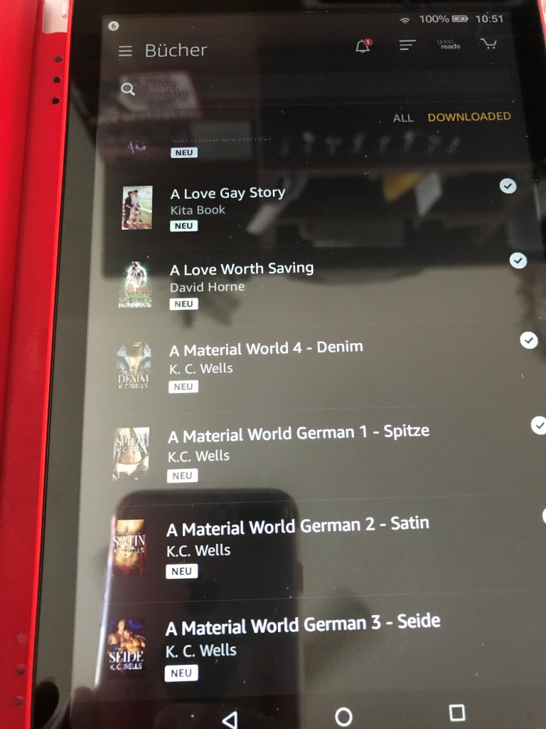

I got last week my new fire HD 8 (8th generation) and transferred all my books from calibre (around 5000) to it. Normally I have it sorted by newest/oldest on the fire under books and also in the collections.
To be sure, that all books are in collections and are really all transferred, I sorted it alphabetical and I found out, that older books (from beginning 2018 and older) are sorted like following: Title: A Material World book 1 is under 'M' and the newest book in the series Book 4 (and the German translations) are under letter 'A'.
Same with 'the' some are under 'T' and some are under the letter of the main word.
I want all under the first letter of the title.
In calibre is correct sorted.

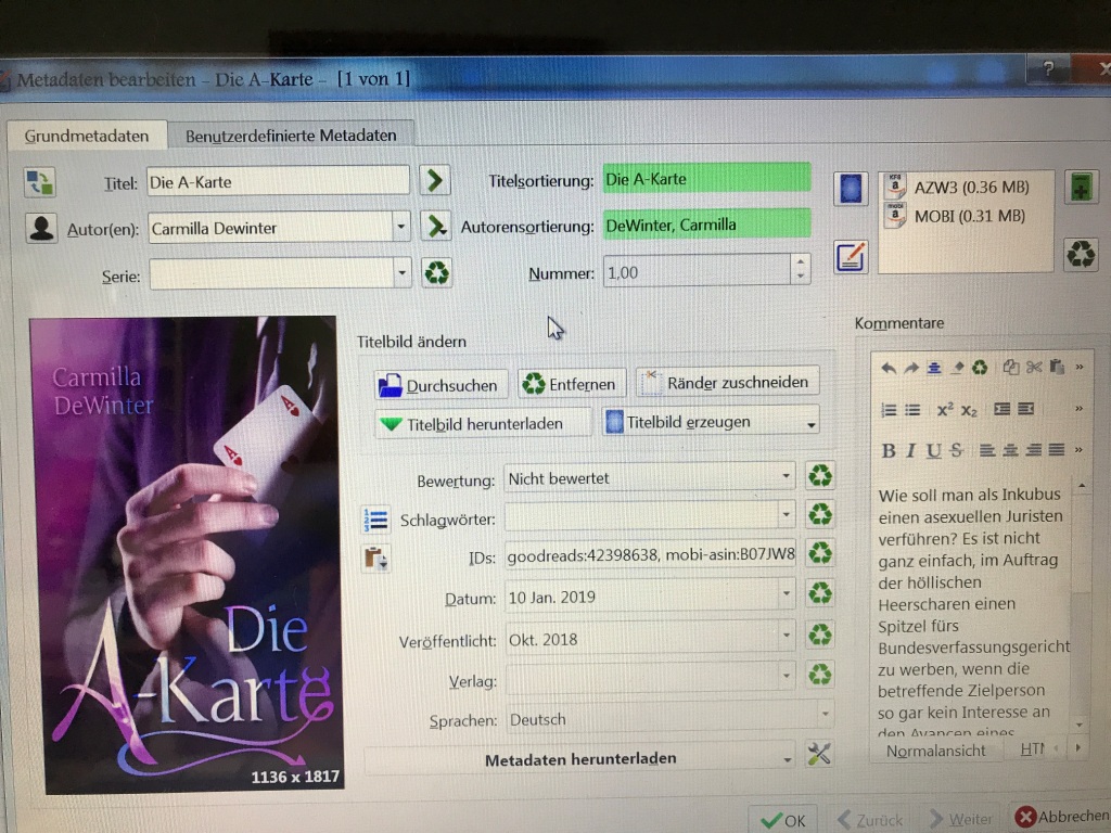

I tried now with one book to transform back in AZW3 and transfer to my fire. The same. It's the book 'Die A-Karte' from Carmilla Dewinter.
Then I thought, I download it again new from amazon, so I have the original file. But that's also a mobi-file in the origin.
So the same. It's under 'A' instead of 'D'. Sorting for metadata are all under 'strictly alphabetical'

Is the Language for the BOOK in Calibre shown as German?
Is the title_sort field in the Metadata editor Green (value matches sort rules)?

both: yes
at the english books it shows 'english language' and all matches in green.
Some are correct under 'A' and some not, but metafiles in calibre all identical.

From what you show, you did it correctly.
It must be Amazon 'fixing' your metadata on the Fire.

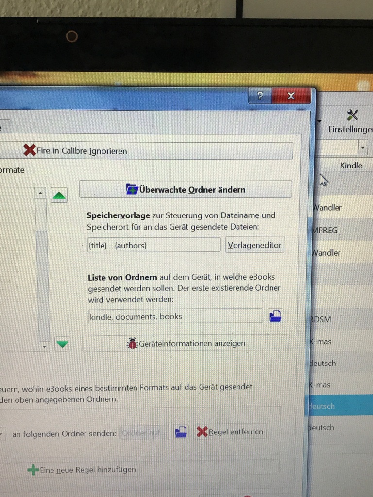

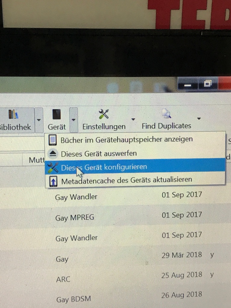

The device driver is part of Calibre. WHEN the device is connected: you can 'configure' it. Right-click the device-view icon
We can't answer DRM questions. If Alf had liberated your library, then it should not matter, OR if those books were registered to a (registered) device owned by the same user ACCOUNT
Old 01-10-2019, 05:55 PM   #9
CGF-House
CGF-House began at the beginning.
Posts: 12
Join Date: Jul 2018
Device: Amazon Fire
That I can choose, when I click at calibre at device icon and config:

When I right-click the device_view Icon: configure device, I see a dialog box with a list of possible formats (some ticked), the some options near the bottom and the standard Accept /Cancel buttons

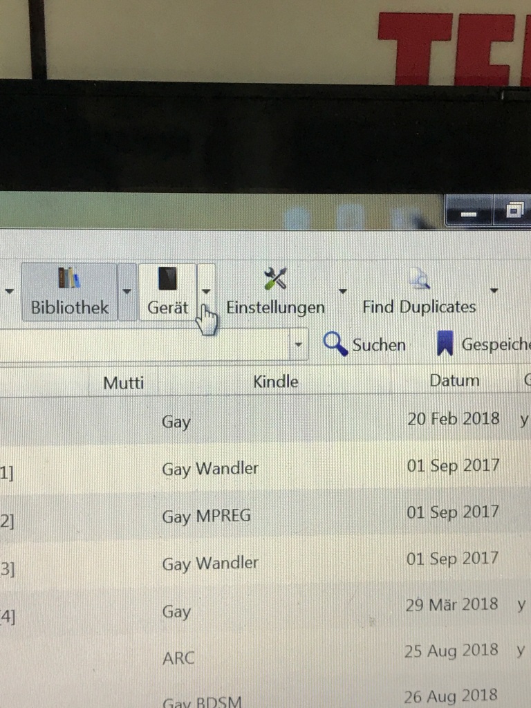

It's version 3.36 for Windows XP 64bit.
That's, what I see, when I connect the fire (which is shown as MPT-Device and not as Fire, why-ever)
