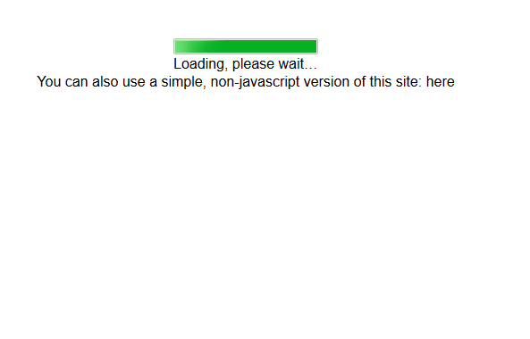

So I am running calibre-server on Linux and can access the content via 192.168.1.1:18080/mobile (example URL), but cannot access without the mobile at the end. Tried in chrome and firefox and am running current versions with JavaScript enabled.
What I get is this:

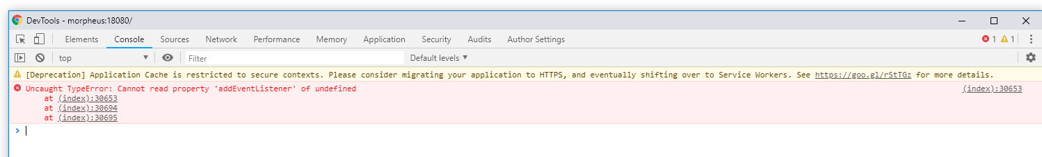

Chrome Devtools gives this:
Any ideas on what may be going on and how to fix here?

Looks like both Chrome and Firefox have restricted AppCache to secure sites only on newer versions (Chrome 70 and Firefox 62). Dunno how to fix short of getting a SSL certificate.
https://developer.mozilla.org/en-US/...ecure_contexts
Maybe try using an older release or FirefoxESR or something?
Old 12-22-2018, 02:09 PM   #5
Posts: 46,605
Karma: 29634066
Update calibre, newer version dont fail when appcache is disabled. Or enable SSL

Sweet - that was the issue.
Thanks!
