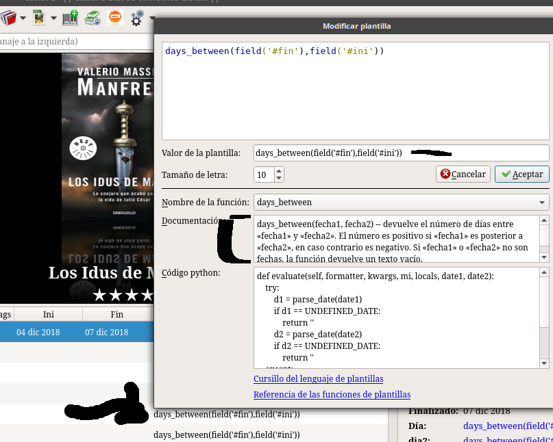

Hello, people could help me with this:
I have two custom columns with the read start date and the end date, I want to calculate the time.
use days_between (field ('#fin'), field ('#ini'))
but in the caampo it gives me back this synthesis, I leave screenshots in case I'm doing something wrong.
Thank you.
https://ibb.co/ZzBXZCk
https://ibb.co/P5LJwqL
https://ibb.co/5BnTkgX

I keep turning this issue around, apparently it's how Caliber establishes it, but it does not work for me.
I will miss some complement?

You must put
program:
in front of the days_between function. See the Template General Program Mode documentation.

@chaley: I assume he meant "I tried it here and it didn't work.
@dunhill: The following is working here:
program:
days_between(field('last_modified'),field('#last_seen'));
I only have the one date custom column in the library I have here. But, it worked with the Date a Published date columns as well (once I typed their names in correctly .

I have changed the format so that I do not get the result in decimals with this syntax:
program: format_number (days_between (field ('#dateendded'), field ('# goodreadsstarted1')), "{0: 5.0f}")
I must revise, similarly because with some dates it does not calculate me and they are loaded in the same way.
Sorry, I don't know what is happening there. The two things I'd try would be restarting calibre or editing one of the dates.

Also use "raw_field" instead of "field", just in case the dates are formatting in a way that calibre cannot handle.
