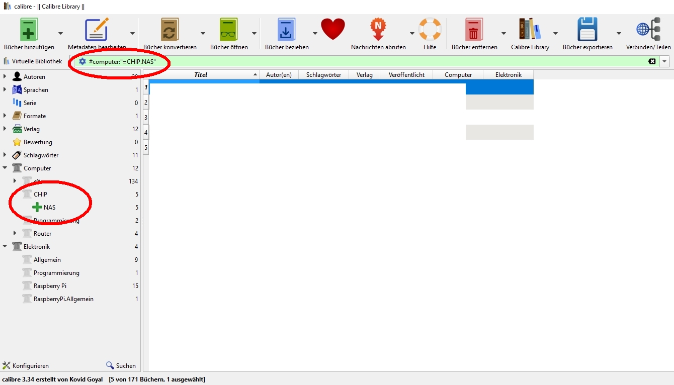

2. I added user data to the "Computer" custom column (see Calibre-01.jpg, red markings) to generate a new subdirectory "CHIP" and in there the subdirectory "NAS". It works!

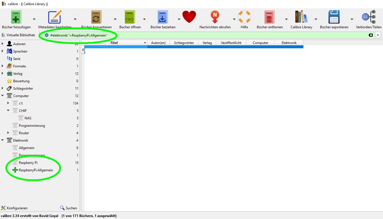

3. I added user data to the "Elektronik" custom column (see Calibre-02.jpg, green markings) to generate a new subdirectory "RaspberryPi" and in there the subdirectory "Allgemein", but it's not working.
I have no idea what's the difference between both custom column (max. length of entries ???), but I don't found a solution for this problem.
