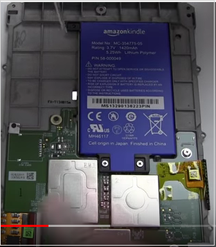

Originally Posted by BookCat View Post
Who put the battery in? If you did it, perhaps check that you've done it correctly.
It would be pretty hard to screw up the battery installation on one of these. (See attachment.)
