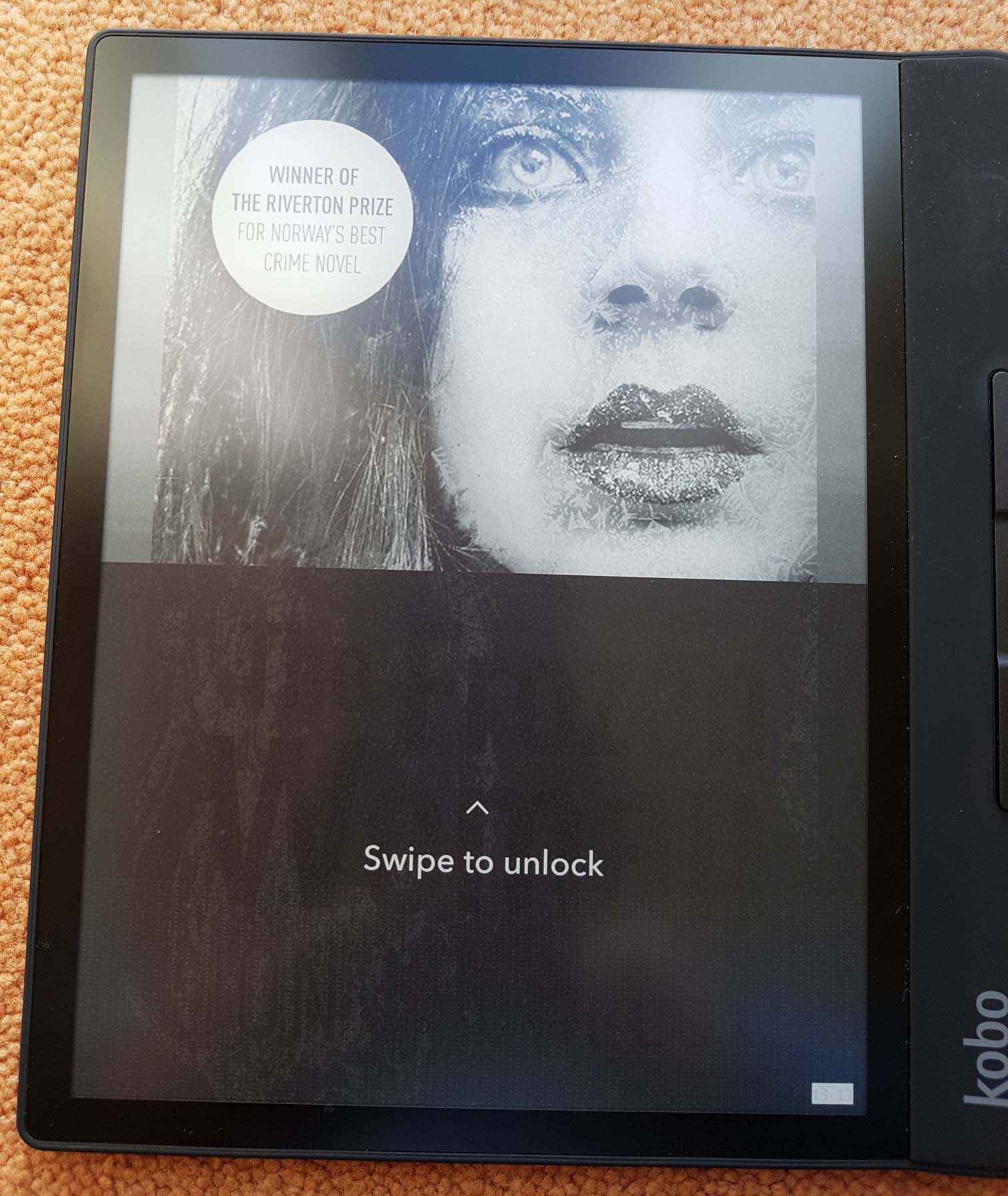

I'm working on a patch, but it's hard, as I don't have a forma. If you could provide a screenshot, it would really help.
I tried ... but I think there's a Catch-22 situation here
To do a screenshot requires the on/off button to be configured to capture the image rather than its standard function of switching the Forma on/off. But to see the 'swipe to unlock' you need to have the on/off switch performing it's standard function.
Is a photo (taken by a rank amateur) any use?
Old 11-06-2018, 08:06 AM   #10
geek1011
Posts: 2,852
Karma: 7454319
Join Date: May 2016
Location: Ontario, Canada
Yes. That should be enough. I just need to get an idea of exactly what I'm looking to change. Also, does the swipe happen before or after the pin?

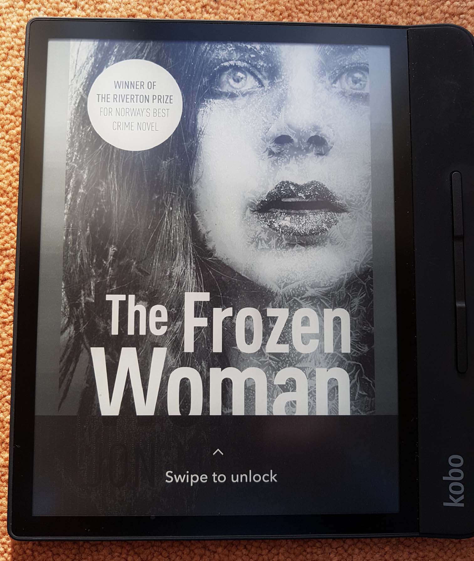

Pic 1: Immediately after switch on using on/off switch.
Pic 2: Immediately after swipe. Had to be really quick to capture that one. Ignore the white rectangle time bottom right. It's a hack and irrelevant to this issue.
PIN would happen immediately after Pic 2.
As you can see, the swipe "feature" was not designed with subtlety in mind
BTW it's easy to patch change the "Swipe to unlock" text but, as patches go, about as useful as a chocolate teapot
