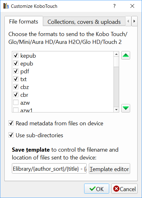

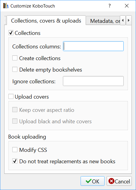

At quick look, you are customizing the wrong device interface plugin. Try the the KoboTouch or KoboTouchExtended (if you are sending kepubs) driver and place your collection information on the second page. The place you placed your collection information is to control the filename and location of files sent to the device. In other words, every book you sent that is in same shelf and series is being given the same name so you are overwriting most of the files with the next file being sent.
For me, the filename field is filled with: Elibrary/{author_sort}/{title} - {authors:sublist(0,1,&)} which gives me usable file names. I don't use collections preferring search.
I've attached a couple of images of what I see with the KoboTouch driver. I would suggest you go back to the Kobo Shelves and Collections wiki and re-read it carefully paying strict attention to the second step.

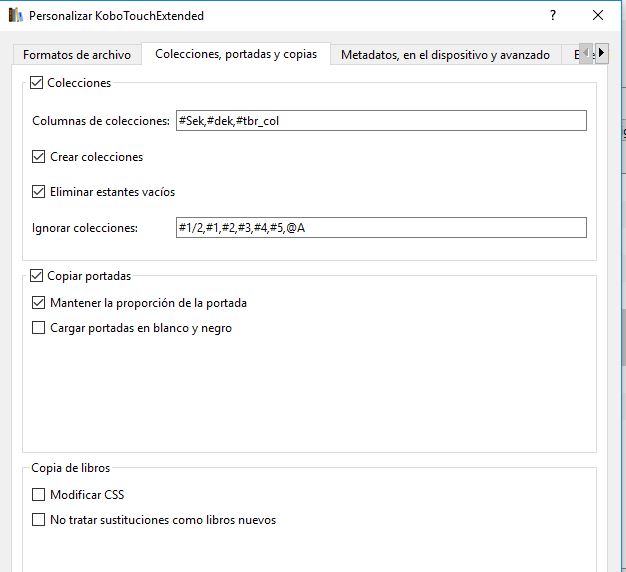

David isn't saying that you use anything, he is saying that the configuration you're showing does not configure the collections in the device, but the file name. The section you should configure is in the following picture (Spanish interface, sorry), as the second picture he has shown.
With that configuration for the name of the file, I don't exactly the name, but I guess something as "#myshelves, series".*, so the 124 books are transferred... but one is overwritten by the following one.

What I was trying to say, the image you showed was for the Kobo driver (for old non-touch devices). The section you were placing your collections information into is the one used for generating the directory/filename when saving to your device. Which would save all your books with collection & series as the filename. This is going cause issues as duplicate filenames are overwritten so only the last book with that name would be seen -- does that sound familiar?
The images I posted were from the KoboTouch driver interface with the first image showing the save information. The second image for the Collections, Covers & Uploads tab is where you would place collection information. As I said, I don't use collections so I leave that space blank but I was attempting to point you at the location where you should have been placing the collection information.
