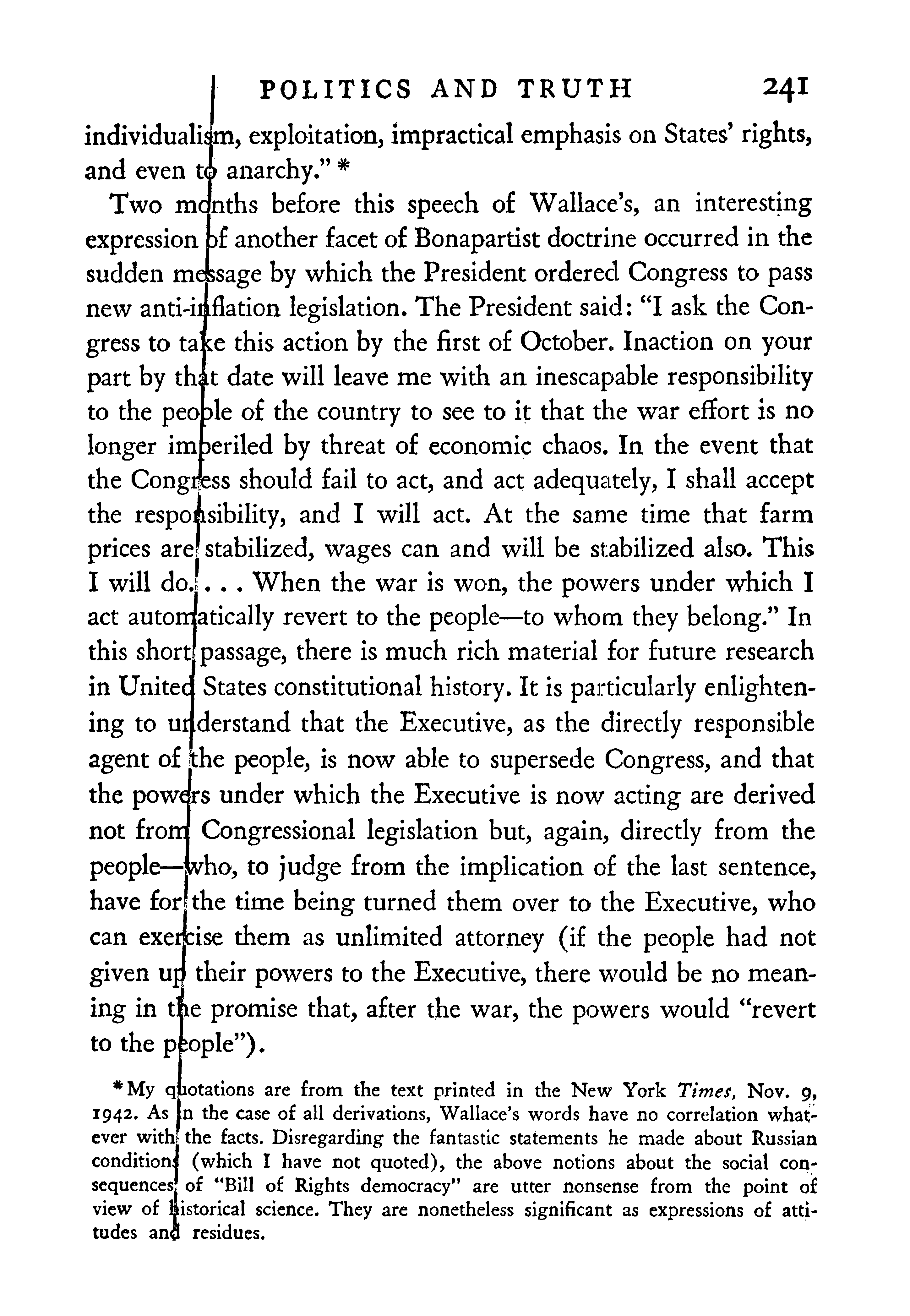

Does anyone have a method for detecting/removing lines in scans WITHIN text?
I think this would really help towards cleaning up PDF scans from Archive.org and elsewhere.

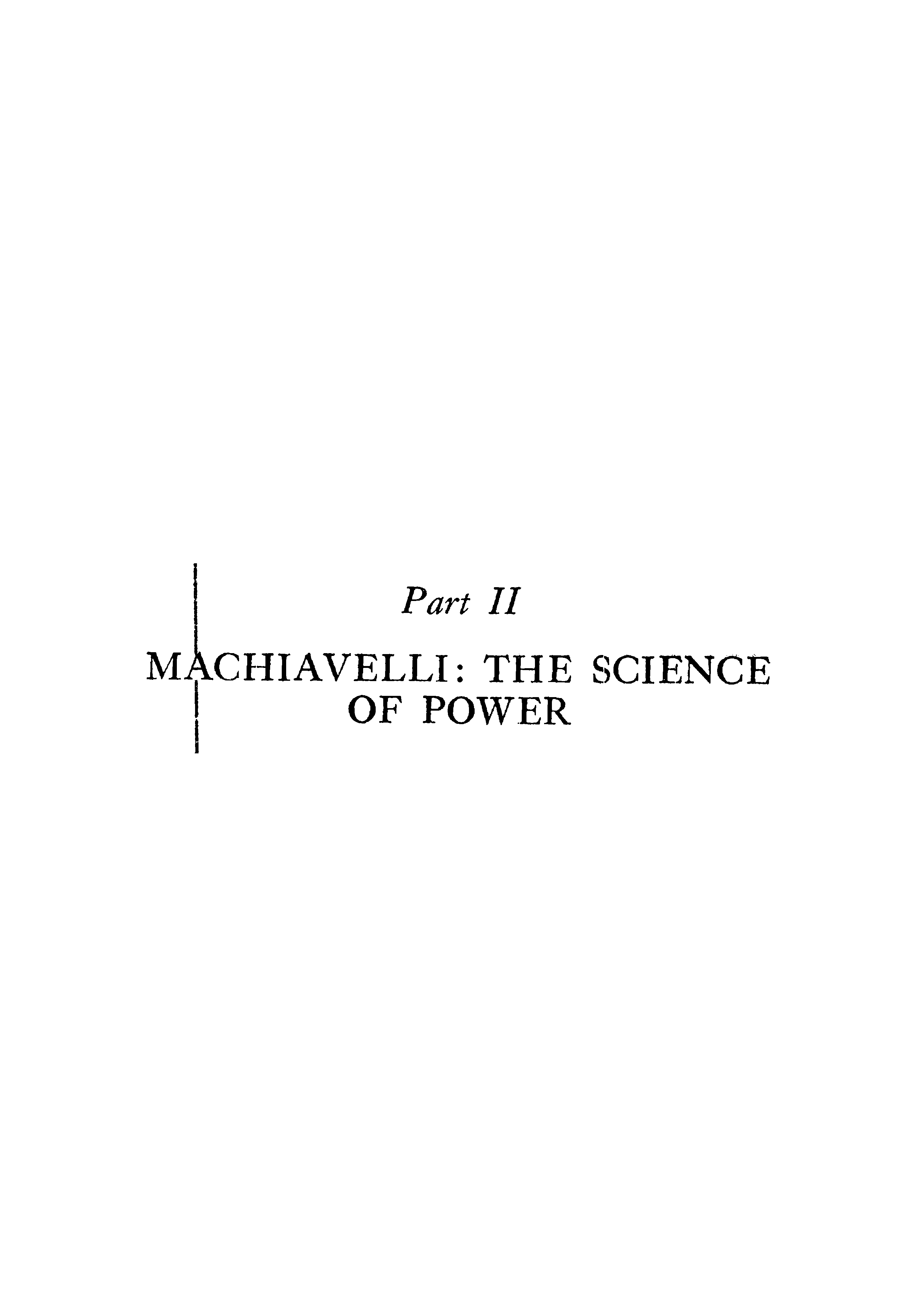

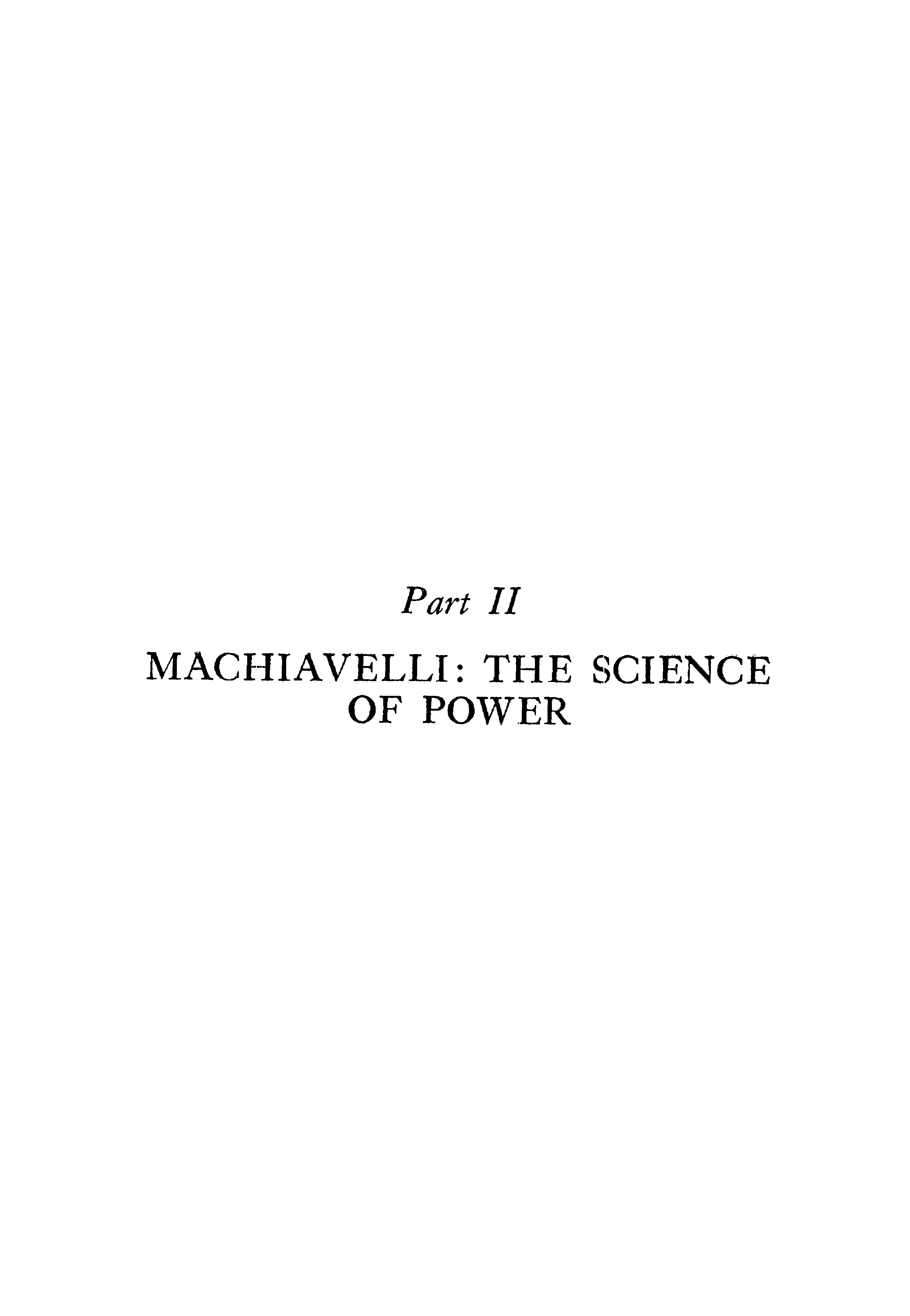

"Easy" Lines
These type of lines occur where the line barely intersects with text:
ID:	166881 Click image for larger version

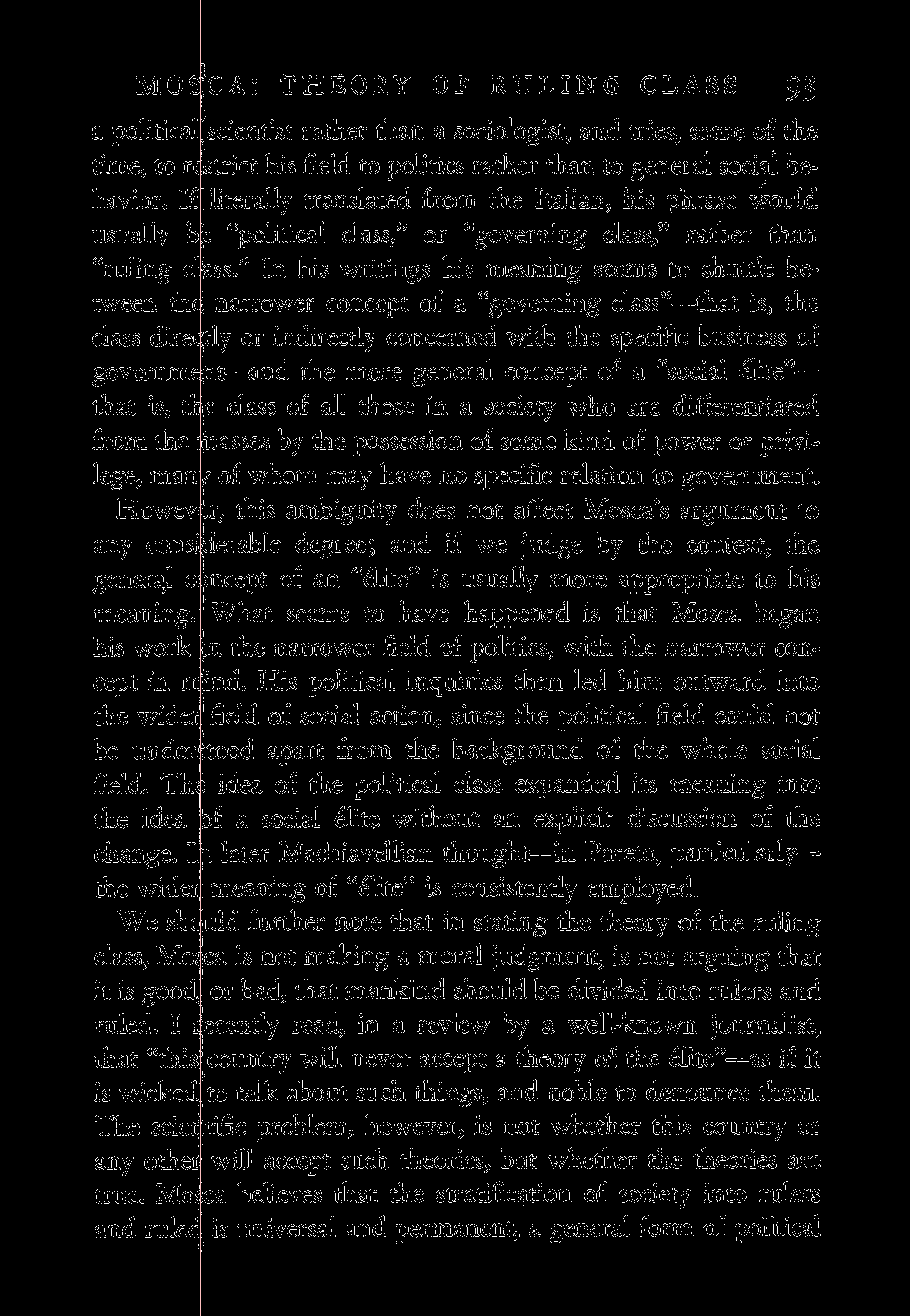

"Hard" Lines
The worst though, are lines which go through the middle of text.

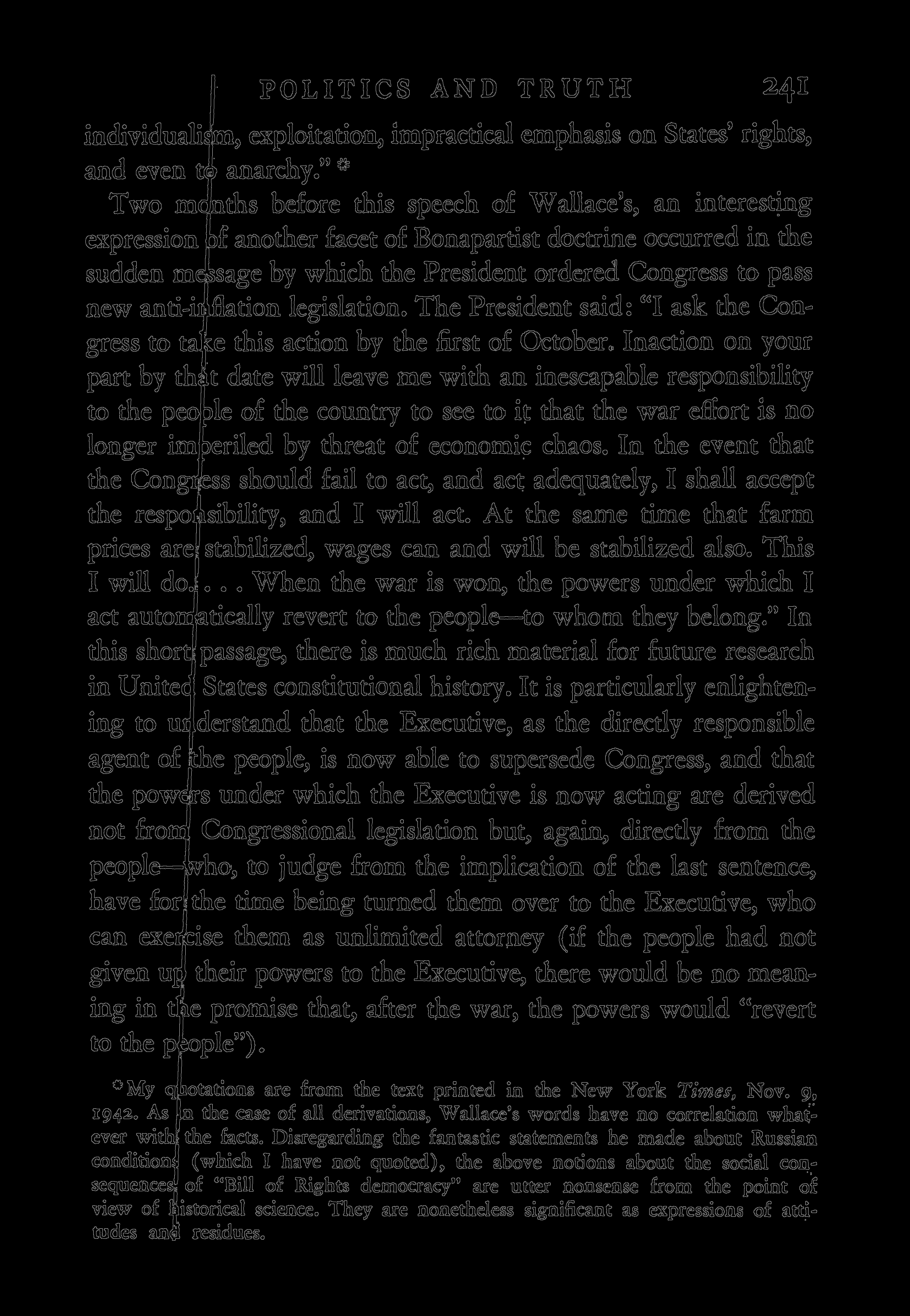

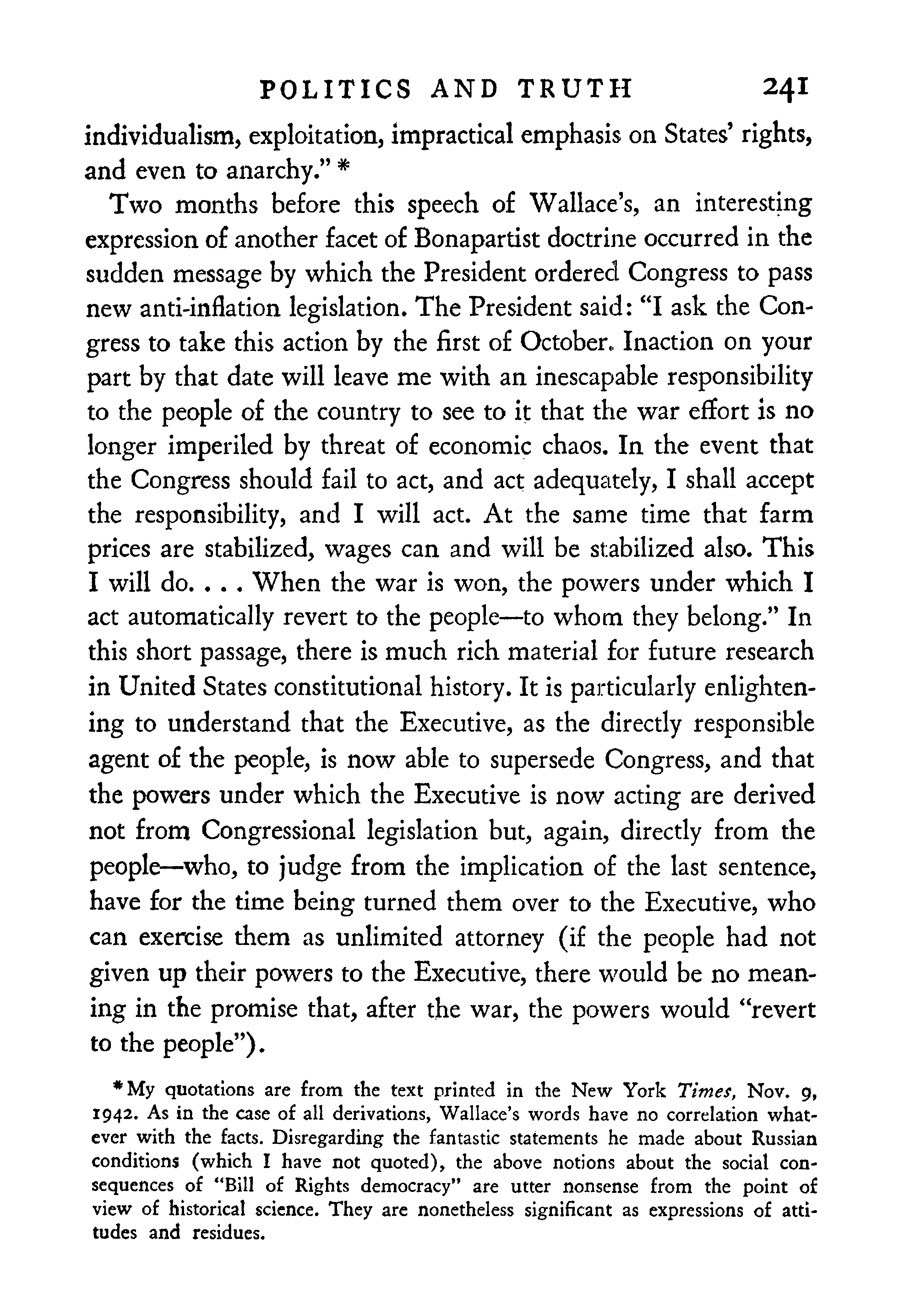

What I would ultimately aim for is Before/After:
ID:	166879 Click image for larger version

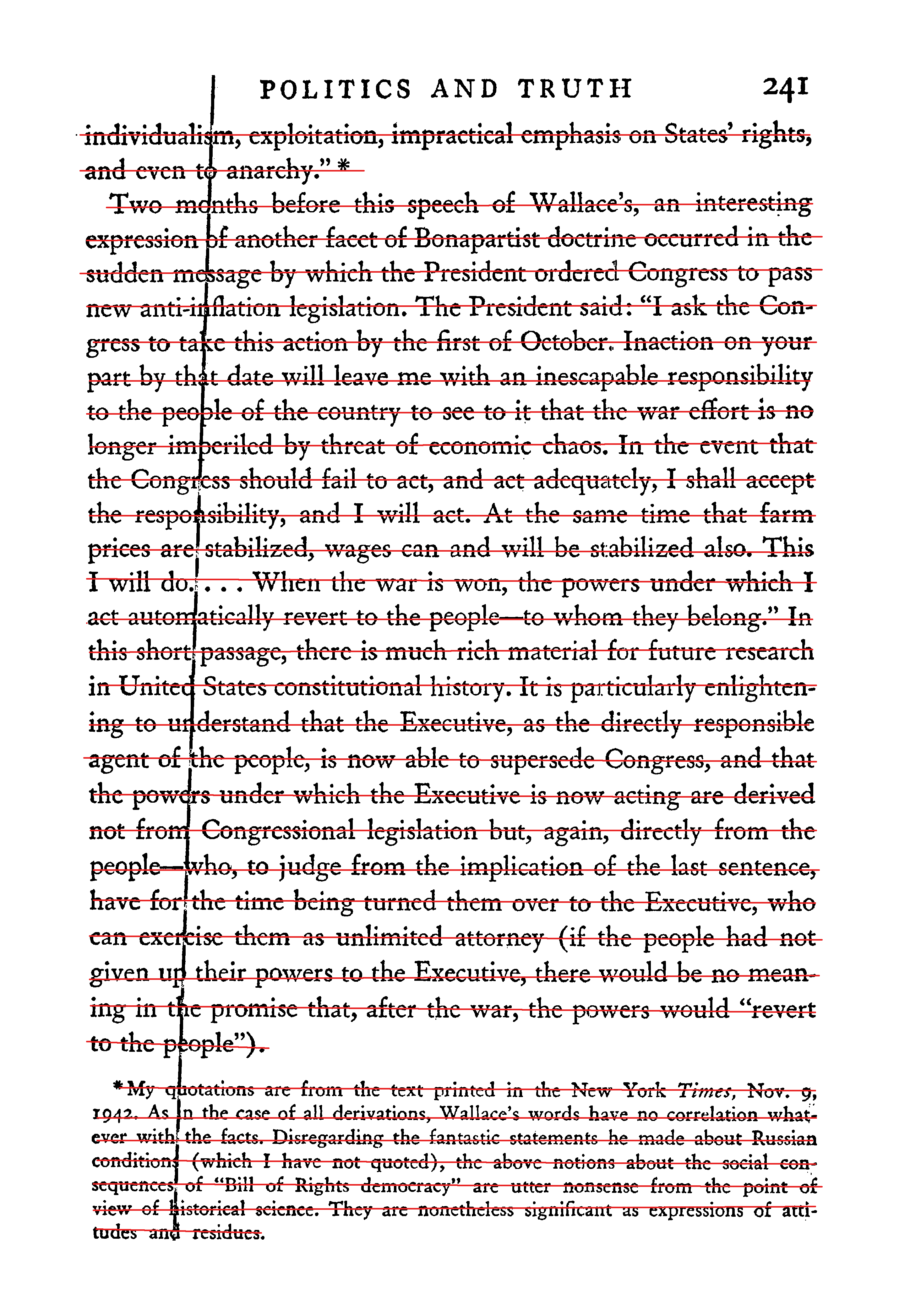

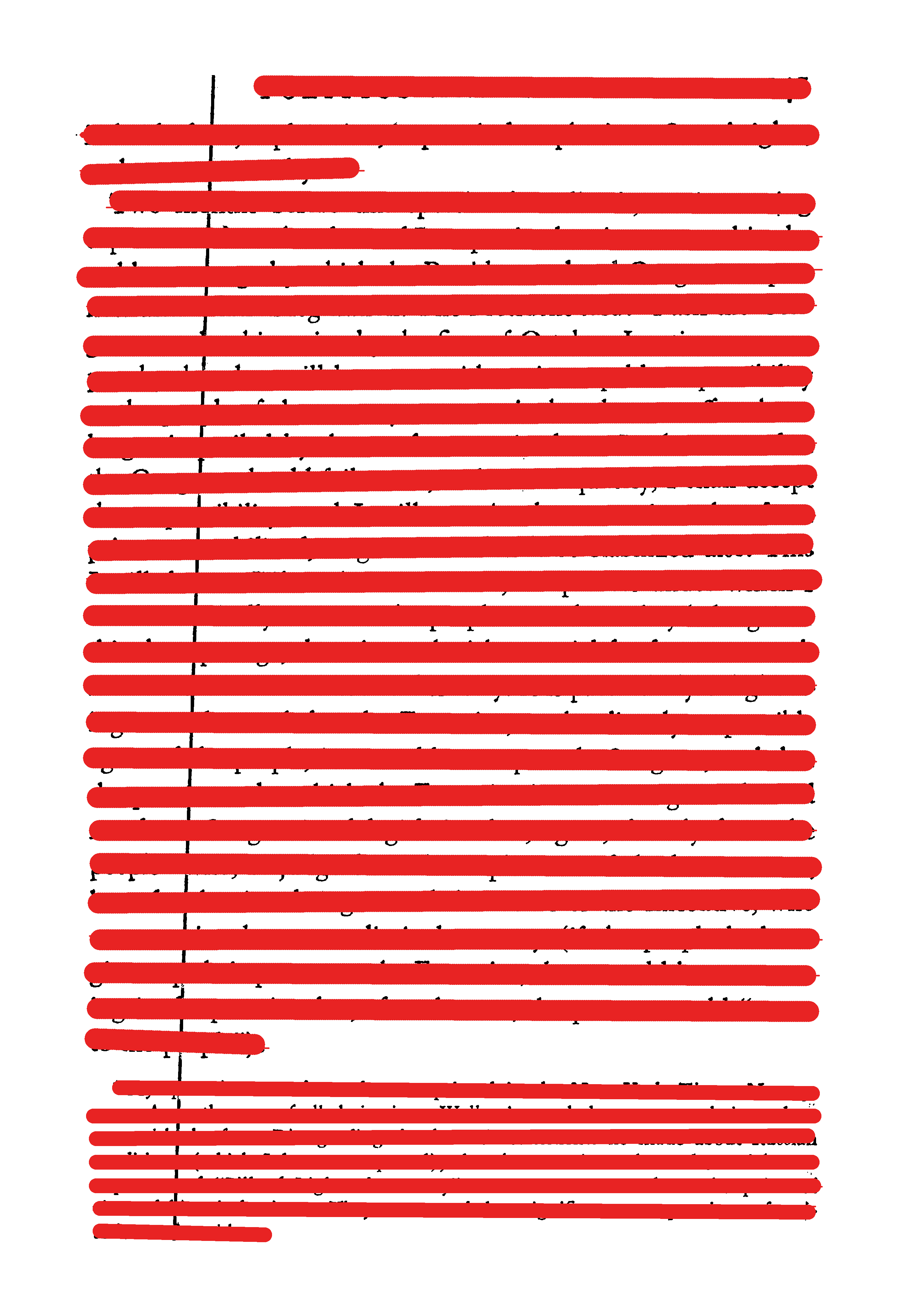

Step 1. Detect Baselines + Expand:
ID:	166880 Click image for larger version

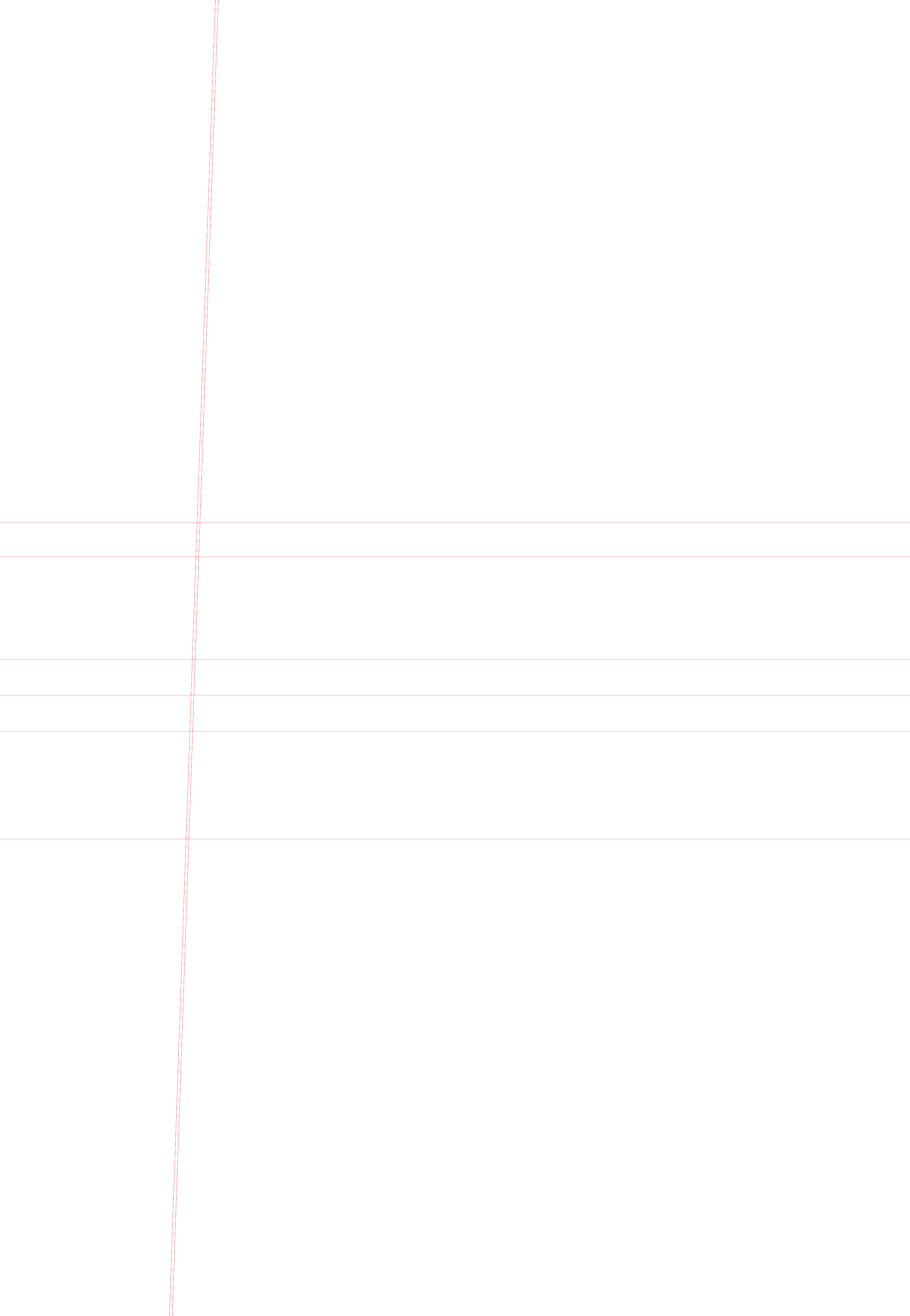

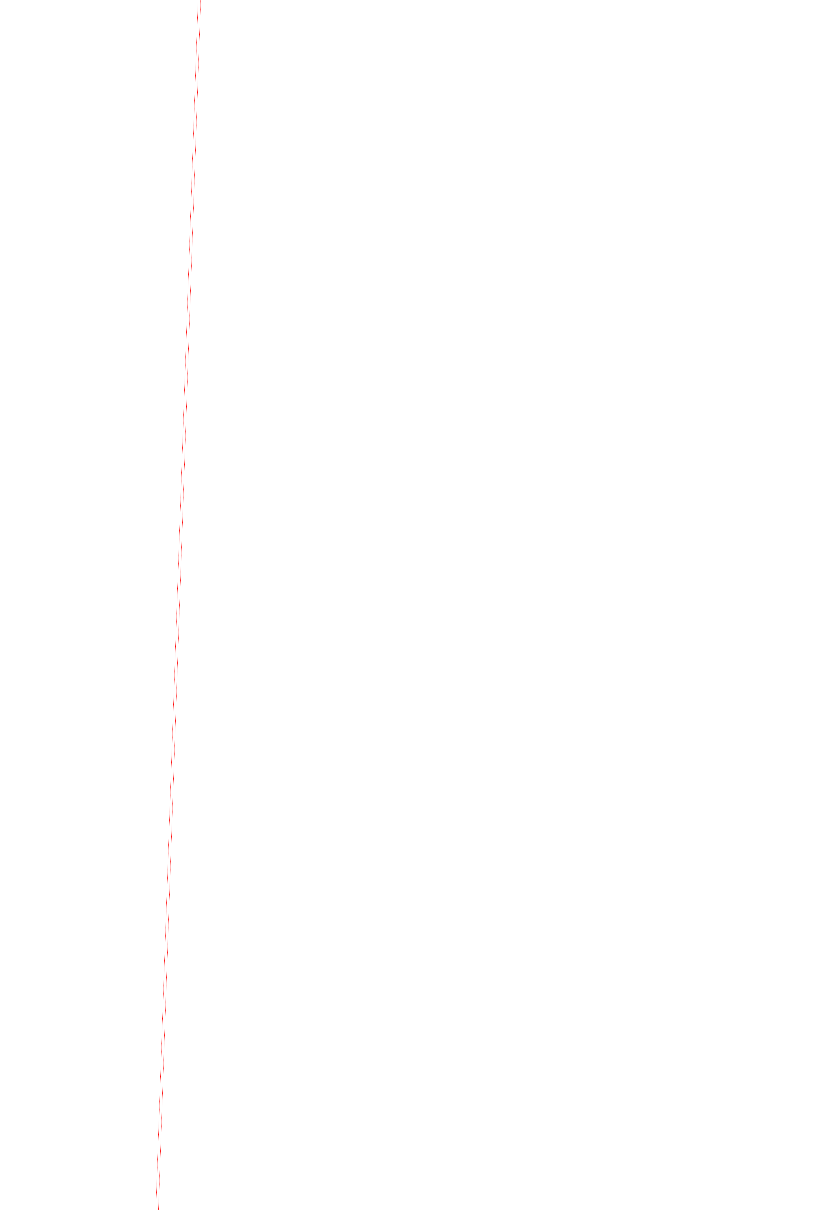

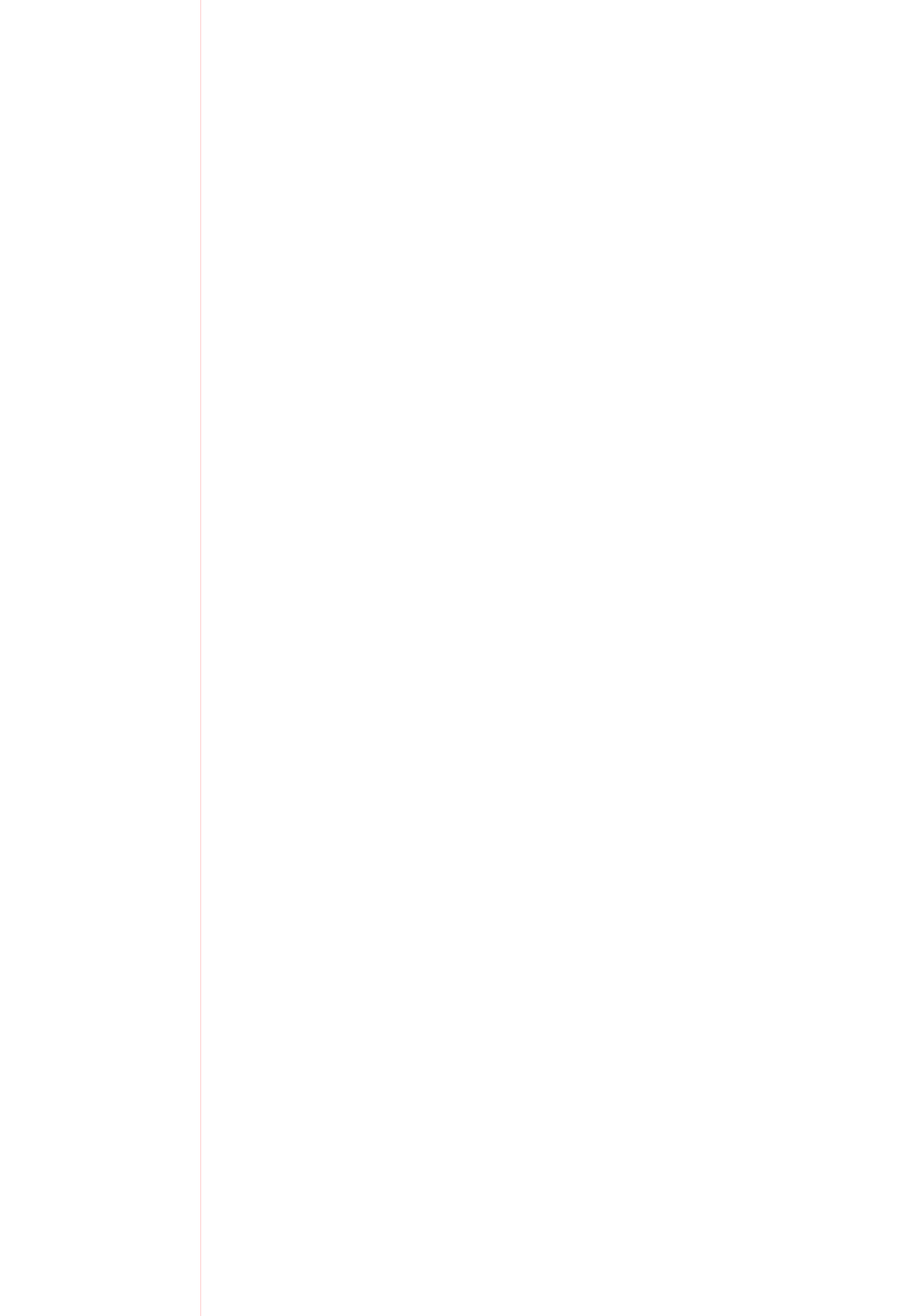

Step 2. Detect Vertical Line (potentially use Hough Lines?):

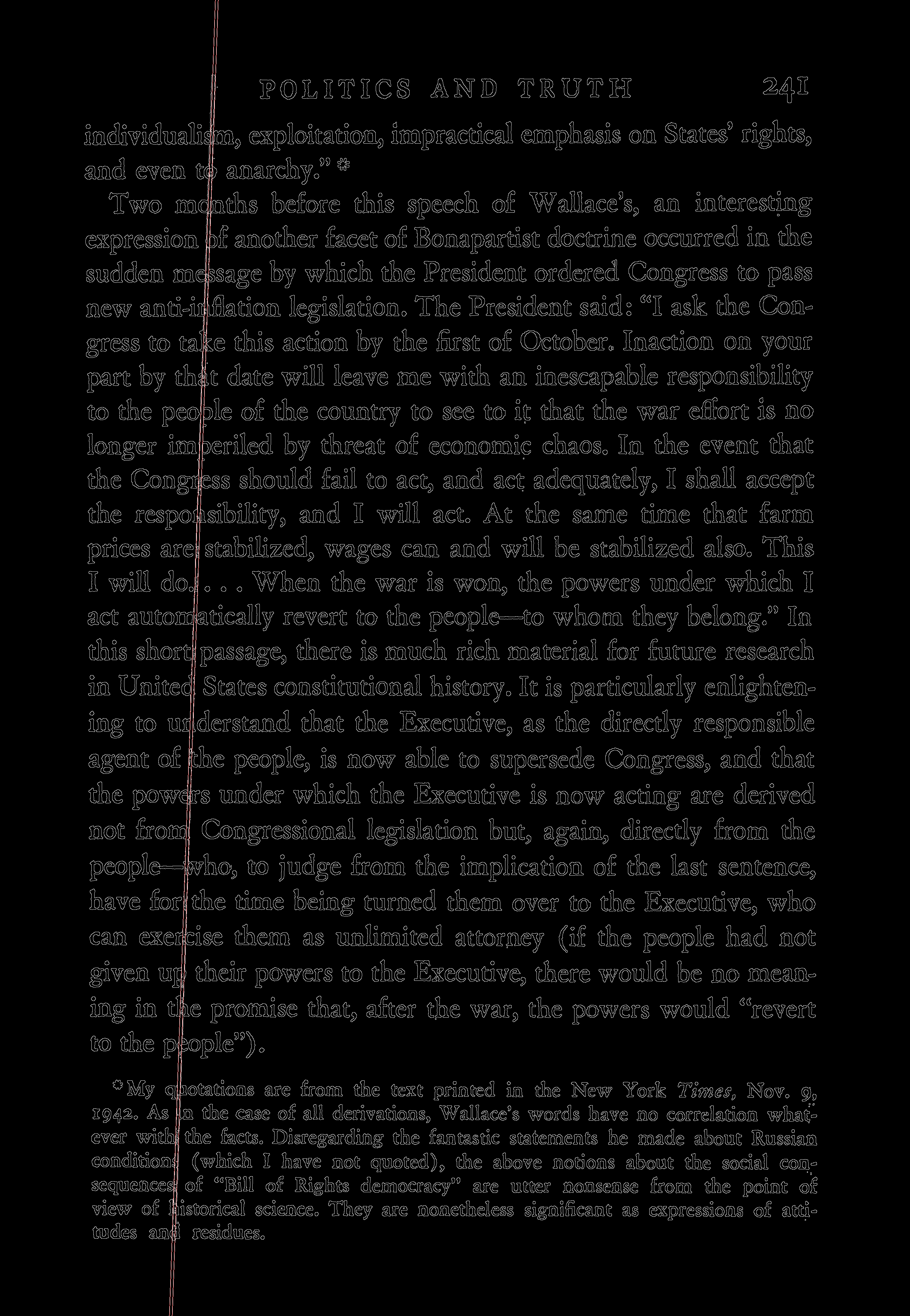

Step 3. Automatically remove vertical line that DOESN'T overlap the baselines:
While not as good as manual cleanup, this would make the text much more readable + OCR-friendly. See Original + "Automatic" + Manual pages side-by-side:
ID:	166884 Click image for larger version

Tonight I was dabbling a bit more with Hough Lines.
I had quite a bit of success locating the line through the text.

Original Image:
Step 1: Inverse the scan using ImageMagick's canny (see fmwconcepts link in Post #1):

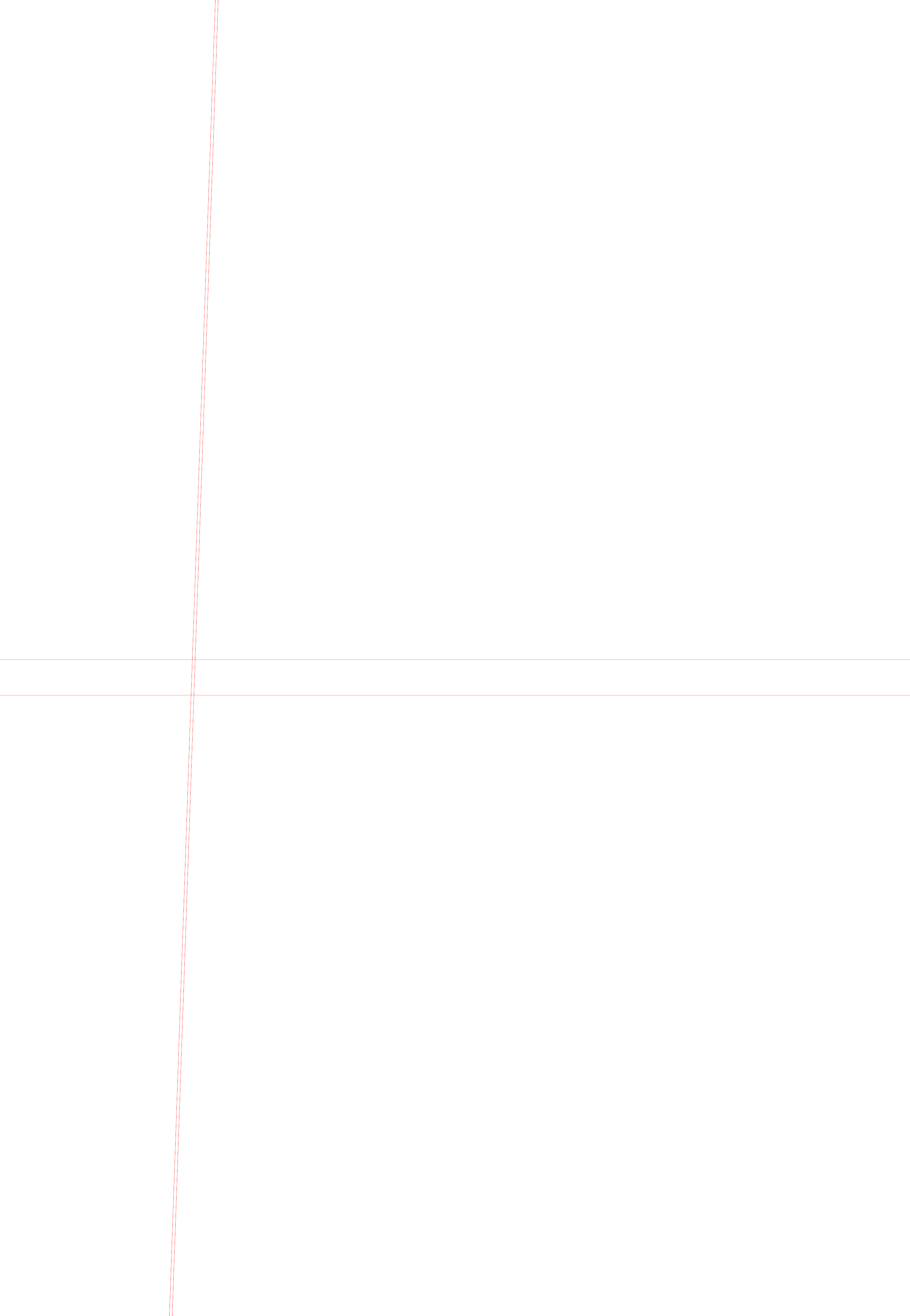

Step 2: Then calculate Hough Lines:
From testing, on this specific book, I found a threshold between 500-700 worked:
convert -hough-lines 5x5+500 -fill red -transparent white test_inverse.png test_lines_500.png
convert -hough-lines 5x5+550 -fill red -transparent white test_inverse.png test_lines_550.png
convert -hough-lines 5x5+600 -fill red -transparent white test_inverse.png test_lines_600.png
convert -hough-lines 5x5+650 -fill red -transparent white test_inverse.png test_lines_650.png
convert -hough-lines 5x5+700 -fill red -transparent white test_inverse.png test_lines_700.png

The higher the threshold, the more "false positives" disappeared.
Step 3: Overlay Hough Lines with image:

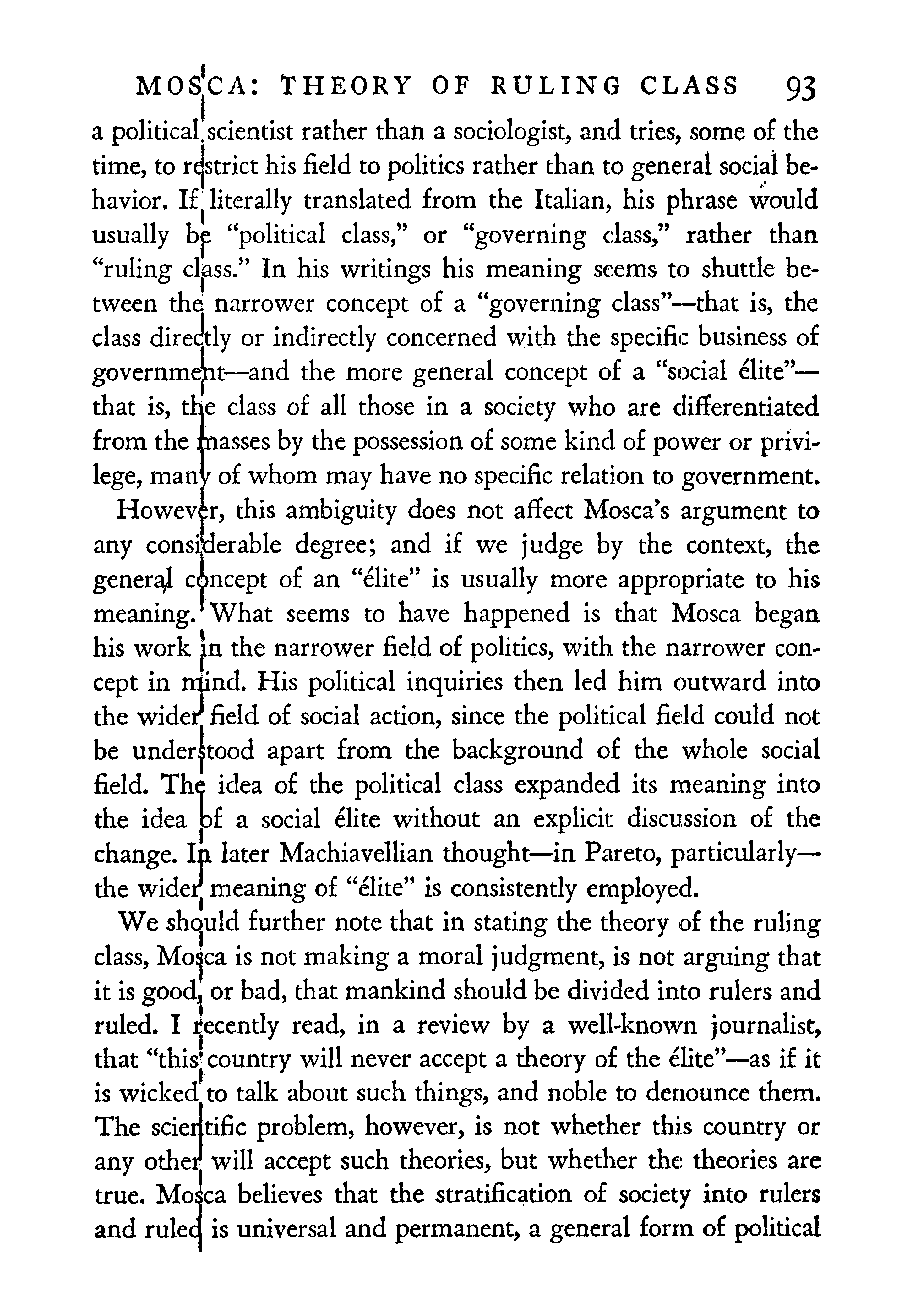

Here's the same steps with another page:
ID:	166902Click image for larger version
ID:	166904Click image for larger version
ID:	166905Click image for larger version
Side Note: To see what a Hough Line calculation is actually doing, I found this part of the video did a decent job explaining it visually:
https://youtu.be/4zHbI-fFIlI?t=219
It goes row-by-row detecting each white pixel, then spins a line in a 360. Plotting this leads to points of various strength (which tells you probable locations + angles of lines).
