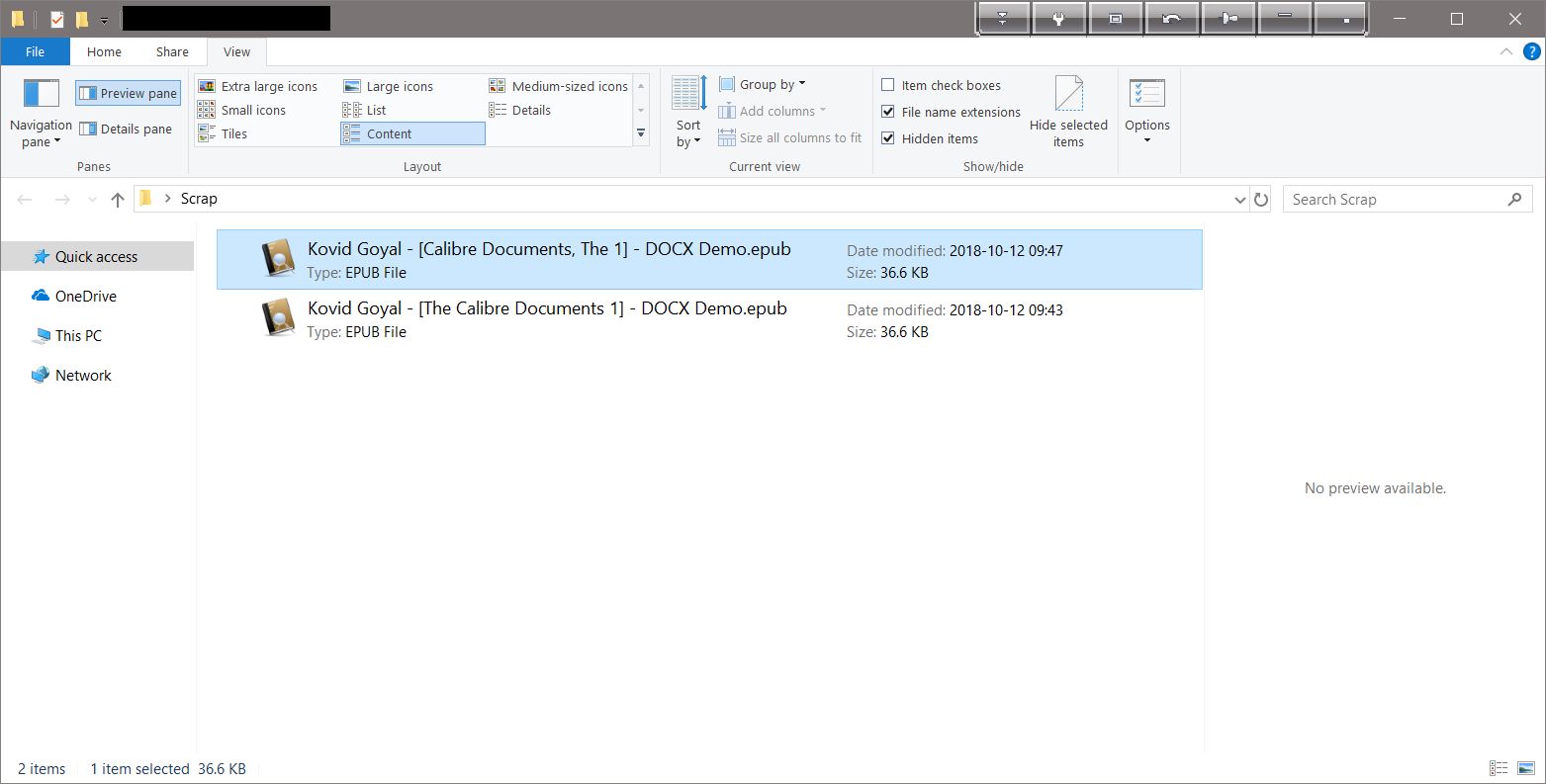

Just noticed that the template is moving the series article to the end after a comma. How do I stop it doing that?
For example in Calibre my series name displays as:
The Series [3]
A Series [2]
An Awful Series [1]
(I think I turned appending the article off in Tweaks once long ago)
But the template above saves as:
- [Awful Series, An 1] -
Vortex is offline   Reply With Quote

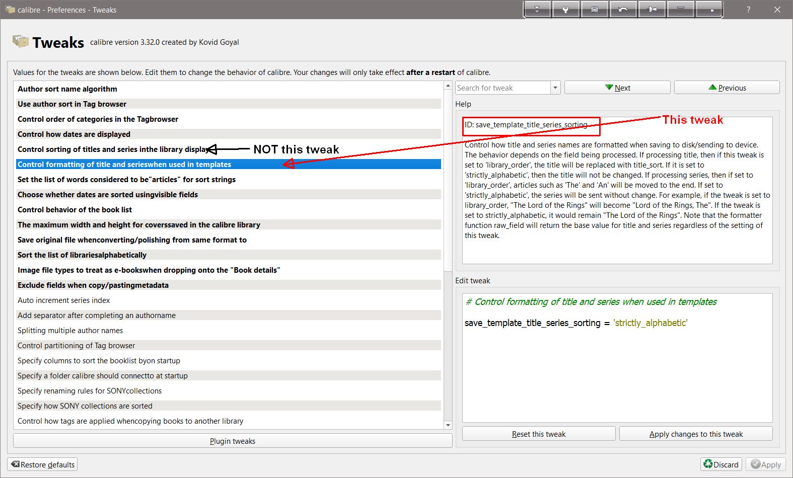

Set this Save as tweak to 'strictly_alphabetic'
You maybe thinking of the Title/Series sorting tweak relating to articles

Thanks BR, Oddly It's still exporting with the series articles at the ends.
After making the change to the tweak I restarted calibre, and went back in to make sure it had stayed changed. Double checked that I had changed the correct tweak and re-tried it several times, but it's still exporting with appended series articles.

Old 10-11-2018, 06:59 PM   #10
Posts: 22,870
Karma: 34252730
Hmmm
Using library_order and strictly_alphabetical with this template
{authors} {series:| - [|} {series_index:||]} {title:| - |}
I get following when I save Epub to Disk:

Old 10-12-2018, 06:15 AM   #12
Vortex
Vortex began at the beginning.
Vortex's Avatar
Posts: 171
Device: Likebook Mars
Hmmm
Attachment 166865
I take it by 'library_order' you mean:
# Control sorting of titles and series in the library display
title_series_sorting = 'library_order'
That's how it's set.
Also is it 'strictly_alphabetical' or as you said yesterday 'strictly_alphabetic' ?
Neither makes any difference though.
Kovid Goyal - The Calibre Documents 1 - DOCX Demo.epub
saves as:
Kovid Goyal - [Calibre Documents, The 1] - DOCX Demo.epub

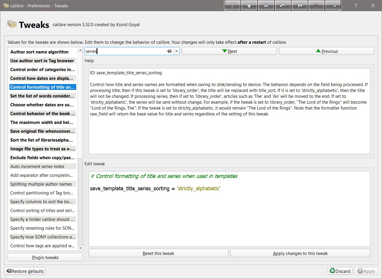

Old 10-12-2018, 06:25 AM   #13
JimmyR
ɴₐɴ
JimmyR ought to be getting tired of karma fortunes by now.JimmyR ought to be getting tired of karma fortunes by now.JimmyR ought to be getting tired of karma fortunes by now.JimmyR ought to be getting tired of karma fortunes by now.JimmyR ought to be getting tired of karma fortunes by now.JimmyR ought to be getting tired of karma fortunes by now.JimmyR ought to be getting tired of karma fortunes by now.JimmyR ought to be getting tired of karma fortunes by now.JimmyR ought to be getting tired of karma fortunes by now.JimmyR ought to be getting tired of karma fortunes by now.JimmyR ought to be getting tired of karma fortunes by now.
JimmyR's Avatar
Posts: 421
Karma: 2508026
Join Date: Jun 2011
Location: 37.2N 93.3W
Device: KV PW4 PW3 PW2
# Control formatting of title and series when used in templates
save_template_title_series_sorting = 'strictly_alphabetic'
Edit: BR already posted this...
Make sure you are changing save_template_title_series_sorting
JimmyR is offline   Reply With Quote
Old 10-12-2018, 07:01 AM   #14
Posts: 22,870
Karma: 34252730

Old 10-12-2018, 10:16 AM   #15
Vortex
Vortex's Avatar
Posts: 171
Hmmm
Attachment 166865
You asked if I was using 'library_order' and 'strictly_alphabetical', but you didn't specify which tweak 'library_order' referred to, so I was trying to clarify.
These are my settings for those 2 Tweaks:
Still saving to disk with the appended articles in the filenames.
