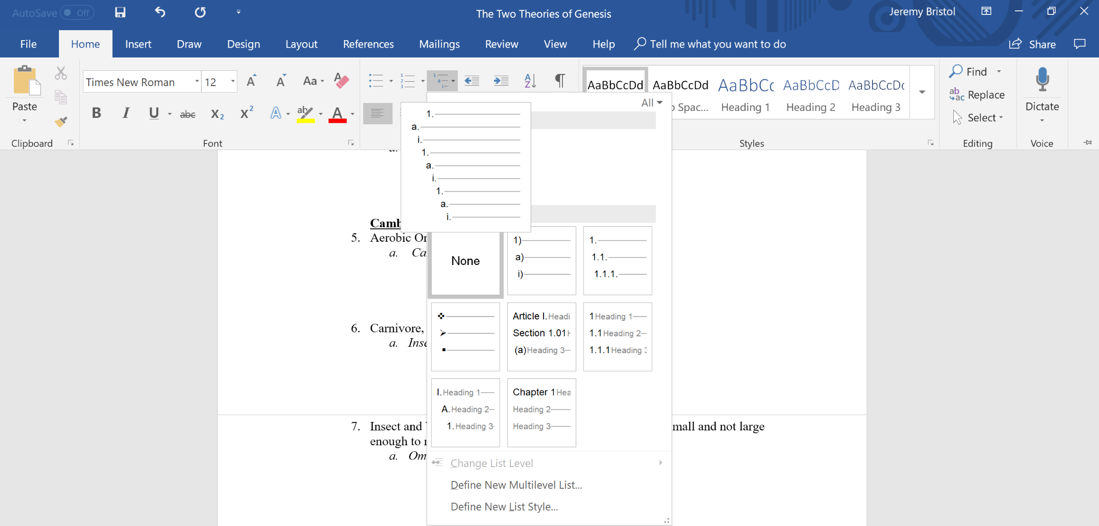

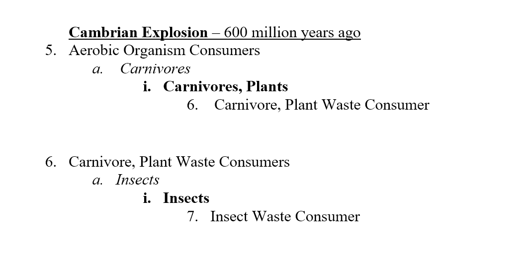

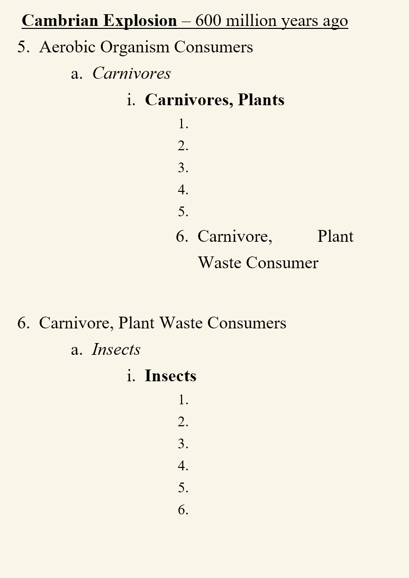

Please, see the attached pictures. The first picture, Pic 1, is the incorrect Ebook conversion, and the second picture, Pic 2, is the native Word Doc (what I would desire to be the output). I used special bullet points, seen in the third picture, Pic 3, and the forth picture, Pic 4. I use the default settings on Calibre to convert from Word Doc to Ebook. I don't think this is a bug.

that's a weird docx file. How did you generate it? It contains empty list items instead of just a single list item starting the numbering with an offset. Word does not display those empty list items, so you get the effective appearance of a single list tiem starting numbering at the offset.
Generate your lists, normally and you should be fine. I could look into having the conversion engine detect this peculiar markup (empty list items) and special case them, but that will take a while.

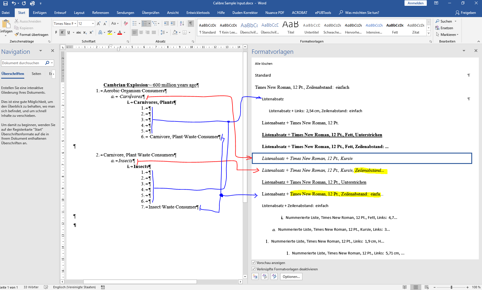

I took a quick look at your document. I recognize an other point in your document. You are aware of different format setups for same list elements? (see attached picture)

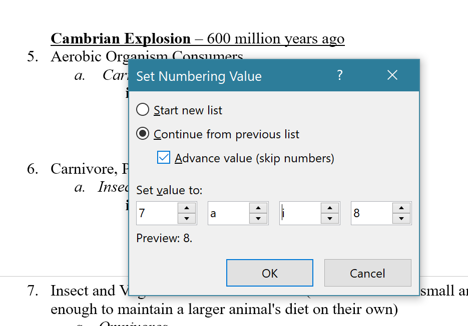

@kovid To generate this, I double click on the number, then right click on the highlighted number, then click "Set Numbering Value...", then click "Continue from previous list", then "Advance value, skip numbers", then change the value.

@Divingduck I do not know what a documented switch is, but I will look further into that too. And, I was unaware of the different format setups in your picture.
