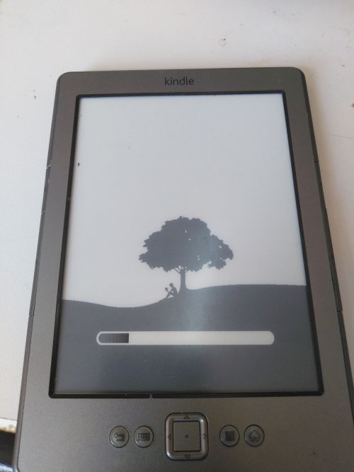

Hi there.
I would much appreciate if you could help me to de-brick my kindle.
Recently, I broke the native display on my K4 NT. Then I ordered and istalled it, while asembling the buttons back, I tored the signal loop from button.
Ok found a donor an local market (with broken display), removed it at put my new display into that Kindle.
Booted. This Kindle was not unjailed, so I applied a jailbreak (unfortunately I dont remember the exact name of this jailbreak, it was taken from the first URL in google search).
After reboot it stucked at Tree logo with approx. 1/4 of progress bar.
What I also did:
1) Kubrick - every step was successfully done, no result.
2) The device is visible from Mfg/fastboot/USB net, Diag page also works.
3) Manual de-bricking - no result.
Any suggestions? Thanks in advance.

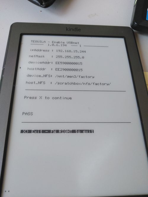

actual pics:

Short of re-flashing a main part+kernel from diags, there's not really anything much you can do...
EDIT: Besides monitoring the main boot process over serial.
