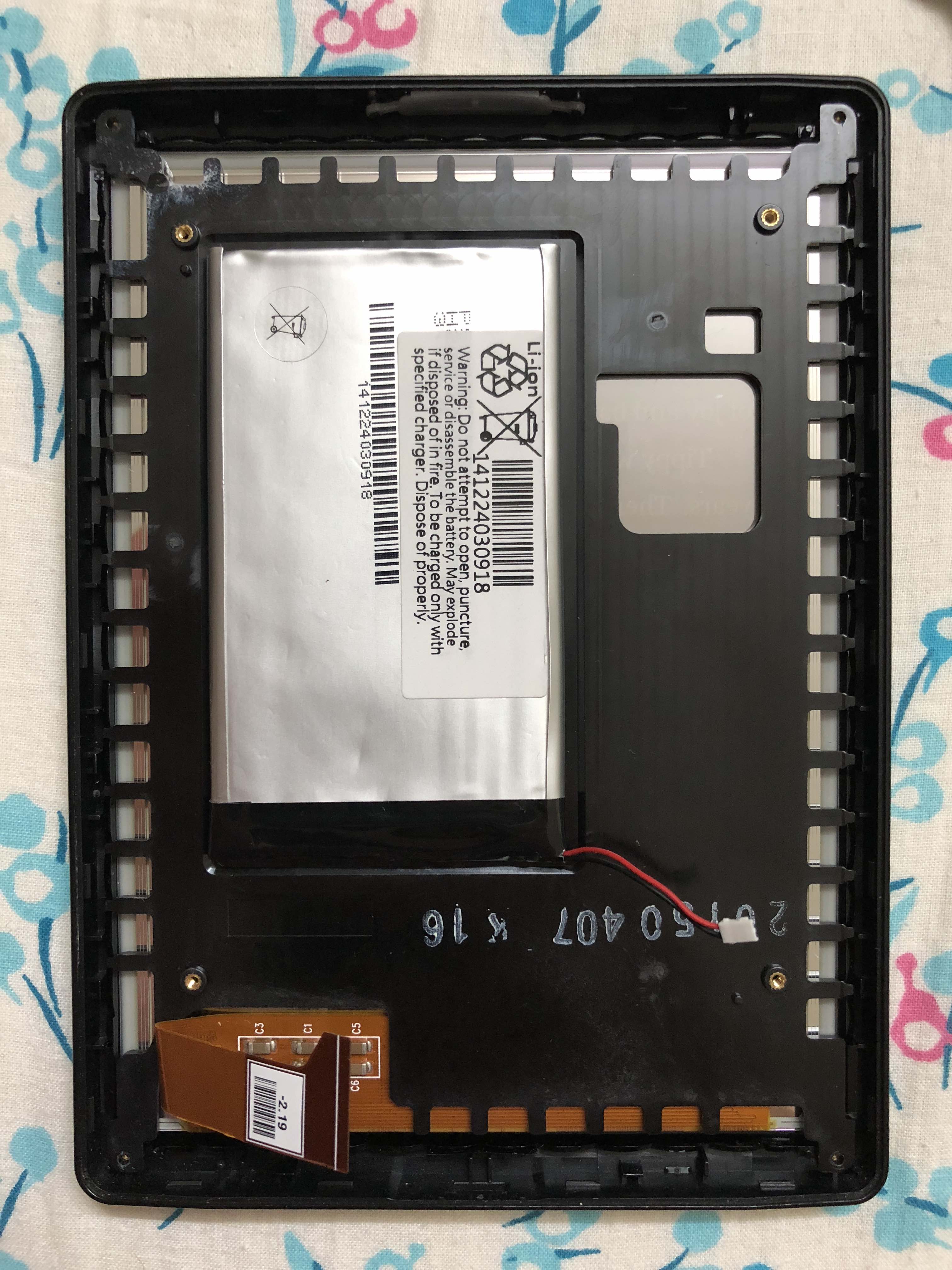

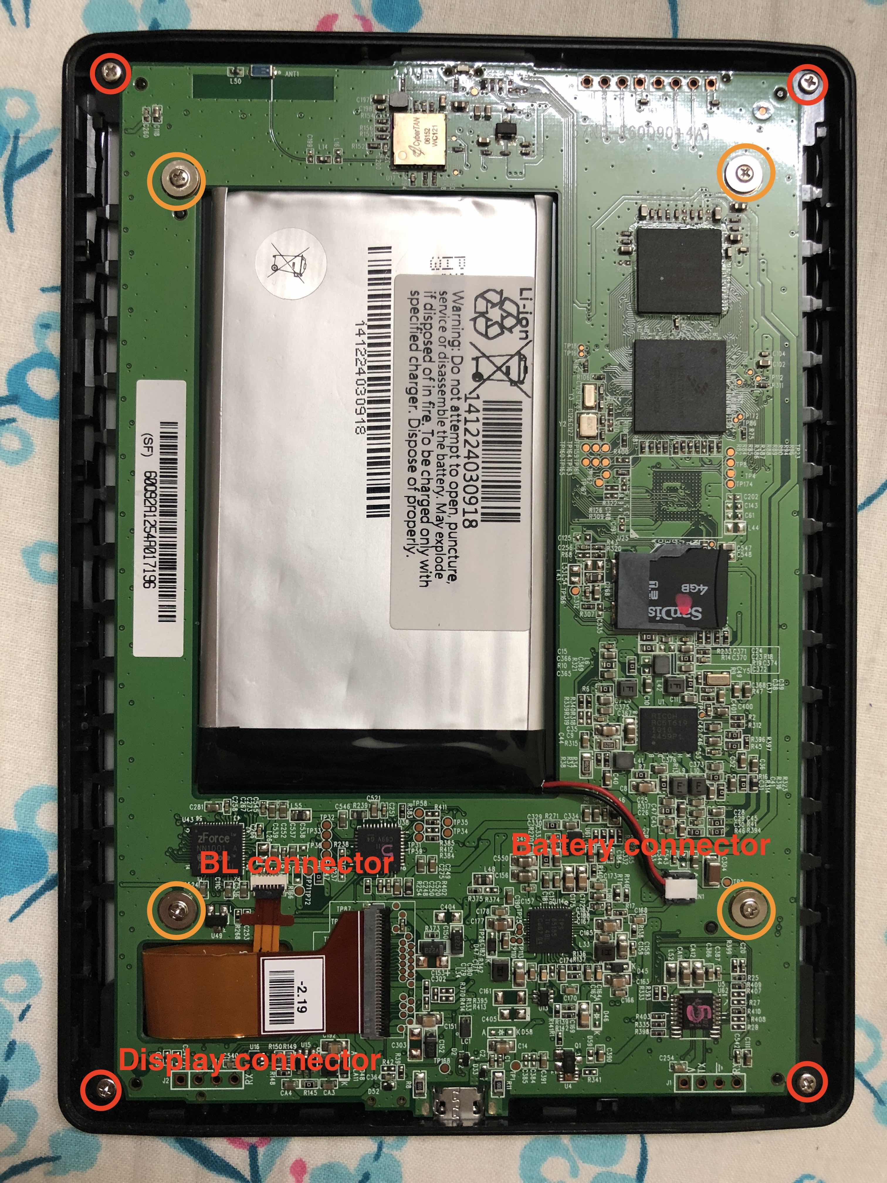

Step 1:
Pry open the back of the reader. Remove the four screws holding the mainboard to the display, and the four screws holding the display assembly to the chassis. Disconnect the battery connector and the frontlight and display ZIF
Step 2:
Lift away the mainboard from the display. Gently but firmly push the display from the front, to separate the display assembly from the chassis (be careful not to break the glass in this step.

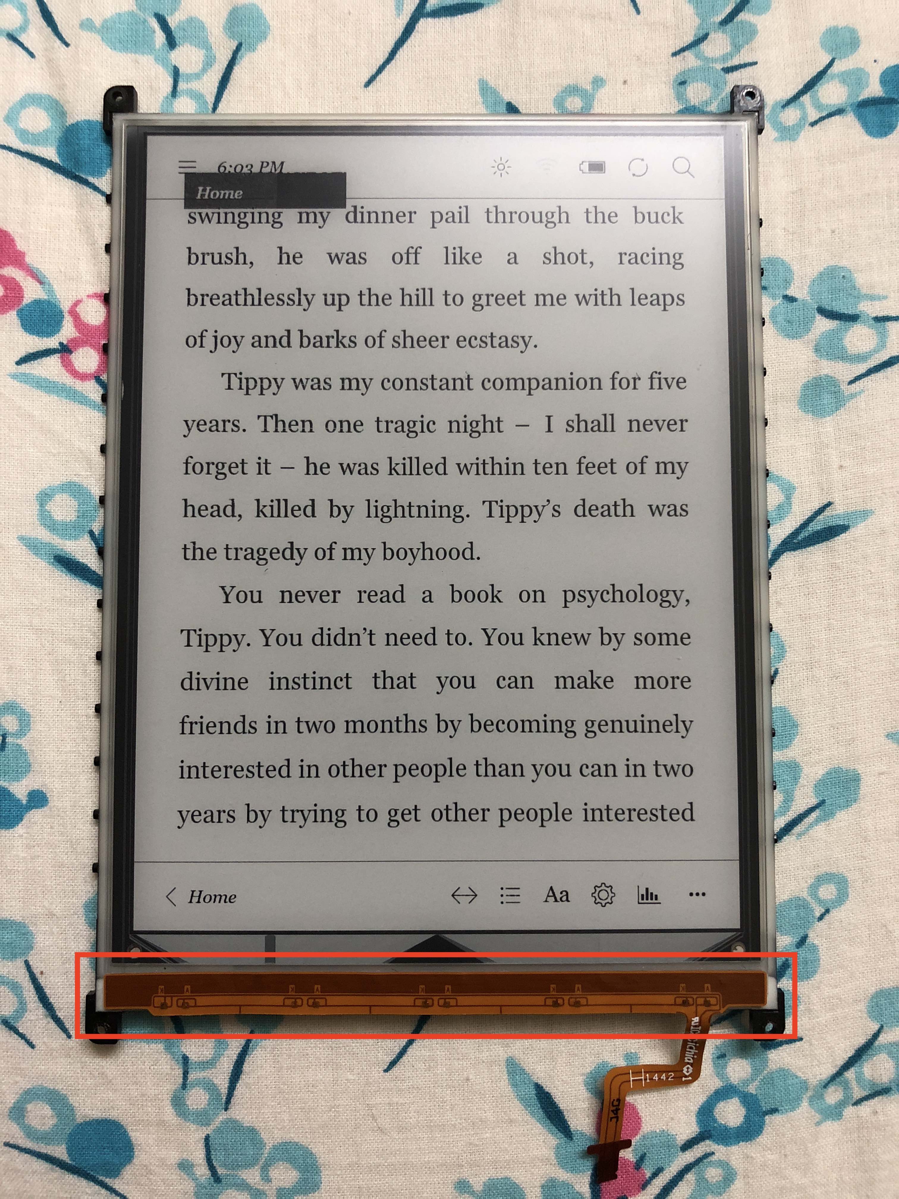

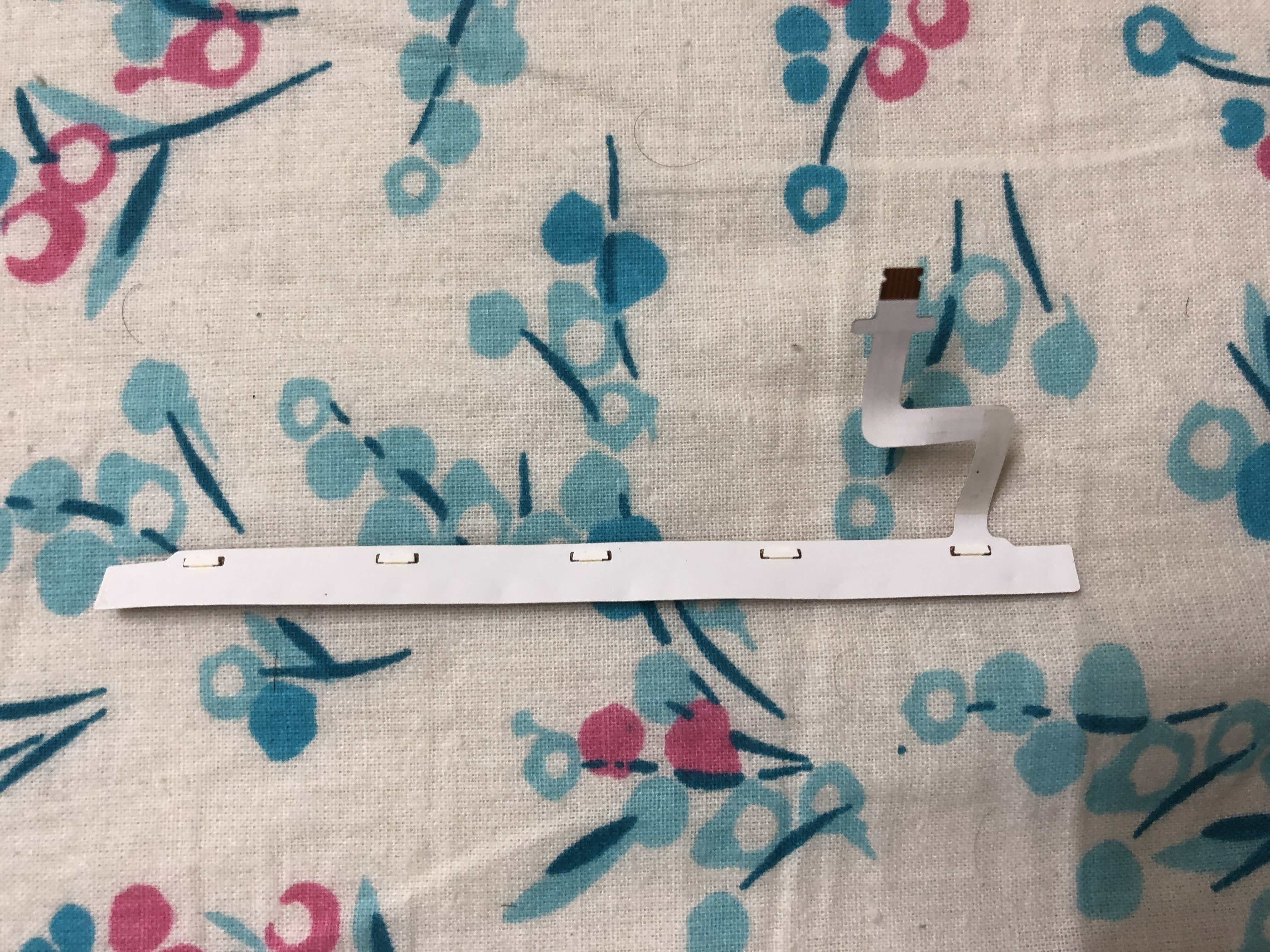

Step 3:
Peel away the frontlight flex from the display. Desolder the white LED from the flex (SMD rework tweezers are very useful here), and replace with the desired LEDs. I used the LED part number SMS1105OC from digikey and I know it roughly fits, you can use this or any other similar part.

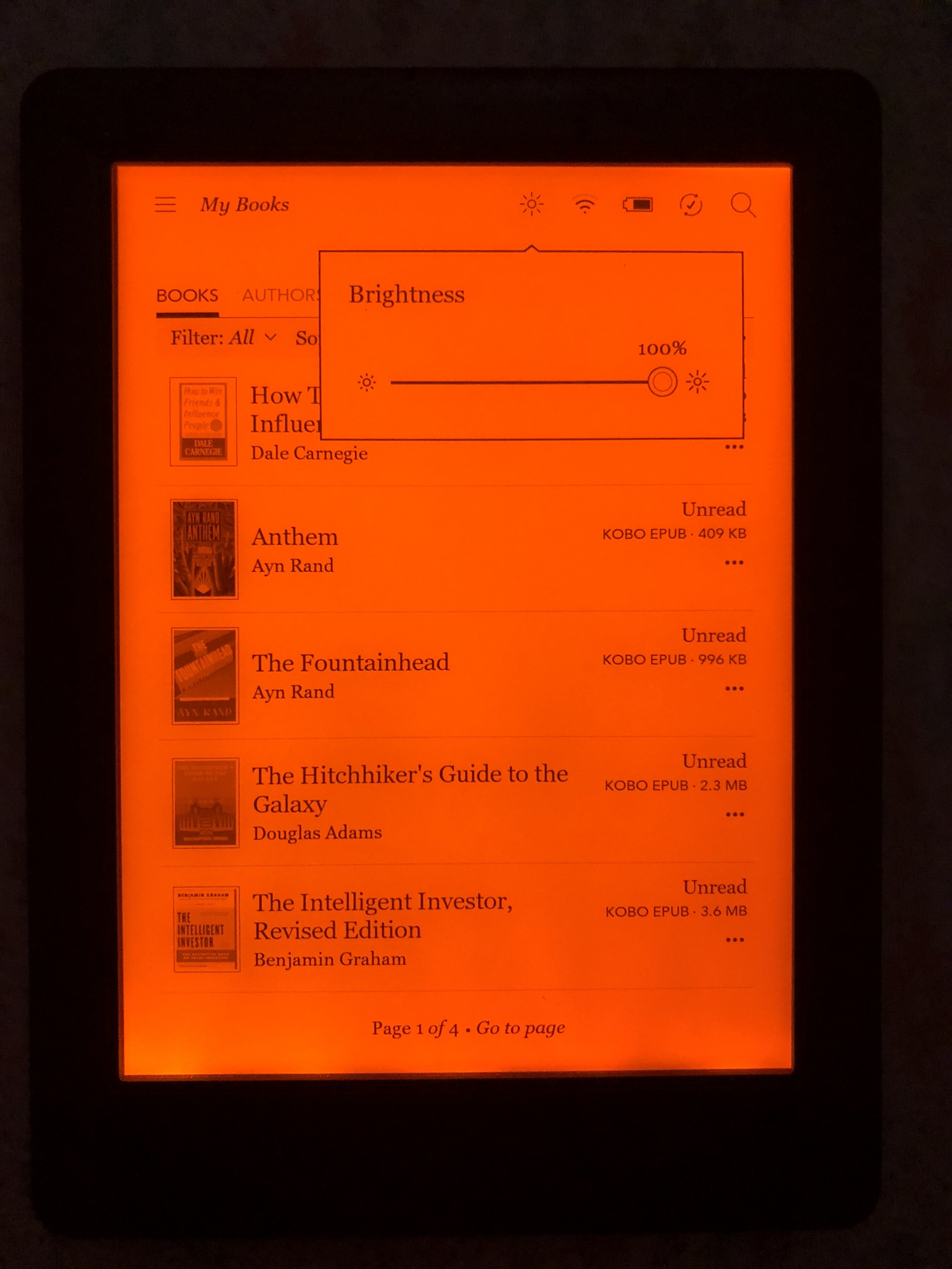

Final thoughts -
The orange LED also has a lower voltage drop than the white. However since the series LED driver (presumably) operates in constant current mode, we can drop in the orange LED without burning them.
As you can also see in the final image, the front is less brighter than the original white light. This is due to the orange LED having a lower brightness rating than the white (almost by a factor of 10, couple of 100 mcd for the orange LED vs 2000+ mcd for typical WLED). However this is okay since I dont use the light at max brightness but at a small fraction.
