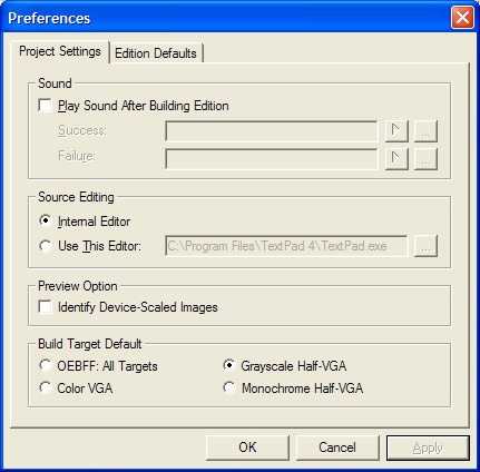

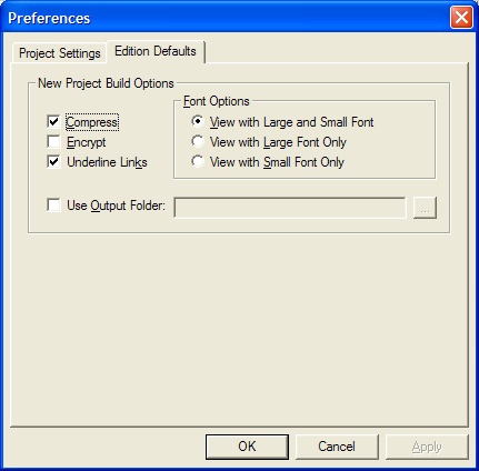

In eBook Publisher, my defaults are set per the images below. Just set your preferences using File | Preferences... once and then you will always have them for New projects.
However, note that the .opf can (and will) override these settings, so double check when you use lit2sb.
