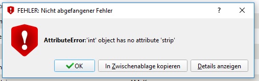

Dear all,
I have been using Calibre succesfully and gratefuly for several years now.
Currently I am running the latest version 3.25.0 64bit on my Windows 10 machine.
My database had been growing over the past years and I didn't encounter any issue. But since ~May this year I am suddenly having issues with editing metadata.
When I press the edit metadata button, attached error message will appear. Irrespective of the type of ebook format, age of entry (existing or new) etc.
This didn't happen before on the same machine with same OS etc. Only Calibre might have been a previous version.
I already tried to remove and clean Calibre and install freshly without success.
Kindly ask the expert for a hint what it could be and ideally for some support how to solve.
Thx!
Kind regards, hornetoli

That is a bug, but you must run Calibre in Debug Mode to capture the debugging information. Post that log file back here so the bug's owner can fix it. Hover your mouse under Preferences to see the Debug Mode restart option. After restarting, cause that error several times with different books, then exit from Calibre. Save the log that is displayed.

That's an interesting error, it indicates something really weird has happened to you database, it has number in the series column instead of text for some books. Attach the metadata.db file from your calibre library folder and I could tell you more.

THanks, I'll take a look at it when I have a moment, in the meantime, you can probably recover your database using the Library maintenance restore database tool.
Right click the calibre icon on the main toolbar in the calibre window, choose library maintenance and restore database.

thx a lot - worked like a charm!
Restoration seems completed with only few warnings / errors:
calibre, version 3.25.0
ACHTUNG: Erfolgreich: Wiederherstellung der Datenbank wurde erfolgreich mit einigen Warnungen durchgeführt. Klicken Sie für weitere Informationen auf "Details anzeigen". Die alte Datenbank wurde unter folgendem Namen gespeichert: E:\Calibre Library\Komplett\metadata_pre_restore.db

I took a look at the db file and it looks like database corruption, there are basically a few entries in the series table with very high id numbers and nueric values for the series name. Sadly there's no way to know how they got into the database. Keep any eye out, if it recurs, try to narrow down what yu were doing just before the problem happened.
