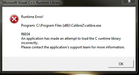

Hi,
I just installed Calibre 3.23.0 and now I get a C++ runtime error upon startup.
(See attached).
Help?

If you click ok on the popup, does calibre continue to load or do you get another popup?
Was this a new install of calibre or was it an upgrade from an earlier version? If it was an upgrade from an earlier version, I would suggest uninstalling calibre and then deleting the Calibre2 directory from Program Files. This will not affect your calibre data. After the uninstall, re-install calibre.
If it was a clean install, the first possibility that comes to mind is that you have more than one install of a Microsoft C++ library or that you have a missing install of a Microsoft C++ library. I've seen both trigger that error message.

Which version of Windows are you running?
In this case it should be - ". . . delete the Calibre2 directory from Program Files (X86)".
But I'd suggest the OP uninstall it via the Control Panel Programs and Features applet, that should clean-up the Trusted installer related registry entries.

Problem solved.
First, I un-installed all previous versions of Microsoft Visual C++ (2005 thru 2012).
Second, I deleted the Calibre2 directory, as advised above.
Voila!
Calibre now launches without issues.
