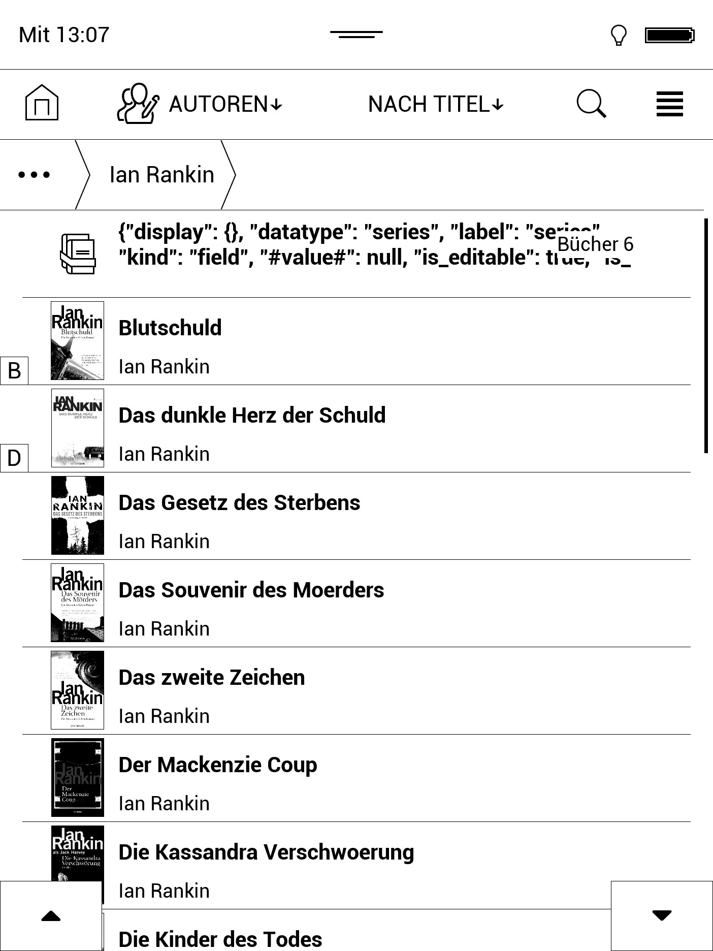

I usually fill my eReaders with calibre. InkPad 3 (PB740) shows a peculiar handling of metadata: most of the time it takes the series information from calibre and displays it in the library view correctly.
However - when transferring single titles (no series information in calibre) it shows a strange behaviour:

Most of the titles above are scanned and converted into epub. The author information is garbled and contains either internal information or points to a series I did not insert in my calibre meta data (e.g. Arcot, Wade, Morey - 1).
If you look at the last line of the screen you see a correctly transferred title, author and series meta data.
Any idea?

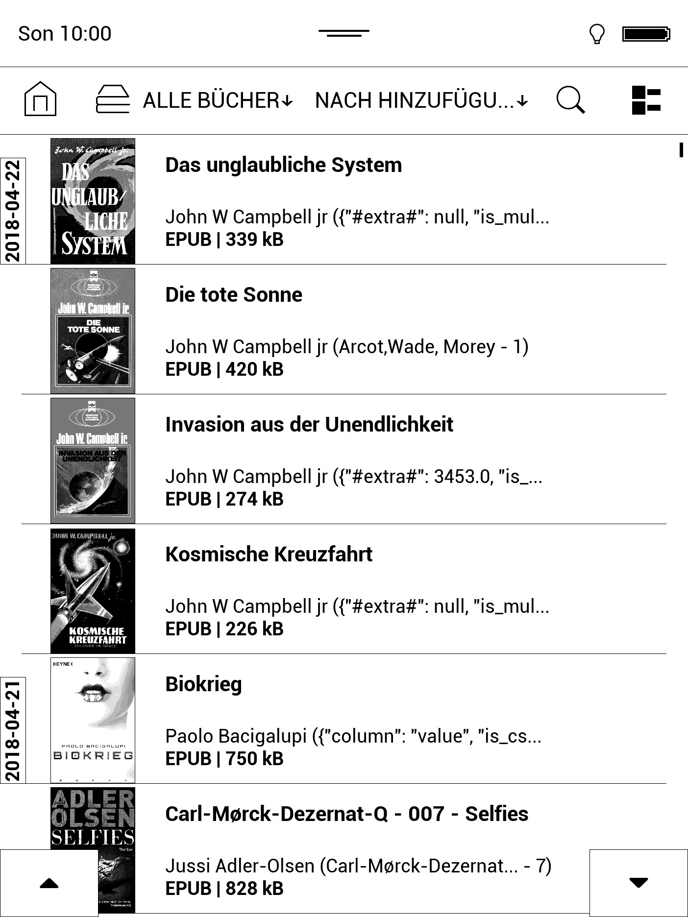

Another strange behaviour: it sometimes happens that not all titles within a series are recognized by the EP3. The attached sample shows that only title #4 is checked.
I looked into the metadata of all titles (Sigil) and do not see any difference in the way the series information is represented.

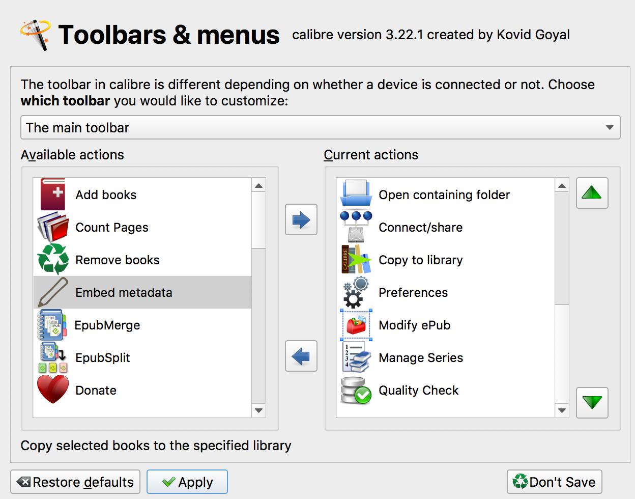

You can add the "embed metadata" button manually to the toolbar:
Go to preferences, in the interface section choose "Toolbars & menus", choose the main toolbar (or any other option you prefer). Now you can add selected options to the toolbar, e.g. "embed metadata".
For some reason not all metadata are embedded during the transfer, so I always carry out these steps:

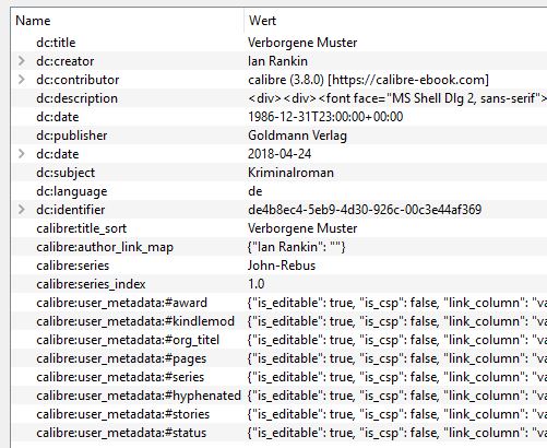

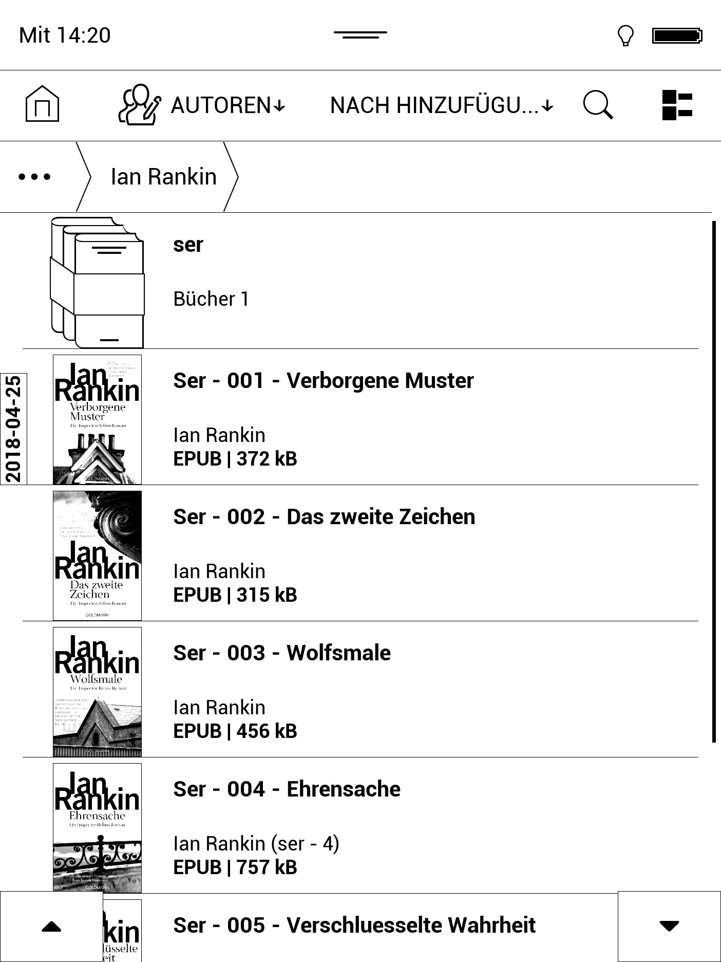

I installed the embed button but that did not work. I am not shure if calibre did not touch the epub again during file transfer rewriting evreything.
As I wanted to see who is the culprit I set up a test scenario:
  • I removed any non dc: metadata elements from my epubs within calibre with the plug-in "Modify epub options" (see metadata_calibre.jpg)
  • then I transferred all epubs directly (without calibre) to my IP3 to avoid "contamination" by calibre tagging
  • As you would expect: all files displayed correctly but without series information. No garbled information.
  • Then transferred the same files to IP3 directly by calibre: and again the IP3 reads out calibre metadata text with the word 'series' in it and displays it as a series element. Complete nonsense. (see scr001.jpg)
  • finally I tagged some series elements in calibre and transferred them to the IP3. Same situation as before - only one out of six items flagged as series title (see Metadata_calibre_series.jpg and scr002.jpg)
This is a complete mess!

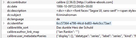

As long as we do not know how the IP3 generates/extracts the series information it will be very difficult.
There are three metadata lines which handle the series thing in my calibre metadate: calibre:series, calibre: series_index and further down calibre:user_metadata:#series (the way I setup the series on my system). Even in standalone titles without series the IP3 grabs the third line (which is always existing as a calibre:user attribute) and displays that content as the series name (see my scr001.jpg).
Either I have a fundamental problem with my calibre setup (since many years now) or IP3 is misinterpreting the delivered information.

[Solution] It works now
@trekk: writing down the few lines above I started to think why I need the third line (my own user data!) for the series thing. I had started to setup a series metadata approach long time ago when calibre had no solution for this - and when calibre's own series solution was released: I forgot about that user column because I never needed it any more. Shame on me!!!
Now: I deleted that user defined variable and updated the series titles metadata with the new calibre setup. Alas - now I have a correct display in the IP3.
All my other eReaders never complained about that additional line. remains the question why the IP3 is parsing that specific addtl line.

So the pocketbook-firmware really doesn't like twisted series metadata.
Problem: Sigil does this twisting (content="" first, followed by name="") regularly - every time you open a book with sigil, the metadata are twisted.
And Calibre doesn't care. If you later load the book (with twisted series-info) on the reader via calibre, the metadata stay twisted. (the polish book function also doesn't correct twisted data).
Solution for that problem is: if you touched a book with sigil, you should use calibre and the modify epub-plugin and delete non-dc:metadata. After that you can use polish book for re-adding the metadata.
Klecks.
