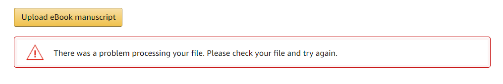

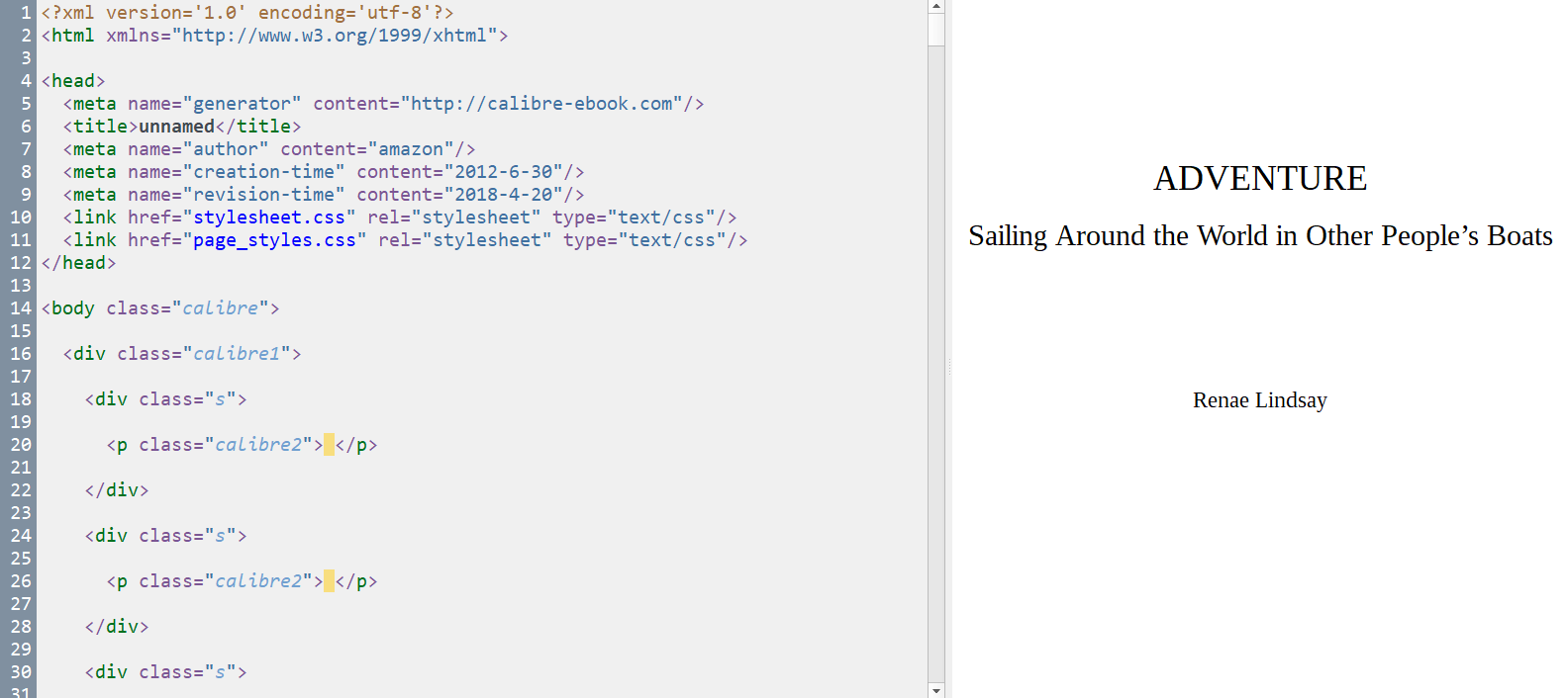

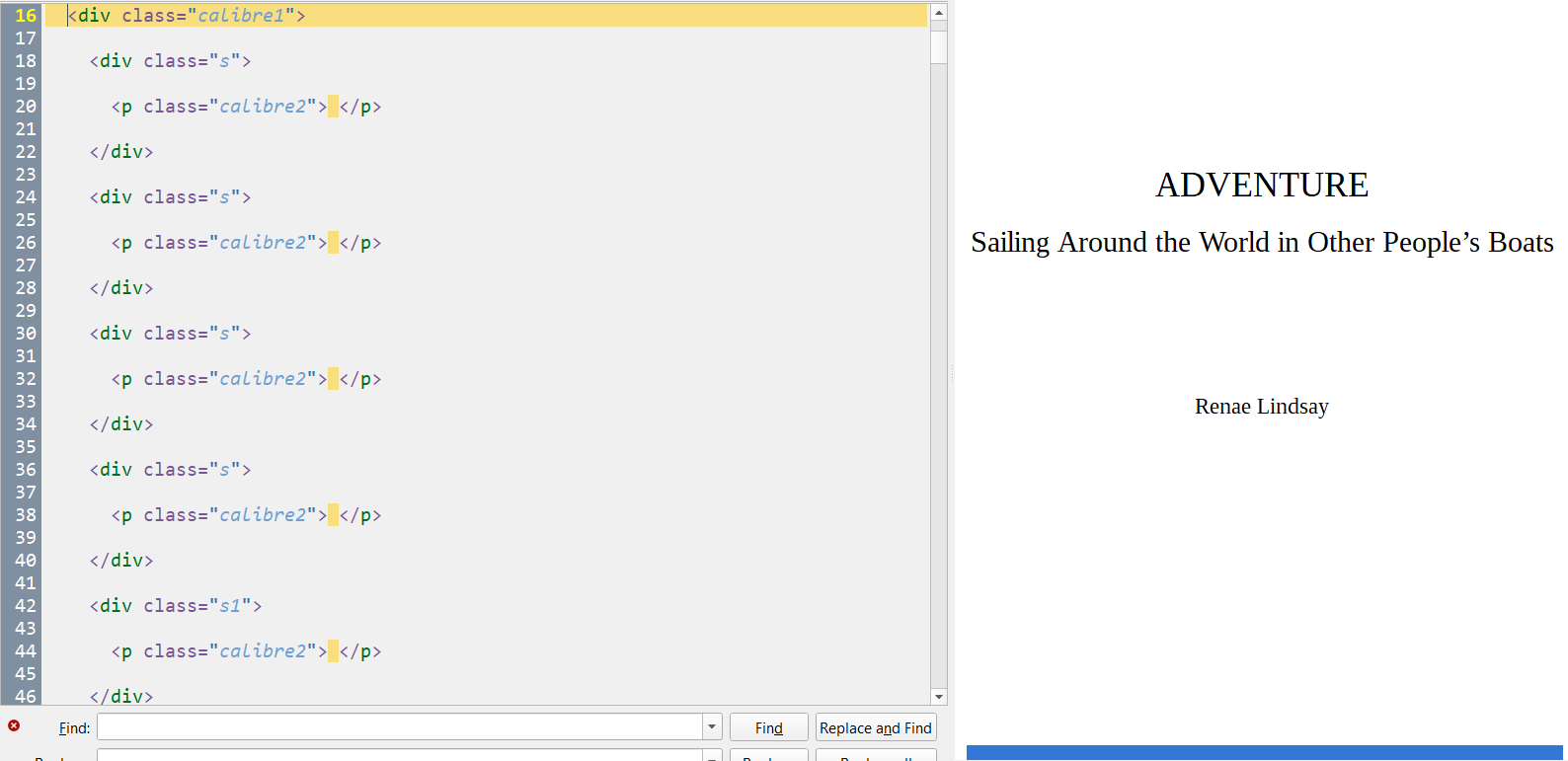

Okay so
First two are examples of what I'm looking at when I'm trying to edit it in Calibre. The third one is KDP's response when I try to upload anything with the page break code above.
The text sample contains the biggest part of my issue. It splits the table of contents in half every time, despite there being plenty of room for it. This sample doesn't have the manual page breaks I had been using for the full document, I actually removed them in the hopes that it would simplify what I was looking at in Calibre so I could put the page breaks back in myself (seeing as it was largely ignoring them anyway).

I had a quick look at the rtf and the calibre conversion to epub. Calibre's viewer was not happy with the table of contents until I increased the width.
Basically, I would forget about formatting for a page size -- epub is generally used for reflowable books in contrast to PDF which is page oriented. What I saw as a more serious issue is that the sections are not separated into separate text files. I did a quick manual split on the original file removing a lot of the blank lines used to separate pages in the rtf. For the table of contents, the page number are iffy and you might want to make the text a link instead of plain text (I added a sample link for the Introduction).
