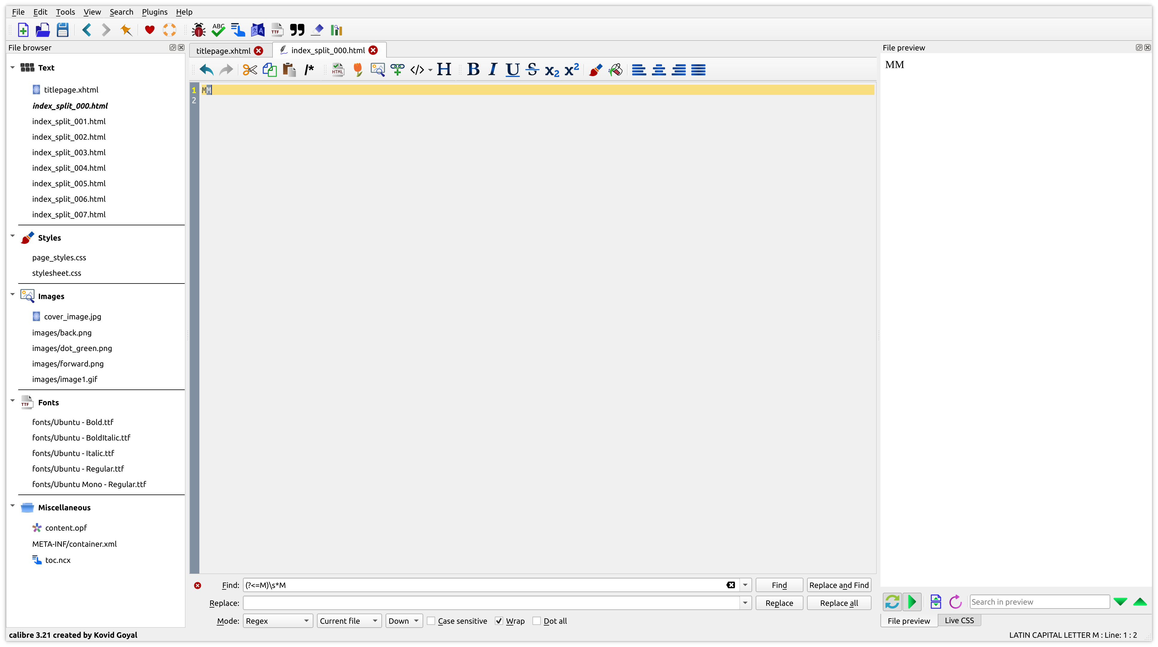

Old 04-08-2018, 10:59 PM   #2
Posts: 46,618
Karma: 29634066
Works for me.

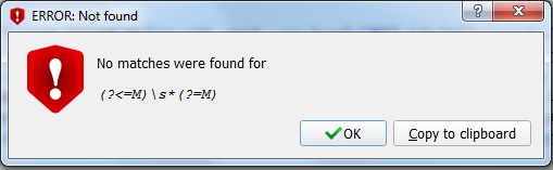

Old 04-09-2018, 03:53 AM   #3
DrChiper
Bookish
DrChiper ought to be getting tired of karma fortunes by now.DrChiper ought to be getting tired of karma fortunes by now.DrChiper ought to be getting tired of karma fortunes by now.DrChiper ought to be getting tired of karma fortunes by now.DrChiper ought to be getting tired of karma fortunes by now.DrChiper ought to be getting tired of karma fortunes by now.DrChiper ought to be getting tired of karma fortunes by now.DrChiper ought to be getting tired of karma fortunes by now.DrChiper ought to be getting tired of karma fortunes by now.DrChiper ought to be getting tired of karma fortunes by now.DrChiper ought to be getting tired of karma fortunes by now.
DrChiper's Avatar
Posts: 1,071
Karma: 2019904
Join Date: Jun 2011
Device: PC, t1, t2, t3, Clara BW, Clara HD, Libra 2, Libra Color, Nxtpaper 11
Hi Kovid, you are absolutely right: (?<=M)\*M works.
But, that is not the expression I used
My expression also used a positive lookahead part
(?<=M)\s*(?=M)
which fails when \s* is empty. Further, when succeeding M<space>M text constructs are present after the very first MM construct, they are also not found, because the search is stopped immediately and the attached error message is displayed.
I use a text like: adasMMasd adssdM Masdda M Msad
Although my regex knowledge is limited, I cannot recall that there should be a limitation on the expected behavior when (assumed) greedy search would certainly be able to find the other M's ones.
Is there an explanation you know of?
Addation: I use the lookahead construct specifically in order to not "consume" the found text.
DrChiper is offline   Reply With Quote
