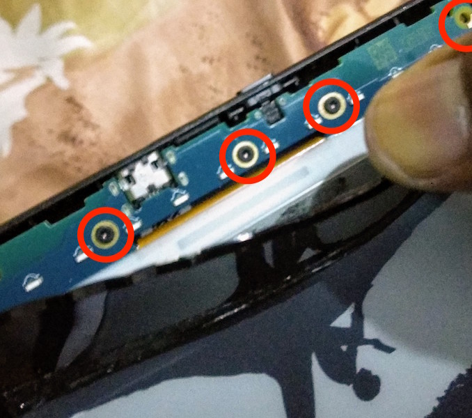

Suprisingly there are no teardown videos of KT3 on youtube , ifixit and even here. 2 people have made threads here achieving access to serial debug points.. one of them @02xda2 has even commented in this thread.

I'm stuck on the disassembly too, there were 2 screws in top corners, but i cant access more, 2 more are partly visible under the black glossy plastic that's over the screen.

There are 5 screws under the lower part of hard plate. it feels brittle and part of glass so i was afraid to flex it too much. But removing the 2sided tape below this hard plate will let you open the screws beneath it.
now I am looking for UART serial port config / polarity parity baudrate etc for this device. If anyone has any info please add , I searched more than I expected and still no clue ..
Nearest match is http://www.xodustech.com/guides/kind...te-demo-unlock
