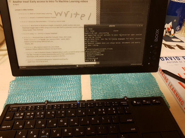

Nothing exciting to show yet, but attached, please find something...
