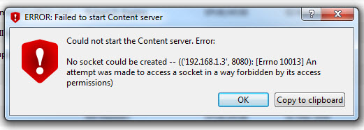

Cannot connect to server
I have searched for the answer and someone said to change the port but do not know how. My firewall already allows "the main calibre program" to access. It happened all of a sudden have been running it for years.
Name:	calibre error.jpg

Something is blocking calibre from running the server, most likely an antivirus program. Try temporarily disabling the antivirus and see if it works.

I just realized that I installed JIRA on my 8080 port yesterday! How can I change the Calibre port setting to something else?

Preferences->sharing over the net

Thanks!
