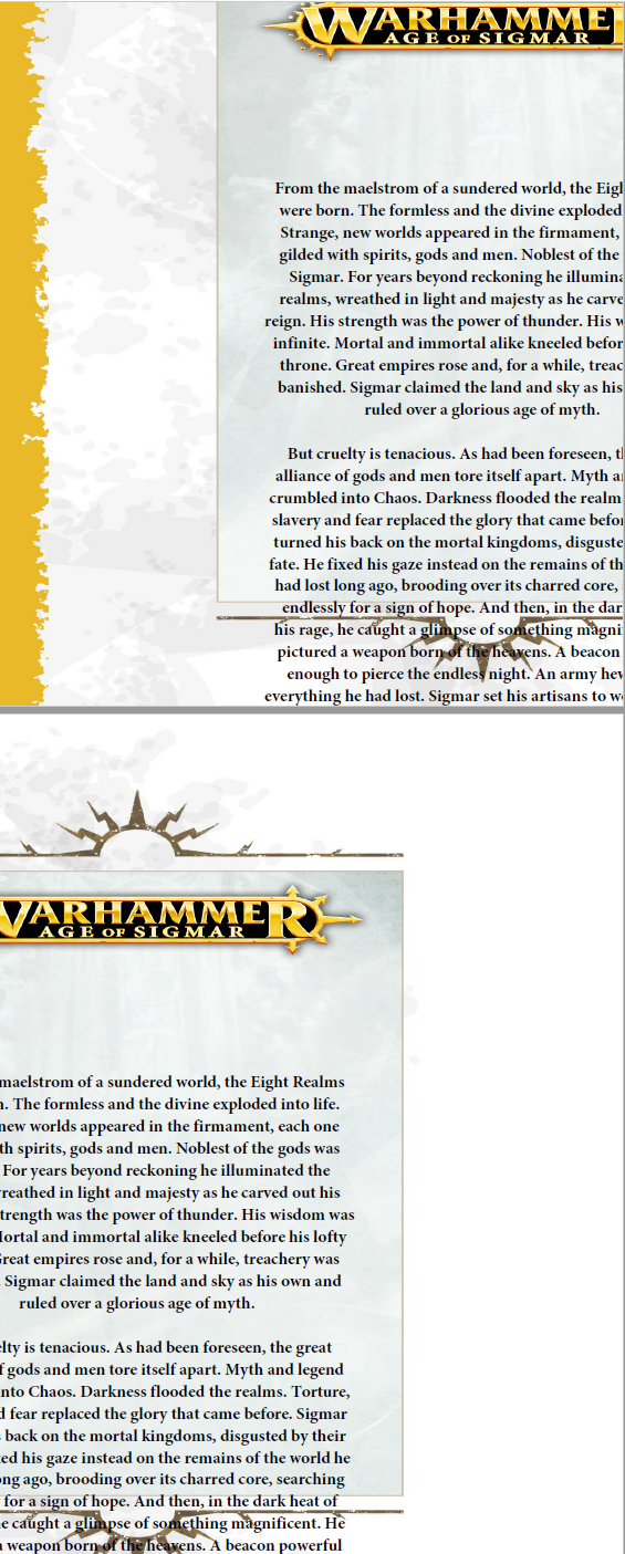

I've got a Warhammer epub that I've purchased from Warhammer digital and I wanted to convert it to a pdf but I'm running into problems.
The best I've managed to get so far is the attached ... The background image is over 2 pages (looks like it is too wide) and the text starts too low down and goes off the bottom of the page.
I've set the output pdf to a4 and set the margins to 1pt and the default font sizes to 12pt.
in Look and feel I've disabled font size rescaling. If I leave it enabled the text becomes little dots on the screen.
The epub loads fine in the viewer as long as I turn off resize images and select flow mode.
I've also attached the job info from the conversion process.
Any assistance would be greatly appreciated

Those are fixed layout EPUBs, calibre cannot convert them or even view them in paged mode.
