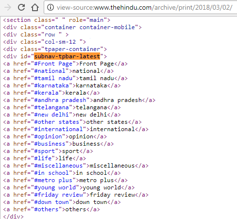

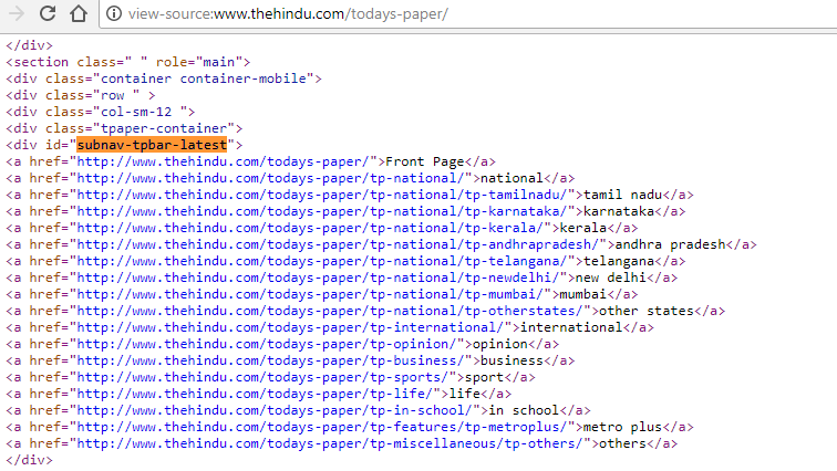

Hi, Thanks for the suggestion. I tried the modification as follows
# Modified on 2018Mar06 To download specific date paper
        soup = self.index_to_soup('http://www.thehindu.com/archive/print/2018/03/02/')
        #soup = self.index_to_soup('http://www.thehindu.com/todays-paper/')
        nav_div = soup.find(id='subnav-tpbar-latest')
        section_list = []
But Calibre is not downloading any article with the modification.
I have compared code of pages on 'todays-paper' and 'print/2018/03/02/' & it looks like the id = subnav-tpbar-latest contains complete URL in first case but only links in 2nd case which is causing Calibre to not able to find any article
I have attached Calibre logs with relevant screenshots. Requesting your further help in clarification if possible . Thanks

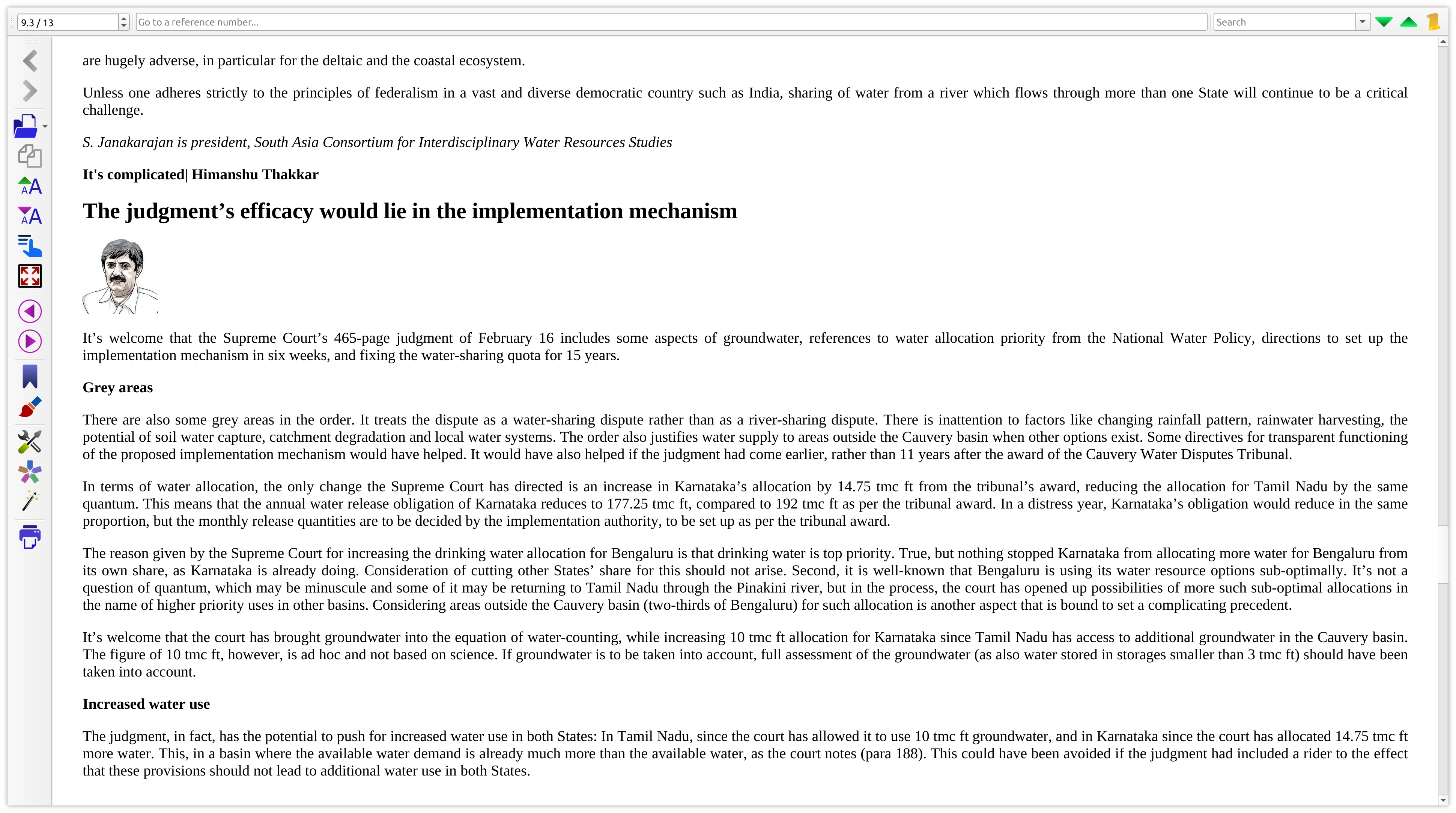

Posts: 45,699
Karma: 28549304
I just tried it and it works for me, see screenshot
Howwww !!!
Just now, I have removed the line 25 from the original recipe all together & kept everything same as original. Still I am not getting the other two parts...
Have you modified the original recipe or it was a trial code only ?
snji is offline   Reply With Quote
Old 03-09-2018, 04:01 AM   #9
Posts: 45,699
Karma: 28549304
Nope, no modifications.

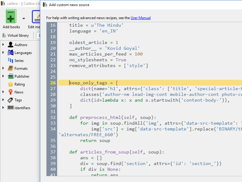

Same issue, only 1 of the 3 part getting downloaded and removing 25th line in code is not helping.
https://www.thehindu.com/opinion/op-...le24646941.ece
Only 'YES' part gets downloaded leaving 'NO', and 'it's complicated'.
0Arvind is offline   Reply With Quote

I'm not from IT background, but I tried removing the the code, ignore_duplicate_articles = {'title', 'url'}
It isn't working for me as well, I guess I'm missing something out there.
I have read your articles that you work 80 hours a week and you must be very busy, but if you can take out time to upload the recipe here with modifications, That would be helpful, or tweak the inbuilt recipe.
