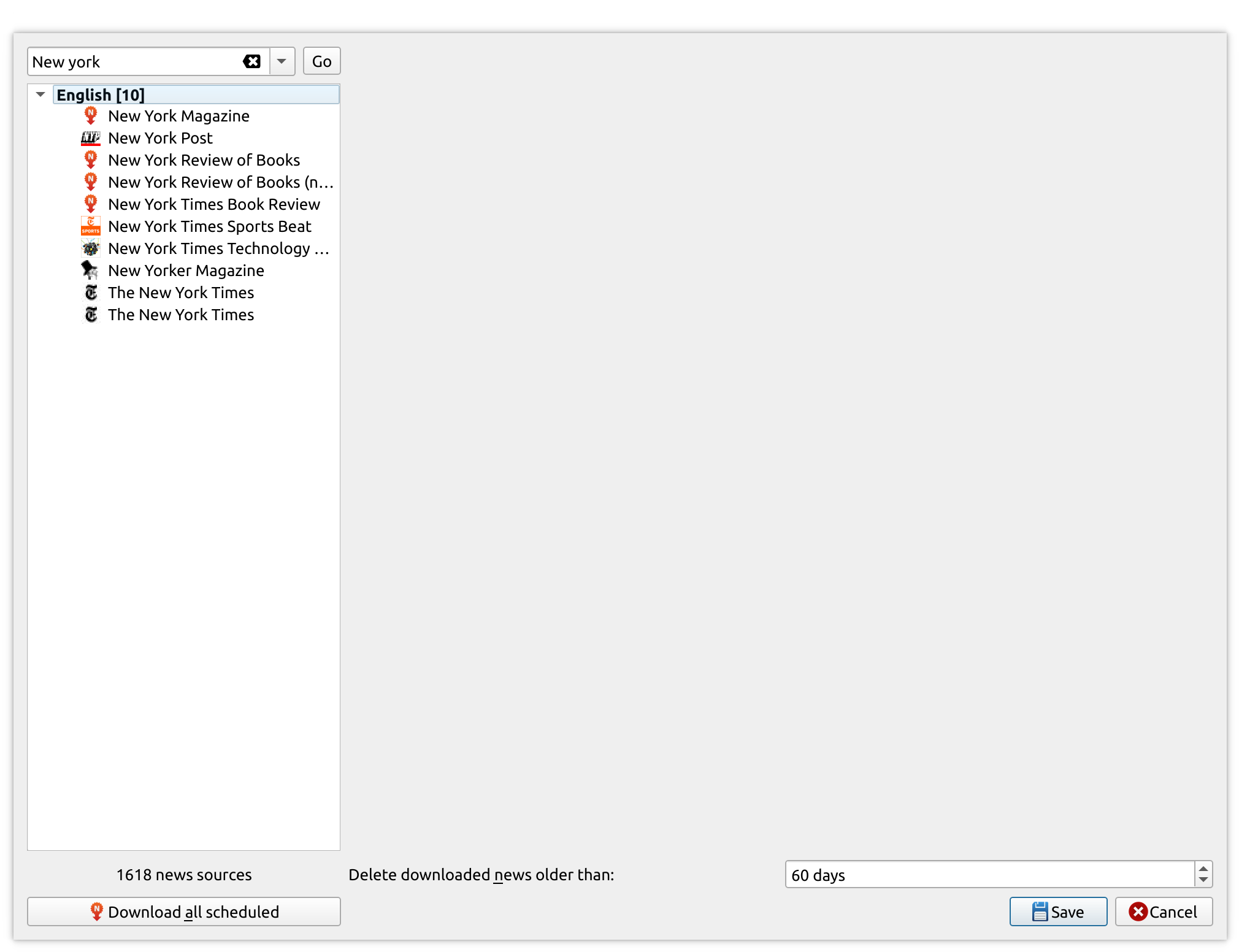

Just downloaded Calibre 3.17 (64-bit.) I saw in the change log that the New York Times recipe is improved. However, it is no longer an option in the 'schedule news download' option in 'Fetch news.' Where did it go?
Thanks.

@NSILMike: it is in the English section, where I think it always was.
Nope. And still isn't... something weird is going on?

It is for me:

It is for me:
Not for me...
