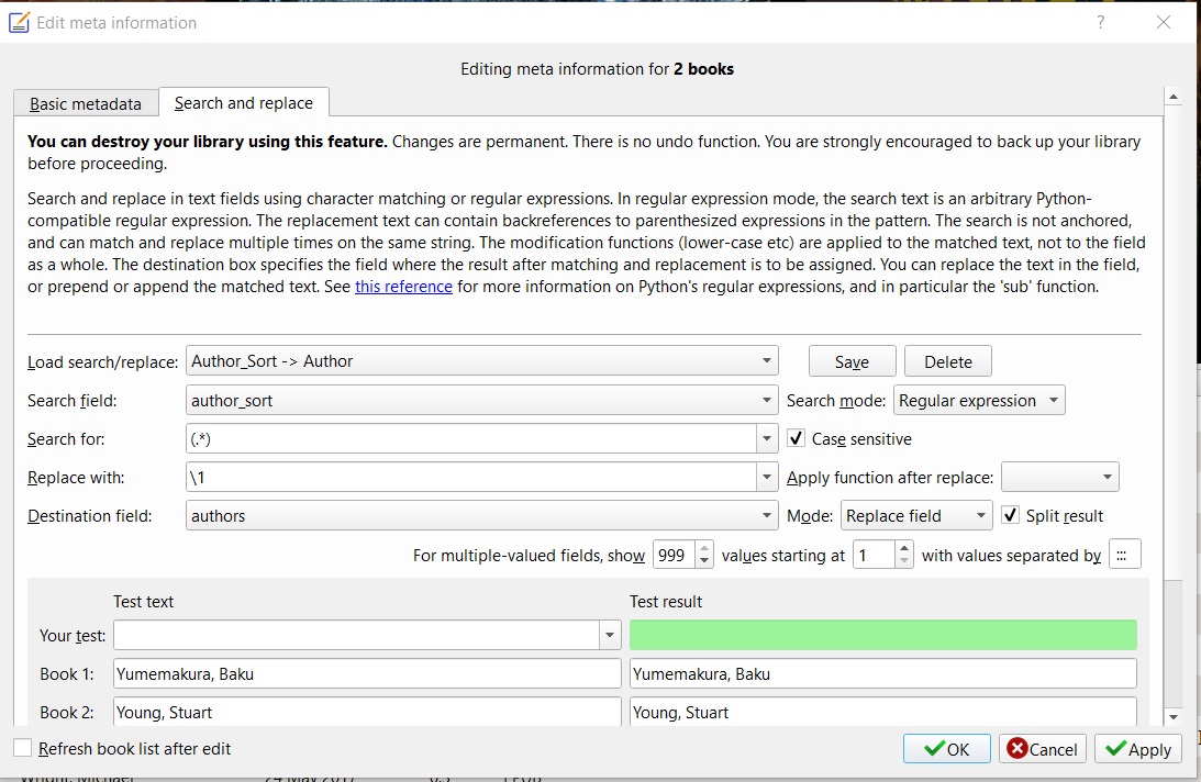

I too have been struggling with this, see attached jpg, I thought I was following the instructions but the result looks the same as the original.

My bad (I think. it should have worked)
(.*) says 0 or 1 of pattern
use
(.) everything

(.*) is correct as that means any length from 0 or more.
(.) matches exactly one character.
Isn't the screenshot the desired outcome?
The authors will be set to Yumemakura, Baku and Young, Stuart. The original value for authors I assume is Baku Yumemakura and Stuart Young.
The left side shows the original value for author_sort. The right side shows the value that will be stored in authors. In this case, you do want them to be the same.

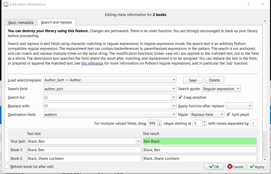

Sorry it's not what I'm after, I have hundreds of books where the Author field appears LN, FN but thousands where it is the right way round, what I would like is a function the same as when you edit books individually and can set author from author sort function. The attached image test is what I'm after not what it's actually doing.
Use the Quality check Plugin
2 parts (stages)
1)Quality Check:Check metadata: <undesired Author comma>
2a) Select all results
2b)Quality Check: Fix: Swap Author...
This sets both properly, as default Author_sort rules dictate
