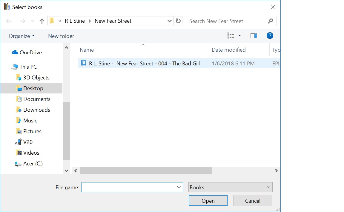

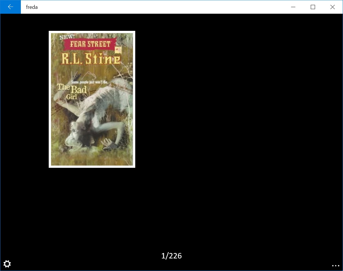

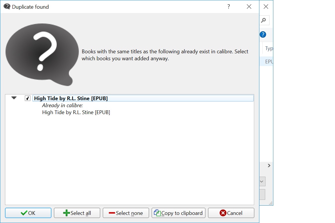

Hello all. Let me start by saying I am running calibre 3.15 34bit on win 10 64 bit (the 64 bit version did not work on this laptop). For some reason, Calibre has picked a book it likes and imports this book no matter what file selection I am doing.
Can anyone offer advise on how I can resolve this?

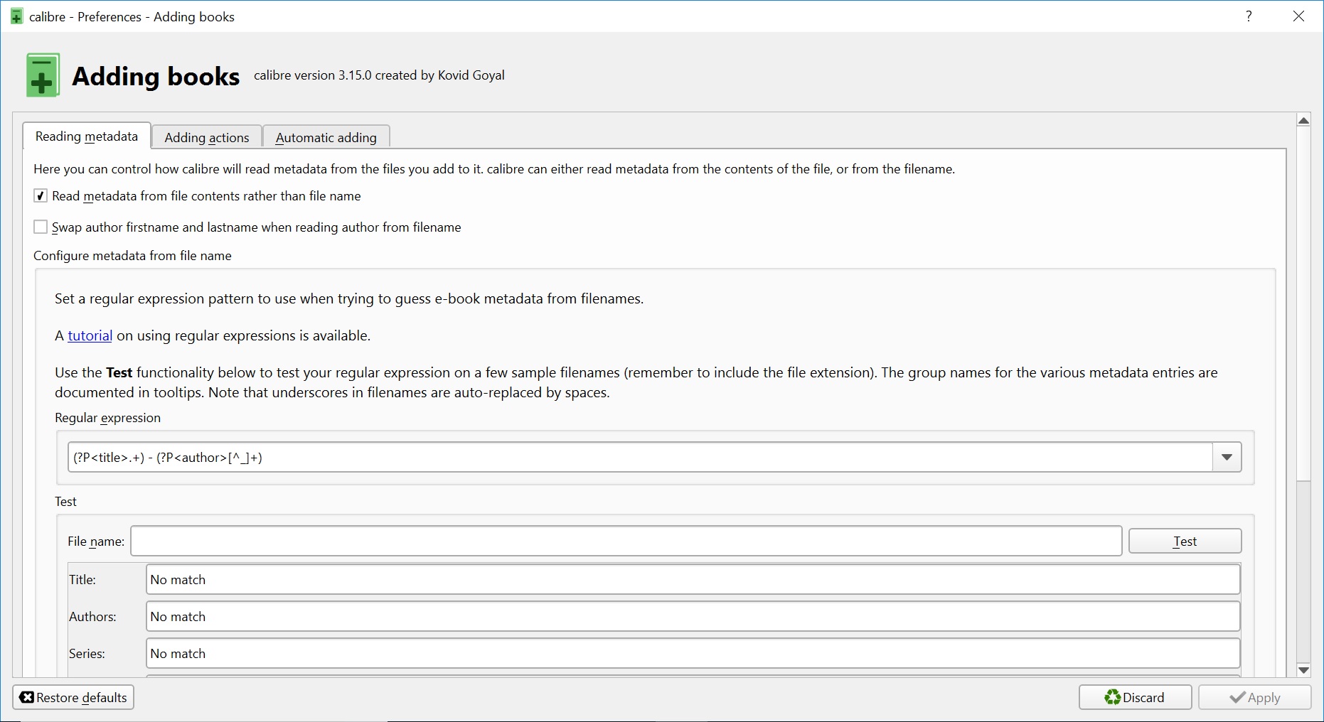

Thank you theducks. I will try to work on changing that to see how well it works. What disturbs me the most was that it actually pulled in the Epub file for the book that it seem to love, not the Epub file I was importing.
I fired up my win 8 & win 7 PC's that are running older versions of calibre. The files are imported correct and the corresponding epubs for the title is pulled in correctly as well.
EDIT: My add data setting is set up to read from the file name. Calibre still pulls an epub from a separate directory every time. This does not happen with the same files running on the other PCs with different windows versions.

Last edited by mixdcrysy; 01-07-2018 at 02:19 PM. Reason: Update: Settings are for read from file contents, but still pulls in a completely separate epub from another file directory

No it is not. Look at the first tick Which adds to the puzzle
Either there is NO internal metadata, or it is wrong (corrupt)
