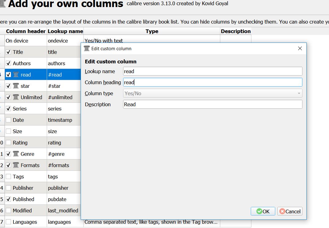

Not sure what you meant But here is my read column

#read is you column name
The type is Logical
If #read is True (show emblem chosen)

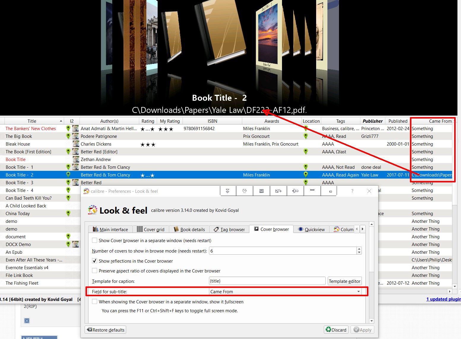

@Jo69 - did you try putting your read column into Preferences->Look and Feel->Cover Browser->Field for subtitle ?
There is no way to decorate the Cover browser with emblems, badges, crests, icons, emjois etc.

Originally Posted by Jo69 View Post
Sorry don't understand
I have created my read column
But was just wondering if at the top of the Cover Browser I could get rid of the book title under the book cover and get it to auto change to read, when I click yes in the read yes no column.
You cannot replace the Title, but you can show your Read column as a subtitle, viz:
Just put your Read column where I have Came From.
But if you change Read in the book list it won't change what's shown in the cover browser dynamically, you have to reselect the book in the book list (i.e. down arrow/up arrow).
