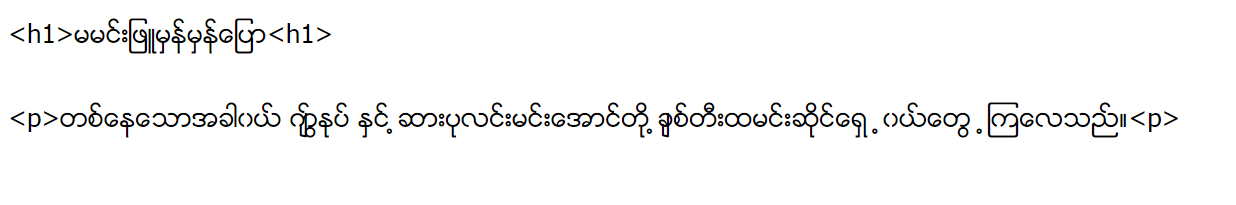

Hello everyone. I would like to ask you all a question. I am trying to create an epub file using my language (Burmese), but, it seems Sigils does not support my font. Is there any way to solve that issue?
This is my targeted result, and I typed those letters in notepad. When I copy those words to Sigils, it showed me like this.
Could you advice me how do I correct it? I don't have any knowledge in html or CSS. Thank you so much.

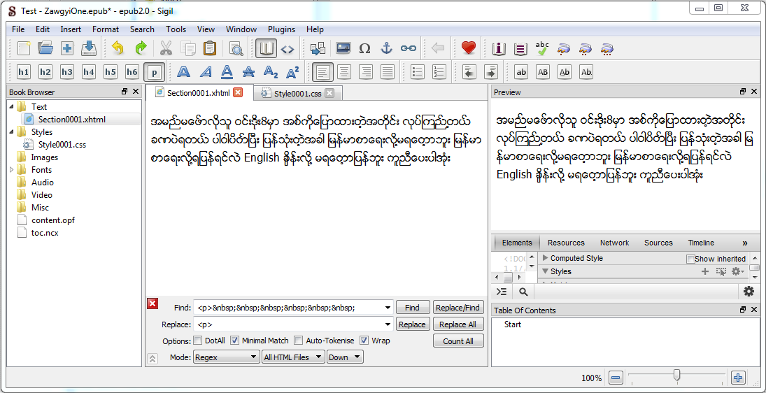

Have a look at the attached epub test file. I embedded your font, created a stylesheet and assigned your font as the body font. Then I picked some comment in what I beleive is Burmese from some website and put it in the body of the xhtml file. Looks Ok in Preview and Book View, but not in Code View...
Pablo is offline   Reply With Quote

Preview and Book View Ok - see attachment
