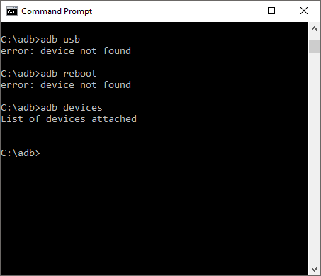

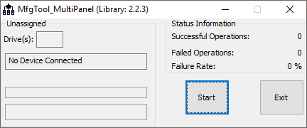

After the upgrade it's impossible to start my T76ML Carta+
Now my device doesn't work anymore, Windows 10 doesn't recognize it (no drivers?), so it's impossible to start the process with mfgtool2 tool (it says "No device Connected", when T76ML is in "download" mode).
I tried to install the ADB-tool, but it just says: 'device not found' with the adb command 'adb reboot':
C: \\ adb \\ adb> adb reboot
error: device not found
I don't know what to do now

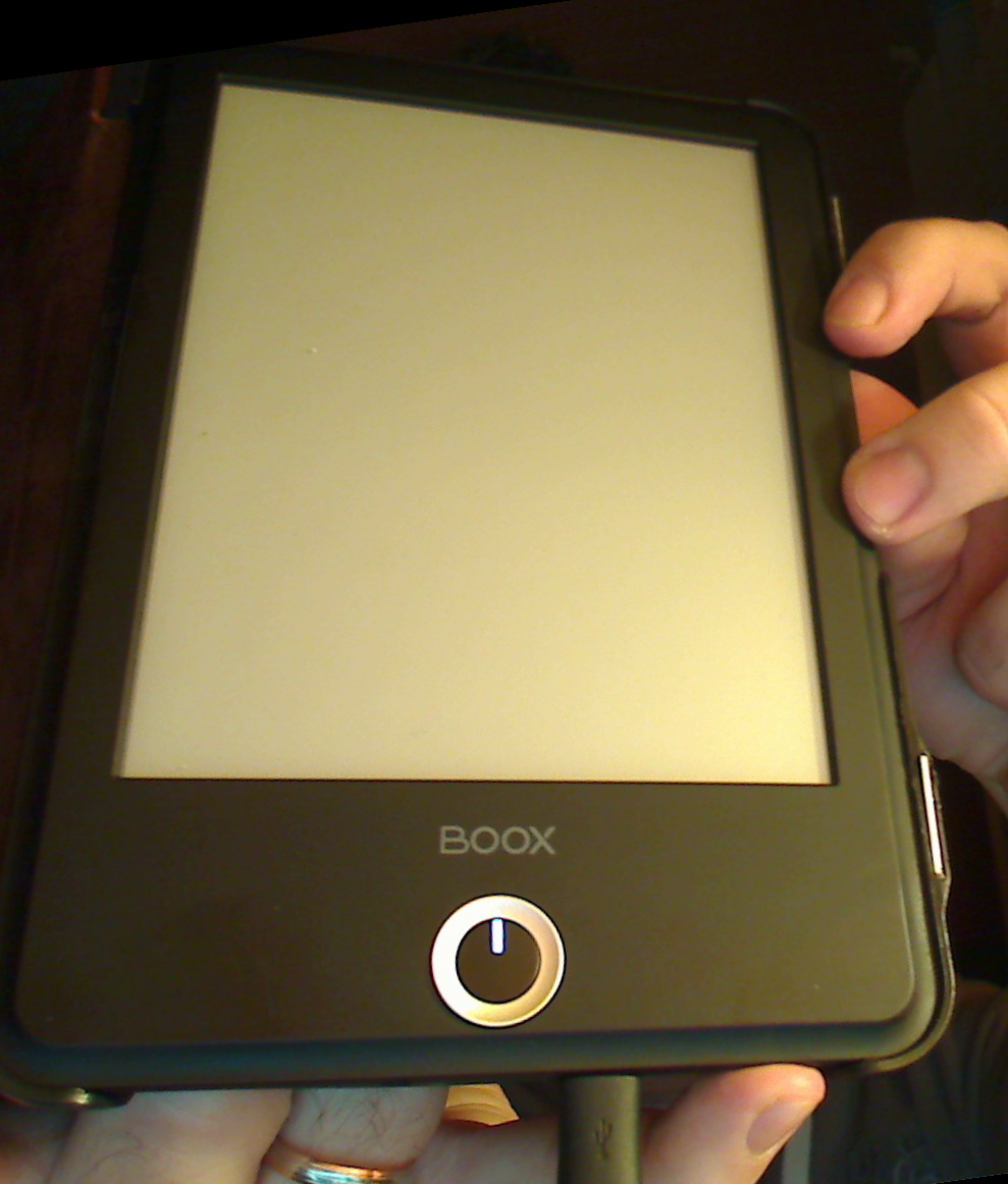

Old 10-22-2017, 08:52 AM   #5
Belgrc
Belgrc began at the beginning.
Posts: 8
Join Date: Oct 2017
Device: ONYX BOOX T76ML Carta+
"Just re-boot your device in this mode using a special buttons combination: Press PgDn (<) + PgUp (>) + power button for 3-4 seconds."
This step is made
To upgrade, you must connect
What do I need to see the book

The `adb` will not find your device - that is Android level, only after Android booted.
You need to start the device to the bootloader («Press PgDn (<) + PgUp (>) + power button for 3-4 seconds»).
Connect it to Windows through the USB cable - Windows should recognize it, MfgTool should see it.

Once strted in download mode, try to connect your Boox to different USB ports on your PC. I experienced similar troubles with USB 3.1 from time to time.
I connected Boox to different USB ports and different PC. no difference.
1. reaction Boox - indicator lights
2. reaction Windows - without reactions (no device)
