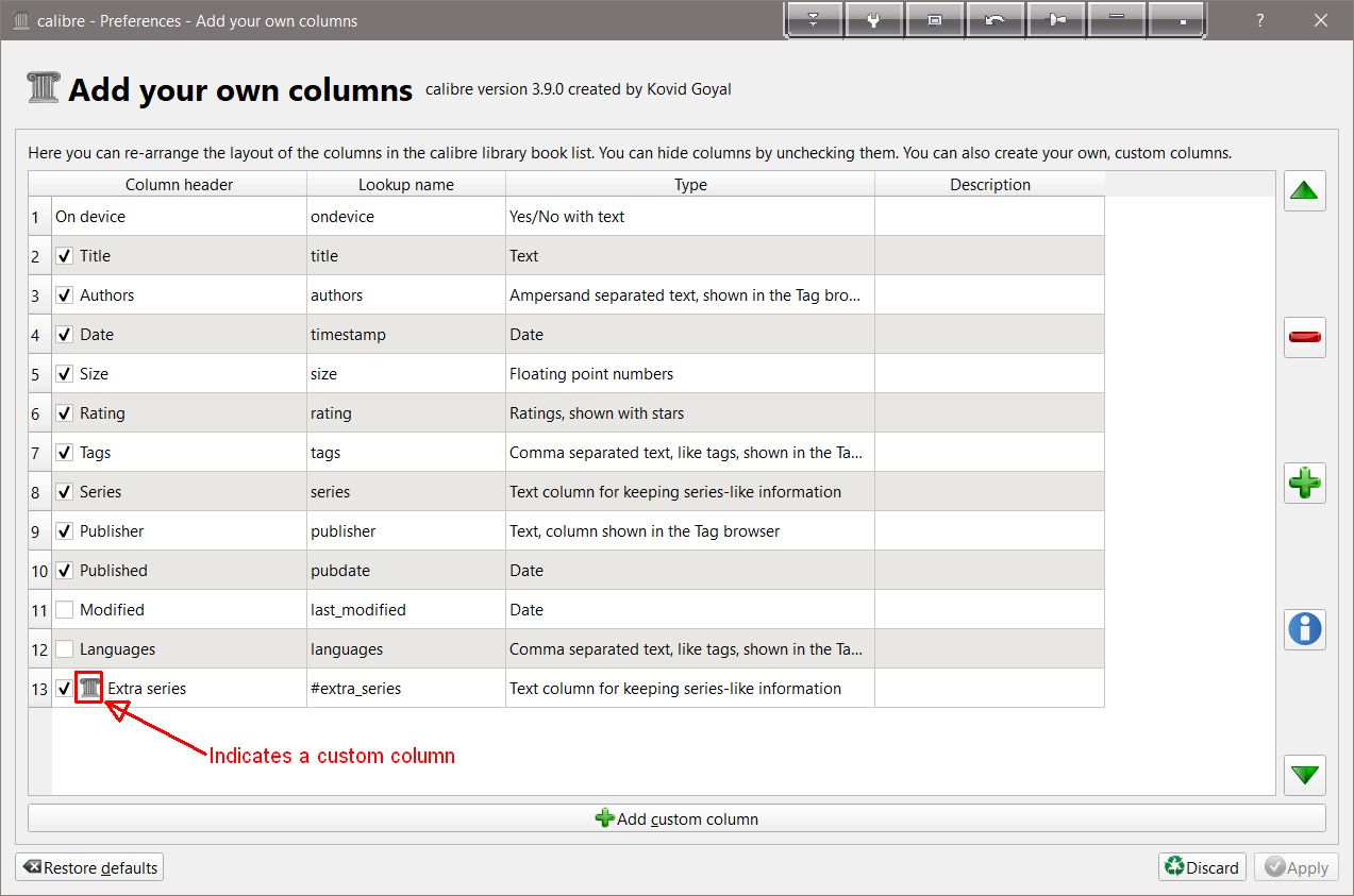

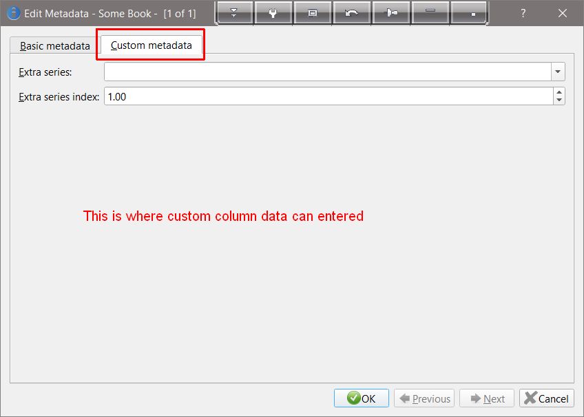

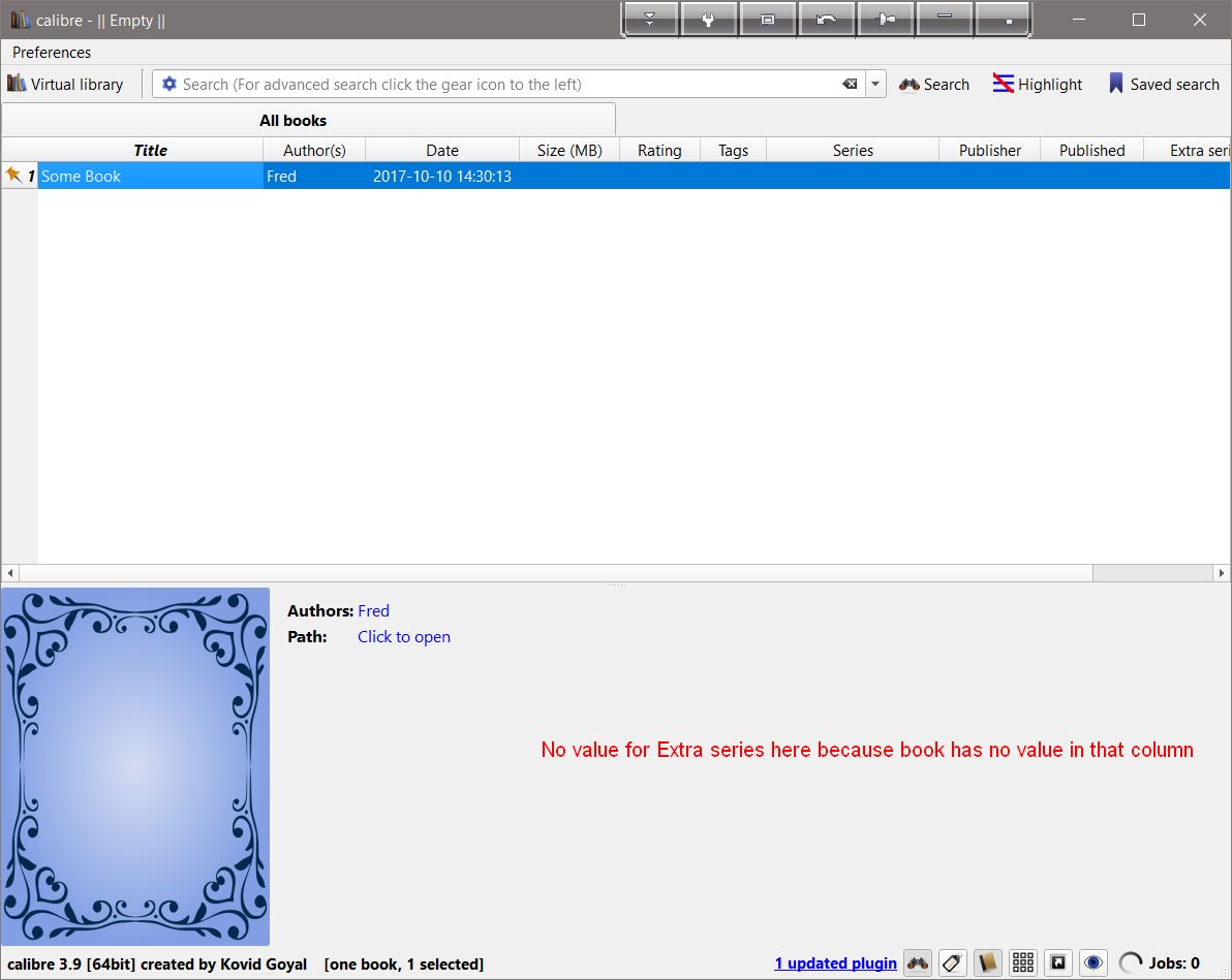

Read Status is not a standard column.
Some book you 'borrowed' must have had that defined and you authorized the addition (Calibre asks: do you want to add) to you Library.
Preference: Add your own columns will tell you more. Selecting the column name and clicking the edit (pencil n paper) icon, will tell even more

Sorry, "Read status" is NOT a standard column in calibre. How the custom column was created in your library, I don't know. Most custom columns are created by the user, but, they can be created in the method that theducks mentioned. Some plugins will create columns, but I don't know of one that will create a "Read status" column.

AFAIK Calibre Companion is the only APP that can update Date Read ot 'Read' (a T/F field). Both are custom columns, BOTH had to also be configured matched) in CC.
look at my join date, look at yours... While I do occasional make errors, others with similar experience are know to smack me up the side.
There are 3 ways a custom column can appear:
1) You created it from scratch
2) You 'inherited' the Library (or structure) from a 3rd party
3) You added a book (Copy to Library) from another Library
I Know from use that #3 asks for permission to Include the field if it does not exist.

Au contraire - it is you that is incorrect, look at the post counts of previous posters.

You might want to bookmark this ==>> calibre User Manual
And spend some time watching these ==>> Video Tutorials
Added : Where did you get calibre? If not from here ==>> calibre - Download calibre, then you may have a 'bespoke' fork of calibre.
