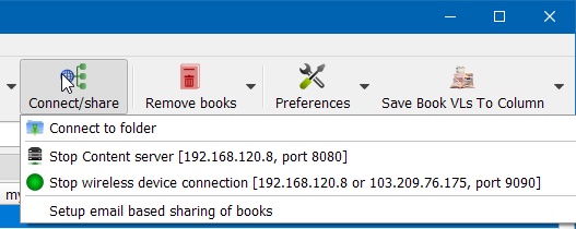

  1. FAQ step "Connecting for the first time": post a screen capture of the calibre Connect/Share options so we can be sure that both the wireless device and the content server have been turned on and that the ports are not the same.

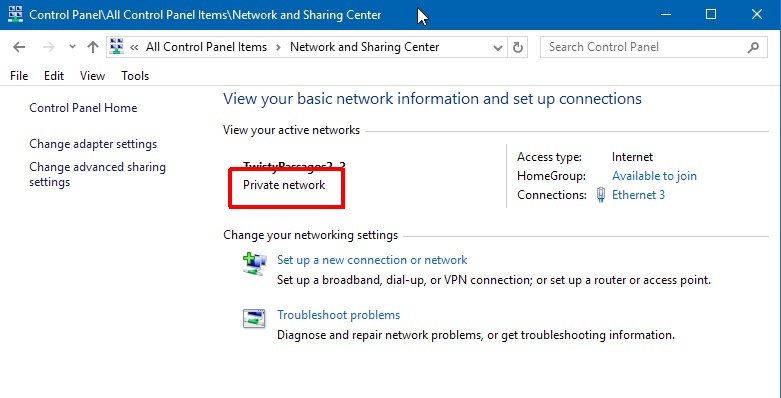

  2. FAQ step 1.1: Post a screen capture of your Windows 10 network settings "Network and Sharing Center" so we can verify that you are using a private network.

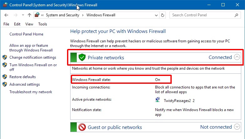

  3. FAQ step 2.1: Post a screen capture of your Windows 10 firewall settings main screen so we can verify that the windows firewall is on.

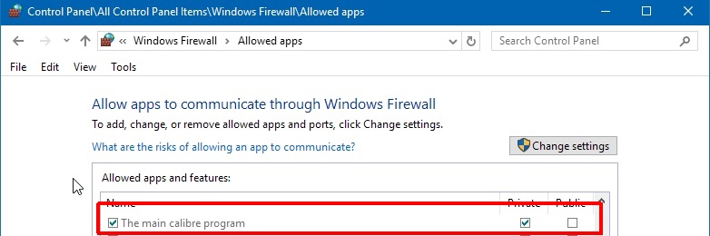

  4. Post a screen capture of the firewall rules showing that calibre is allowed through the firewall.
    Attachment 159371
    Attachment 159368
    Attachment 159369
    Attachment 159370

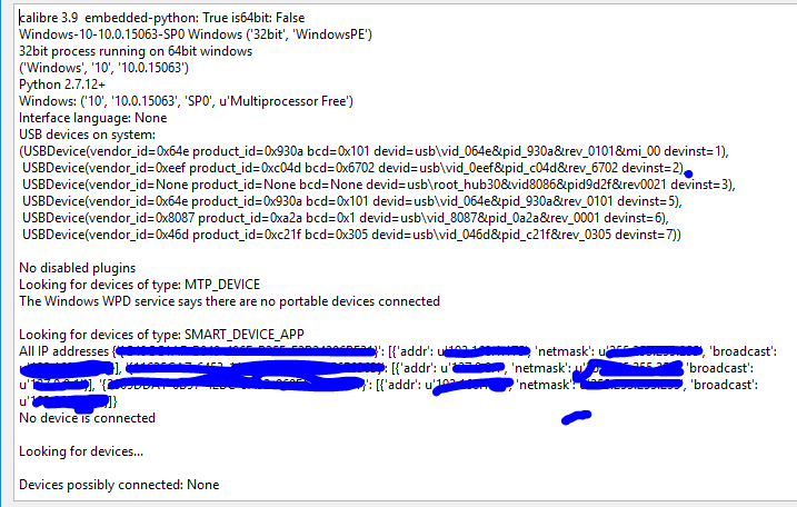

Debug device report, while its connected to the content server and unable to connect wireless

  • You supplied a calibre device detection log. What I asked for was a calibre debug log. A debug log will tell if calibre is able to successfully listen on the specified connection port, indicate whether or not calibre "hears" CC's "are you there" broadcasts, and show if incoming connections arrive but are not serviced by calibre.
