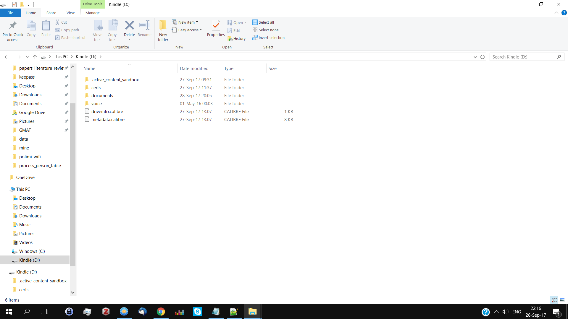

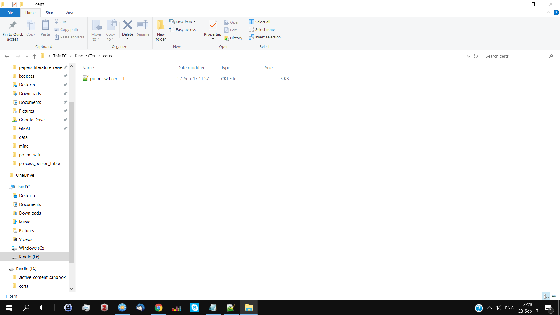

Can you give a screenshot of the folders and files on the kindle, to help understand if there may have been something set up wrong.

I attach the screenshots of the relevant part of Kindle drive folder structure
ID:	159212   Click image for larger version
