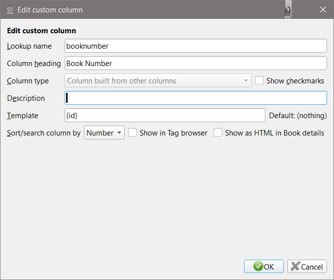

Is there anyway to decipher what books have been downloaded via the content server? I'm pretty sure the book id is there, but how can I find out what book that is in my calibre library? Is it possible to display the id in an added column, or to be able to search for a specific id?

Create a custom column for book number, viz:

no need for a custom column
search:
id:=<the id #>

Thanks, theducks -- This is a much simpler solution as my "Edit Custom Column" option does not look like the jpg above. I don't have the "template" line nor the one under it. However would like to have a column if I could make it work.

Template does not appear, because you did not first set Column from other columns. Templates reference columns. The dialog is context aware (changes to fit the situation)

My custom column can be shown in the book list and used in a search term. AFAIK the 'id' column cannot otherwise be displayed in the book list. And with my lookup/Header names it less likely to be confused with the 'Ids' column.
