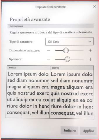

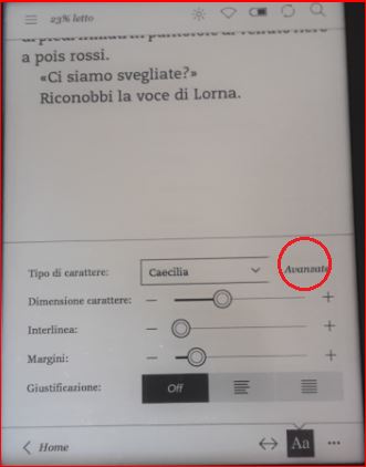

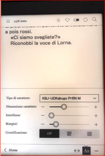

Hi to all,
I have just bought a KOBO AURA 2nd edition ereader.
Everythig is fine, but I noticed that for 2 fonts (KBJ-TsukuMin Pr6N RB and KBJ-UDKakugo Pr6N M) the choice of 'advanced properties' is NOT available, while for all other fonts this choice exists.
This choice is useful in order to increase or decrease the contrast.
Is this correct or do you think that it is a KOBO bug?
Thank you!
Beniamina

Advanced font controls only works for truetype fonts. Maybe those two fonts are opentype.

This is correct. Tsukushi Mincho and Kakugo are both Japanese fonts and those fonts aren't allowed to have their weightings changed. Not even using a patch to enable advanced font control on other fonts allows it.

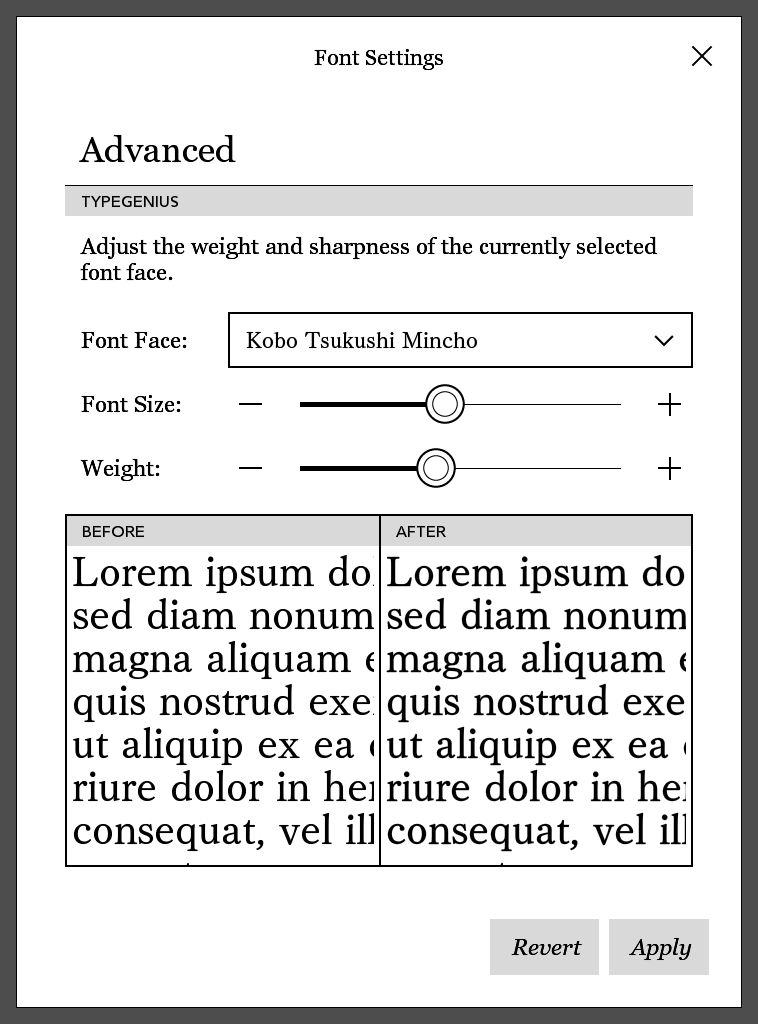

Those two fonts have the advanced font controls available on my Glo with firmware 4.5.9587, in both ePub and KePub books. However I have patched the firmware with the `Freedom to advanced fonts control` patch, and I didn't check if it worked without the patch.
Edit: These are built-in fonts, they come with the firmware and are in TTF format. There is something strange about the font name displayed on your Aura 2, could it be you have sideloaded a different version of these fonts? In that case the advanced font controls won't work unless the firmware is patched.

It's just because they have it set to Italian. You see the same names if you set it to Italian or Spanish.
It doesn't work without the patch because I don't have the patch either. Didn't you say in one of your "Freedom to advanced fonts control" notes it doesn't work for Japanese fonts anymore? Or does that no longer hold true?

The patch should work with any TTF font, but there might be side effects if the language is set to Japanese on the device or in the book. (I don't know exactly what the side effects are though, since I never read in Japanese, it might just be something minor like which font is used by default.)
Edit: If Kobo have disabled the advanced font controls on the Kobo Tsukushi Mincho and Kobo UD Kakugo fonts there might be a reason for it. Those fonts are much larger than the others, I've had problems with the device running out of memory when using them, and it might be that the advanced settings cause them to use even more memory. I'd avoid using either of those two fonts unless reading in a CJK language that actually needs them.
