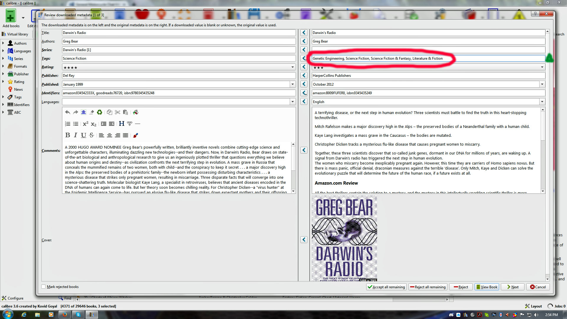

Ok I feel like I'm probably missing something glaringly obvious here, but I cannot find a way to accept downloaded metadata after reviewing it?
I have Calibre 3.6 on Windows 7, I am trying to use the Bulk Meta Data Download Tool, I select metadata only, then once the job has finished I choose to review the metadata. All that is great, but now it all falls apart.
There is no "Accept" buttton? is there meant to be? At the moment I hit next which I am presuming is accept? At the finish of the books it says "updating metadata", but nothing changes?
I have tried using the Accept All Remaining button too, but the dialogue box closes and a message says updating metadata but once again, nothing changes??
What does the Accept ALL Remaining button do? I mean why would you click it if you haven't even seen the rest of the books yet?
S/S attached in case I'm missing any buttons? like back, or accept?

@Trevor68 - I don't use it much, but my memory is that have to use the blue arrows in the middle to cherry-pick the values you want and click Next. Can't recall ever using the select all.
Old 08-25-2017, 12:31 AM   #4
Posts: 45,706
Karma: 28549304
In your screenshot, there is nothing to change, since the downloaded metadata, which is on the left, is a subset of the existing metadata.

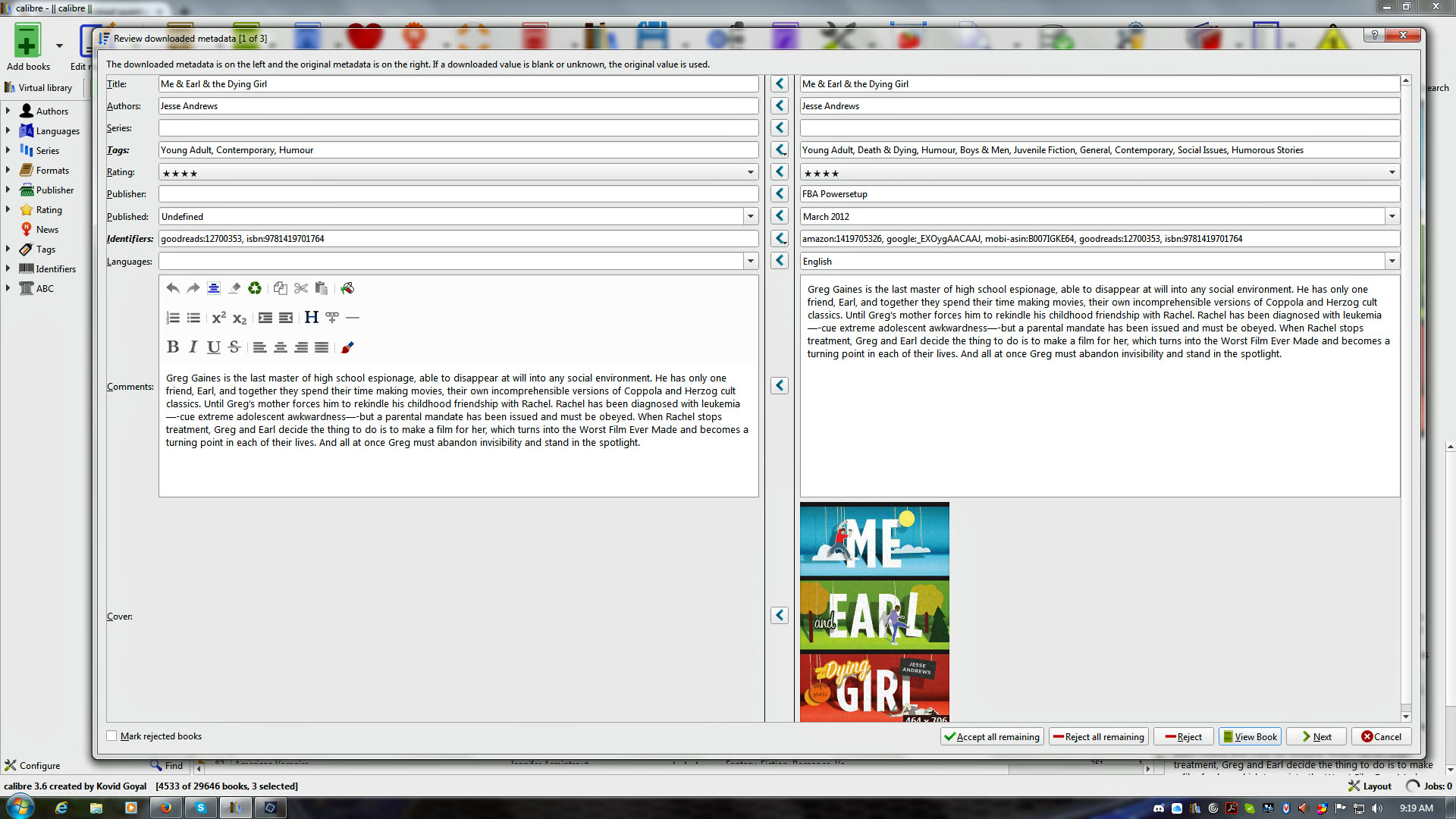

So in this screenshot, I cannot edit the original tags circled, and I wanted the book to update as only Science Fiction just like on the left, not ADD Science Fiction to the existing tags.
If this can't be done that's fine, I'll go back to doing them individually.

If the Left side is occupied, the Right does not auto-fill the Left. That only happens if the Left is blank. You use the arrows to force update the left.
You can also TYPE into the Left
