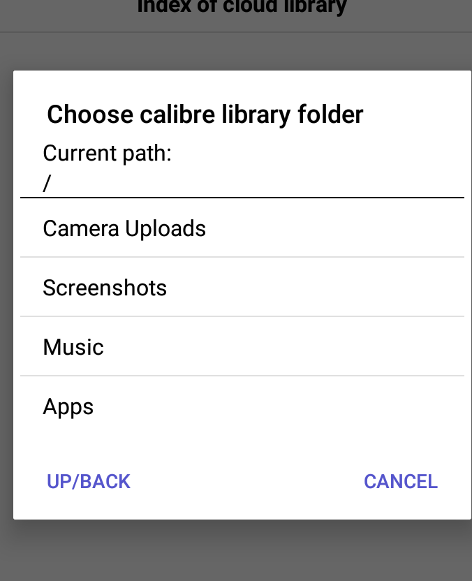

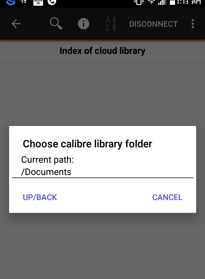

Every time I try to connect my companion to Dropbox, I get this weird popup that won't let me stick to one folder and continue.

I need more information. Did you see the left-most dialog first? Did you scroll it to see "Documents" then tap on "Documents"? If so, is there anything in "Documents"? Said another way, what did you actually do?
Another question: is there really a full copy of calibre library somewhere in Dropbox? A folder that contains calibre's metadata.db file?

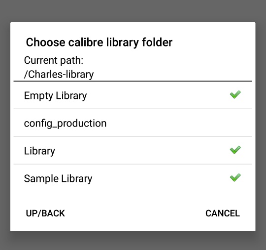

If you put your calibre library folder onto Dropbox (the folder containing the file "metadata.db") and if Dropbox has finished syncing that folder to the cloud, then you should see something like this.

Note the green arrows. They indicate that the folder contains a calibre library. If you are not seeing such arrows then there is no file "metadata.db" in the folder.
Edit: If there is a green arrow on a line then tapping on that line will select that library.

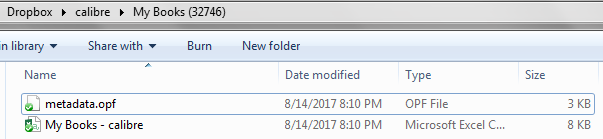

I'm still getting the same up/back or cancel options and yet the file is clearly in the folder I selected. >.<
That file is metadata.opf. The file you are looking for is metadata.db.

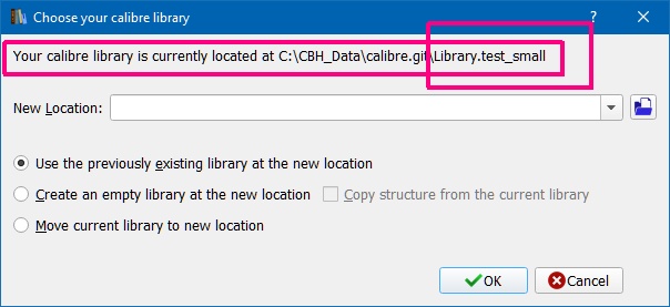

  2. In calibre, click on the library icon on the tool bar.
  3. Click on Switch/create library. You should see something like the following screen capture. Make a note of the path to the library, found in the outlined section of that dialog.

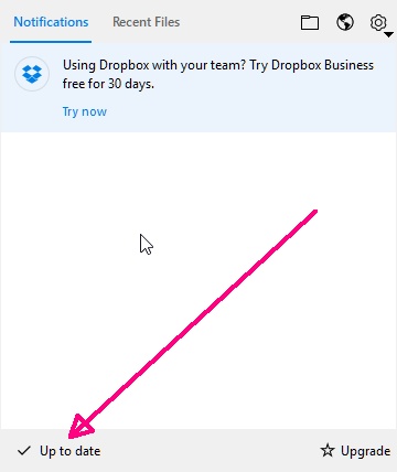

  9. Wait for Dropbox to sync completely. How you know it is finished depends on your operating system. Sometimes Dropbox shows icons on the file and folder names. Alternatively you can open the Dropbox app (on Windows from the system tray) and check the sync status as shown in the following image.
