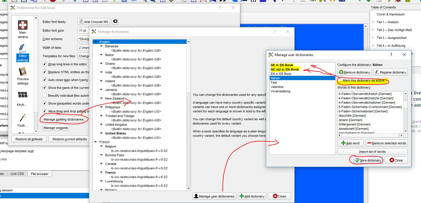

There are different scenarios:
Sometimes you have books with explicit defined languages for a word, a paragraph, a file or book wide.
You can add a additional language to the spellchecker. These will be used for all explicit signalized words, paragraphs and so on (e.g. like in your exampe).
Usually there is only one language defined in a book. For this cases I use user defined dictionaries (mostly two: one for foreign language words and one for special word constructs used in the actual book). The user defined dictionaries can set to an active / non active status so that you have all freedom to use is like you want.
The only thing what is missing is the possibility to deactivate one of the main dictionary in case you use more then one dictionary. I thought this was implemented years ago when the spellchecker was implemented but I can't find it again, maybe I remember wrong and had only ask for it
For this I use a little trick to work first with the foreign language as false positive and copy all correct identified words in a new user dictionary for a foreign language and switch then back to to major language including the new user dictionary as additional dictionary.
Take a look to the section Import word lists. This is very helpful to manage huge word lists. It have the possibility to add a language identifier to a list or a word too. You can copy containing words of a user dictionary to clipboard to create your own sets of useful combinations

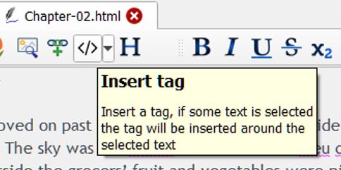

<p>I lived in the seventeenth <span lang="fr">arrondissement</span>. The modernization project that had swept up the<span lang="fr"> Avenue Neuilly</span> and was extending the smart side of Paris to the west had by-passed the dingy <span lang="fr">Quartier des Ternes</span>. I walked as far as the <span lang="fr">Avenue de la Grande Armee</span>. The Arc was astraddle the <span lang="fr">Etoile</span> and the traffic was desperate to get there. Thousands of red lights twinkled like bloodshot stars in the warm mist of the exhaust fumes. It was a fine Paris evening, Gauloises and garlic sat lightly on the air, ...</p>
but lot of manual effort, and I'm not up to writing my own search/replace RE function
For a few foreign words, I could use [Insert Tag]
Side note about possible User Manual problem with [Insert Tag]
https://manual.calibre-ebook.com/edit.html
I created a <span lang="fr"> tag, but it took a while to remember how I had created the tags I currently have. There doesn't seem to be any information in the link about creating / inserting a tag.
Just type it - tags are just text. The editor will automatically insert the close tag for you as soon as you type the open tag.
I find it easier to selected the foreign text and then just click [Insert Tag] to bracket the text with <span lang="fr"> ..... </span>

@phossler: Not sure what you mean. You just lick the insert tag button and it asks you to input the tag you want. I dont know how it could be more straightforward than that.

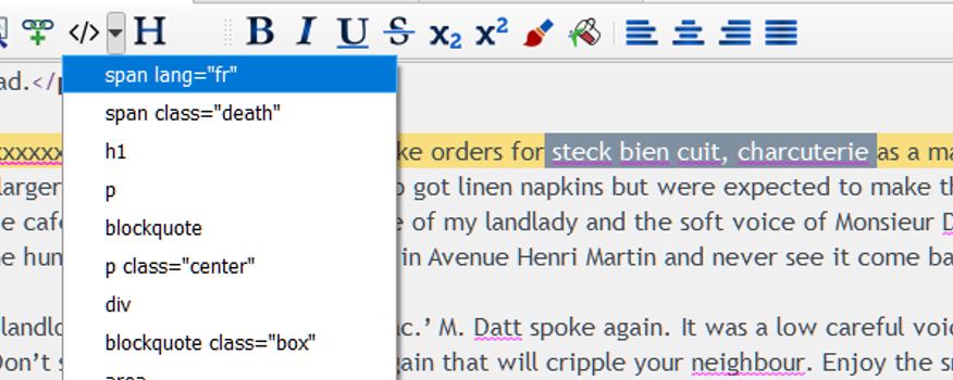

Old 08-07-2017, 07:19 PM   #10
phossler
Posts: 1,094
Karma: 447222
Device: Kindle Paperwhite
Yes, the whole process is very easy to pick a tag and then insert it around the around selected text (attachment)
When I said
Also, I've found that the editor will only complete the closing tag when I type </
I was referring to manually inserting a tag that Calibre auto-closes for me when I tell it where the scope ends
e.g. After I insert the <b> ....
text text text <b> text text text text text text
.... when I add the 'closing tag' start characters </ ....
text text text <b> text text text text text text</
.... Calibre auto completes it for me
text text text <b> text text text text text text</b>
All very nice and user friendly
