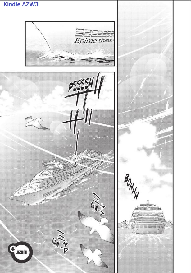

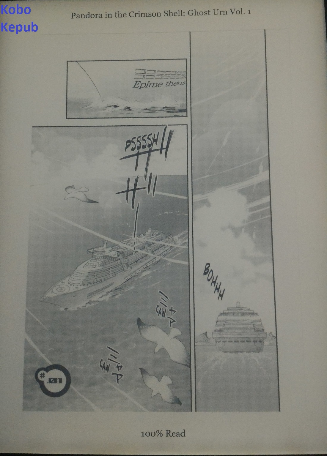

I have made several attempts to convert a kindle manga to kepub for my Kobo Aura One with limited success.
The constant problem I keep running into after the kepub conversion are:
  • Smaller image size (The panel should fill the entire screen).
  • Header and Footer keeps showing up on each page.
So what I need is:
  • Comic panel should fill up the entire screen.
  • The removal of the header and footer.
I have attached screenshots of what Kindle and Kobo conversions.
I would appreciate any help to solve my issue.

Sorry, the things you are having problems with are inherent in the kepub format. The header and footers are part of the design of the kepub renderer on the device. Hence the space for the page is smaller and the image is smaller.
But, there is a unsupported fullscreen mode. Add the following lines to the "Kobo eReader.conf" file:
[FeatureSettings]
FullScreenReading=true
There are problems with this mode, but I don't know how they will affect an image only kepub.
Is there any reason not to use CBR or CBZ? The Kobo devices support both formats including zoom on and rotate on the images.

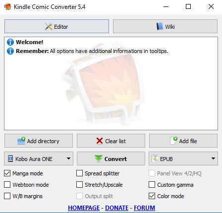

I was able to figure out how to get full screen mode in this two step process.
I don't know if there is an easier way.
Step 1: Covert the AZW3 to zip or PDF
Convert AZW3 to ZIP (all images will be extracted)
  1. In Calibre, choose Convert Books > Convert Individually option.
  2. Choose the output file as ZIP.
  3. Convert to ZIP.
  4. Unzip the ZIP file.
  5. Go to ZIP file folder > nyyekl_files
  6. Copy the cover.jpeg.
  7. Go to go nyyekl_files > images
  8. Copy the cover jpeg image.
or
Convert AZW3 to PDF
  1. In Calibre, Convert Books > Convert Individually option.
  2. Choose the output file as PDF.
  3. PDF output:
    • Check use the paper size as output file (make sure paper size is letter).
    • All page margins (left, right, top and bottom) is set to zero.
    • Convert to PDF.
Step 2: Use Kindle Comic Converter
  1. Download and install Kindle Comic Converter (https://kcc.iosphe.re/).
  2. Open Kindle Comic Converter.
  3. Choose manga mode.
  4. Choose colour mode as optional.
  5. Choose ereader (Aura One).
  6. For zip conversion, choose add directory and point to the directory where the images are.
  7. For pdf conversion, choose add file and point to the directory where the PDF is.
  8. Choose convert.

@davidfor - I understand your point of view. KCC is definitely not very convenient tool if you have multiple devices.
Issues you describing are caused by different approach used by KCC. You say that you want to let e-reader handle images and KCC was designed to do something exactly opposite.
For long time letting Kindle mess with images was best way to just annihilate any scraps of quality. Even now some official manga releases have quality problems because they are created to support multiple devices.
And if we talking about EPUB code itself. It is single template that support Kindle, Kobo and other EPUB e-readers at once. It might not be very clean, it have some workarounds but it is fully valid EPUB 3.0.1 and most importantly - it works :-)
