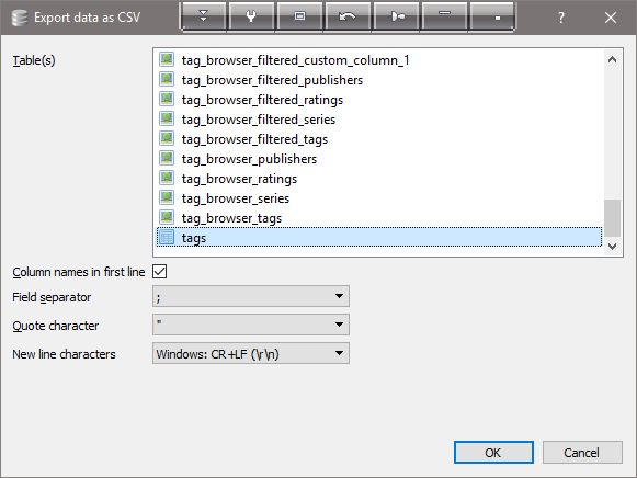

The export/import feature has a very specific purpose - to facilitate moving all calibre data (config and libraries) from one computer to another.
Getting a CSV for a table from DB Browser for SQLLite or SQLite Expert is pretty simple and I'm sure the same would be true for SQLite Spy. And most importantly the names calibre uses for tables etc are easy to comprehend (e.g. authors, books, tags etc).
FX to get a CSV of Tags from DB Browser for SQLLite, Open a metadata.db file in a calibre library folder, and then use File->Export->Table(s) as CSV :

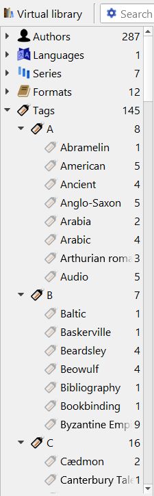

Actually, I found an alternative way to more easily review tags for later editing or removal using the Tag Browser. (For me, safer also). In the extreme left-hand column (just under the Virtual Libraries button) are listed a number of aspects regarding the entire collection - one of the entries is Tags. If one right clicks on the Tag category and then chooses the Expand All Children option an alphabetical listing of all tags appear that can be repeatedly scrolled up or down for review.
Mark Lee
